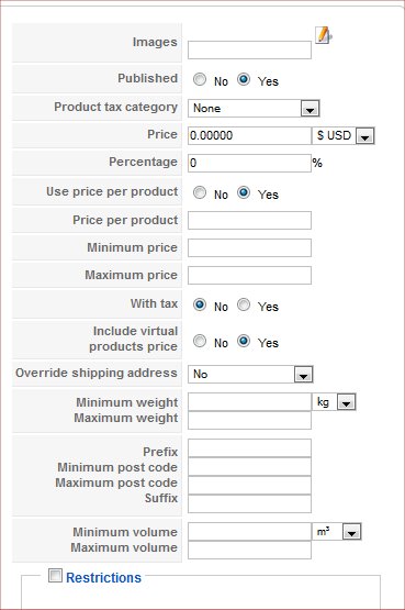

  • Posts: 3
13 years 2 months ago #109445
I still have problems.
I set the one shipping method as shown in the attached.
I added the shipping for the products.
If I add a shipping amount for tickets then it adds shipping for each ticket.
If I add a global shipping to the shipping method, then it adds that even on products that have a product shipping.
I don't see a global vs product setting happening, it seems like it is adding them together no matter what.
