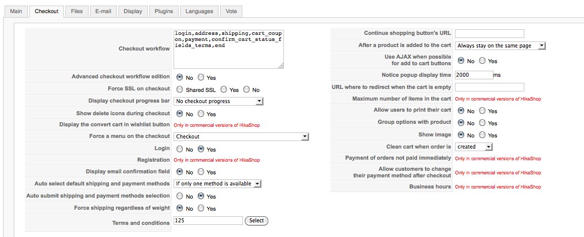

I'm having an issue with coupons. The coupon is simply not processed, the site is not responding, independent if the coupon code is existing or not.
On the other questions about coupons here in the forum I didn't find a solution.
What could be the reason?
Here is the shop: www.filicaja.it/index.php/en/filicajas-webshop/product/listing
Joomla cache is disabled.
Here the screenshot of the chechout config.
Thanks,
Julia

when I enter a coupon code at the respective checkout step it happens nothing. Independent if the coupon is existing or not.

The problem was coming from how you configured you checkout workflow through "Hikashop->System->Configuration->Checkout", now it's working fine.

I'm trying to understand the issue: The critical point is the order of the different elements...? They have to be in a certain order (here: login_address_fields_shipping_status_payment_coupon_cart_confirm) to let it work..?
13 years 2 months ago #109211
Sure you can use it like this for example, then you'll have one action per step : login,address,fields,payment,status,coupon,shipping,cart_confirm,end
