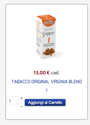

I've succesfully added the quentity field in list, but how I can center and put in another line the cart button?
See attached image: I need to center quantity field, and put after, down, the add to cart button
Thanks!

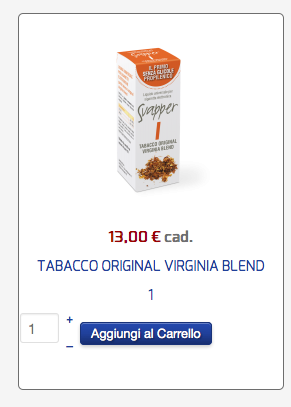

  • Posts: 46
13 years 2 months ago #109058
  • Posts: 86107
  • Thank you received: 14208
13 years 2 months ago #109079
It's indeed because of the CSS of your template.
You can counteract that by add that CSS:
.hikashop_product_quantity_field{ padding: 0 !important; }

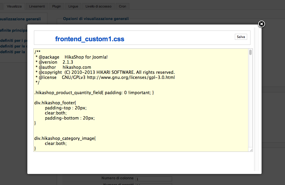

13 years 2 months ago #109093
Hello
I've supposed that and also already tried.
See attachment to check if I done it tight please.
  • Posts: 2334
  • Thank you received: 403
13 years 2 months ago #109103
You should put it at the end of the file and make sure you saved the configuration with this file selected.

13 years 2 months ago #109127
I can see that the file used on your website is frontend_custom.css while you're editing the file frontend_custom1.css
So you didn't select the correct CSS file in the configuration and saved it.

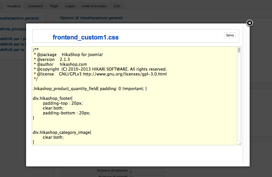

  • Posts: 46
13 years 2 months ago #109142
No! I've changed it, but I have also modified it. I've simply tried another file.
The frontend_custom.css is modified.
  • Posts: 86107
13 years 2 months ago #109143
You didn't add the correct code.
I see that you added:
.hikashop_product_quantity_field{ padding: 110 !important; }
