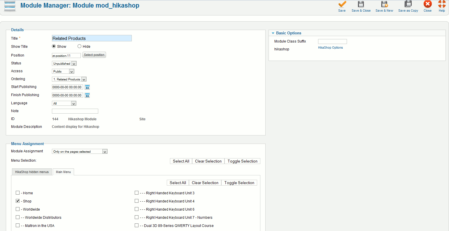

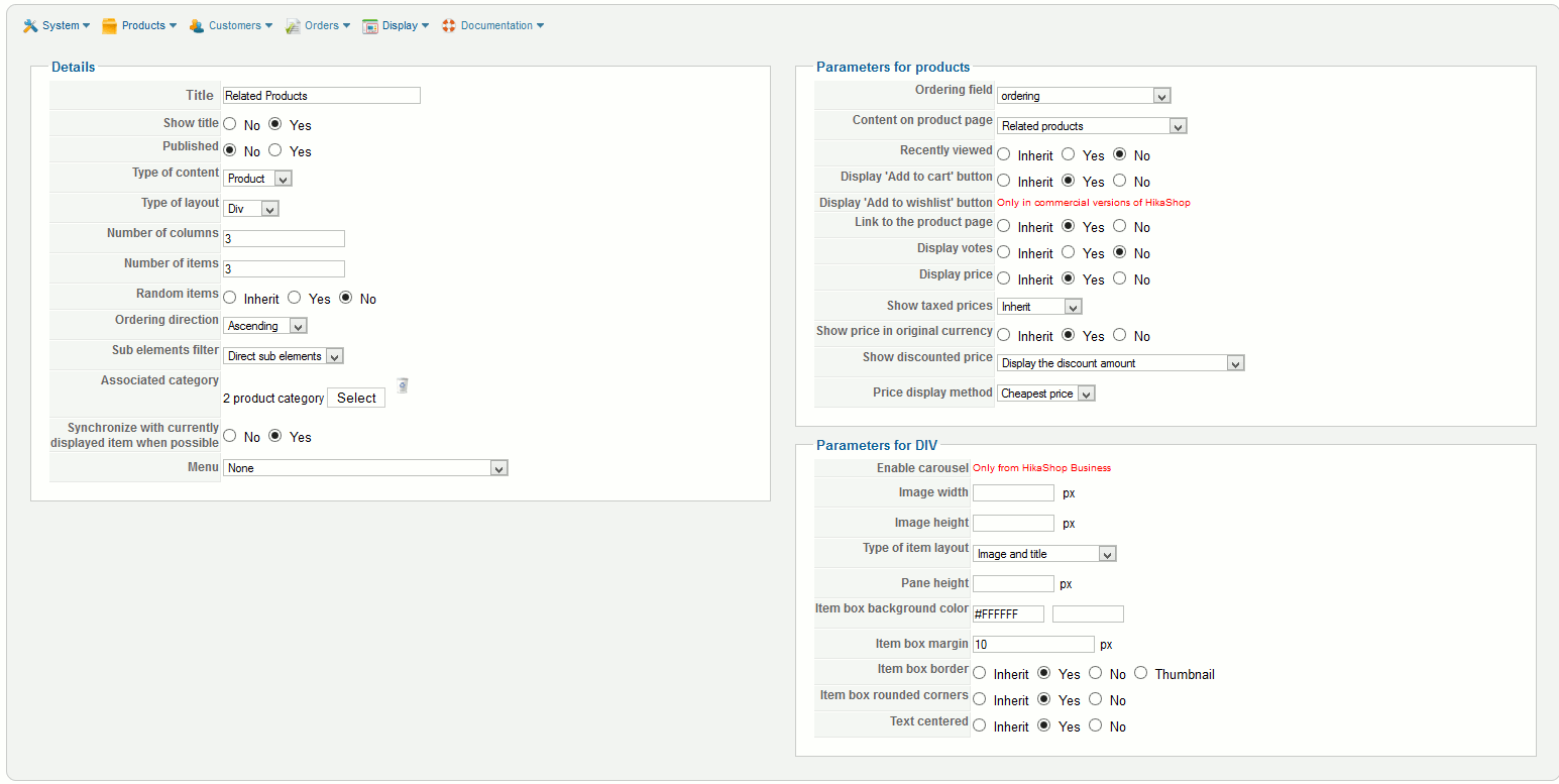

I'm trying to display related products. I have followed the procedure at
www.hikashop.com/fr/support/67-hikashop-...ont-end.html#related
but related products still do not display.
I've attached some config screenshots. Please can anyone suggest what could be wrong or if there's anything I can check?

13 years 2 months ago #110719
Hi Mohamed,
Thank you for your reply. Yes, it is a valid module position. Also I did follow the step shown (please see screenshots).
Is there anything else I can check?
Mark
13 years 2 months ago #110751
As I can see in the second screenshot, the plugin "Related products" is unpublished.

Hi , thanks for your reply.
I didn't publish the module as it says not to publish it in the procedure www.hikashop.com/support/documentation/i...ct-form.html#related :-
How to display your related products below your products:
1. Create a new module of the type "HikaShop content module" via the joomla modules manager and leave it unpublished in the joomla options of the module.
Even if I do publish the module, it still does not display. I have tried different template module positions.
Please can you suggest anything else I can try?

As the documentation says and as Mohamed told you, in the configuration of HikaShop, click on the "Select" button of the "Modules under the product page" option. Set your related module to published and click on OK. Then, save the configuration.
You didn't provide any screenshot of the configuration showing that you had added the related products module to the "Modules under the product page" option of the configuration.
I suppose that it's probably what you're missing.

13 years 2 months ago #111225
Can you give us a screenshot of the "Related products" module configuration (HikaShop and Joomla configuration) ?
And too a screenshot of a product with related products (backend, product edition page) ?
