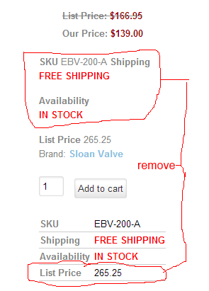

I would like to display pricing for an item as in this example:
Can this be done?
Thanks...

having trouble finding the right lines of code to move---
