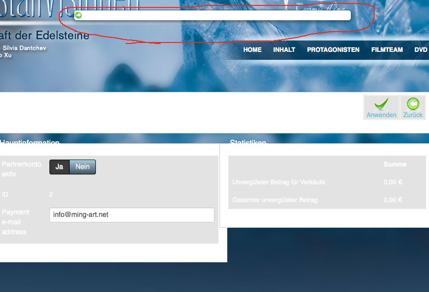

After test-login using the affiliate-program menu button, I only get to a messed up page with basic information. The messiness is probably just CSS, but one button is hovering above the site and there is no spot where the partner-affiliate is shown in full, nor any banner-section, or proper stats-section. (image attatched)

That's a bug of your template CSS.
It has CSS to tranform all the elements with the class "modal" into a modal instead of only the divs with the class modal.
Edit the CSS of your template, and change the .modal definition to div.modal and that will fix the problem.

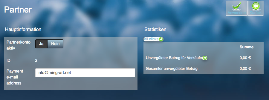

I have done the instructions in the documentation and followed it step by step, but there is just no affiliate-dashboard. I created the menu-item "Hikashop->affiliate program"
When I login and click on it, I get to this page:
When I click "back" I get to the joomla/hika-dashboard, where I can change my profile and view my orders etc. but that is not the affiliate-dashboard. No link, no button no menu item that can get me to the affiliate-dashboard. No link, button or menu item that gets me to my affiliate link, banners etc.

The banners display automatically on the same page of that screenshot, below the information and statistics.
So it sounds like you didn't create yet any banners via the Affiliates->Banners menu of the backend.
