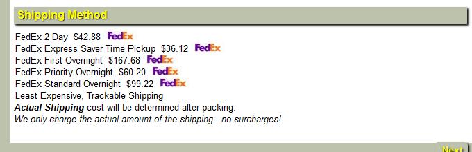

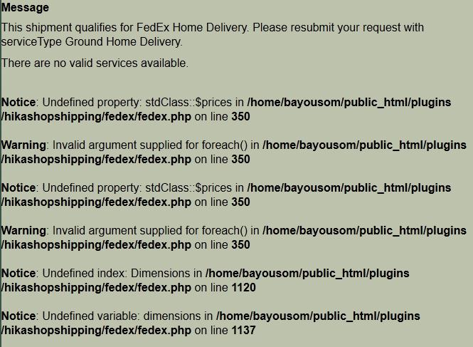

Here's the message from FedEx (and php warnings from the FedEx script):
And here's what the shipping area of the checkout looks like:

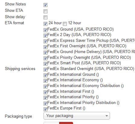

It shows pricing even though there isn't enough info about the shipment to calculate (no dimensions on the products yet). It also doesn't show FedEx ground or ground residence as options even though they are all selected in the config.

I just found where the problem is with the radio buttons. In the file frontend_default.css, it sets the radio button to display:none;
Sorry, I can't offer backend access to the site, but I appreciate the offer of help.
Sloan
