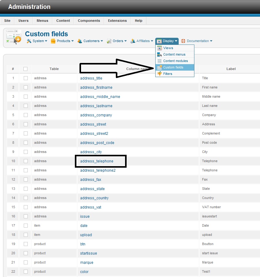

Hi there,
Just go in Display>Custom fields and find the address_telephone custom field.
Then uncheck the required option for this line and it's done :).

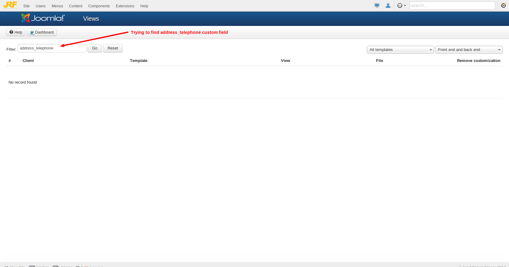

Thanks for your help. I cannot see the menu item "Display > Custom Fields". Please see the screenshot for what I see:

13 years 2 months ago #112966
I was talking about Hikashop menu :)
Display is between "affiliates" and "documentation"

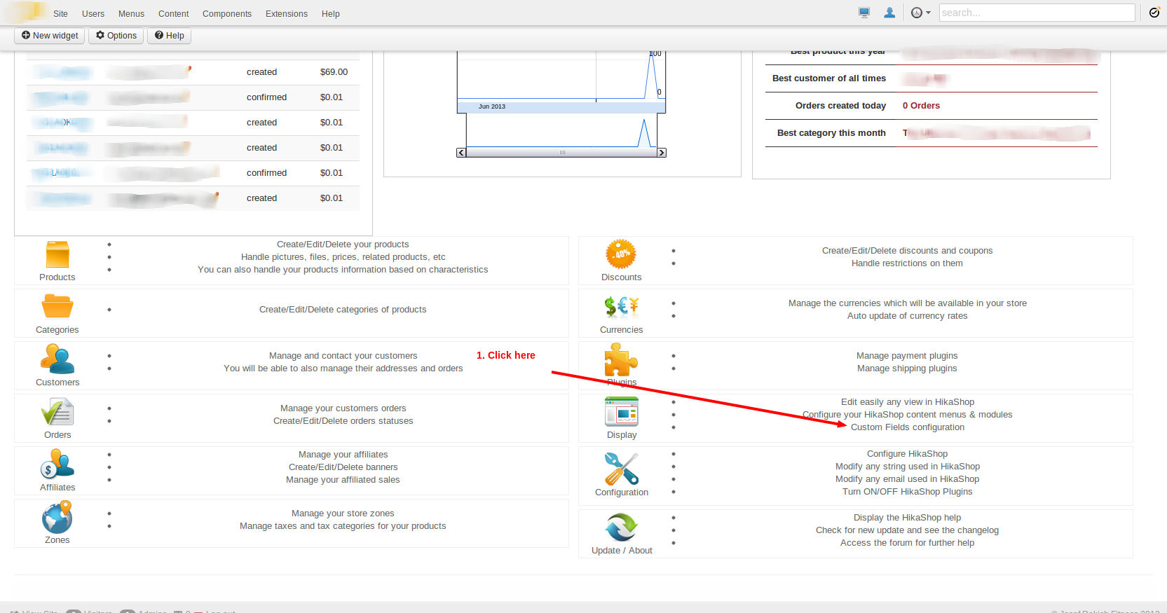

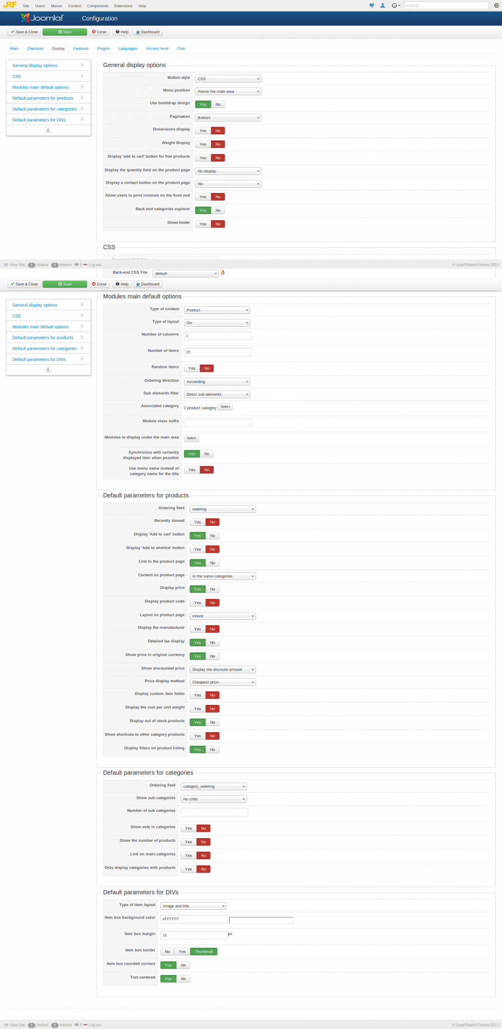

Thanks Eliot, I am still having trouble finding this. Please check the attached screenshots and give me further directions:

13 years 1 month ago #113311
Here it is!
Attachment not found
