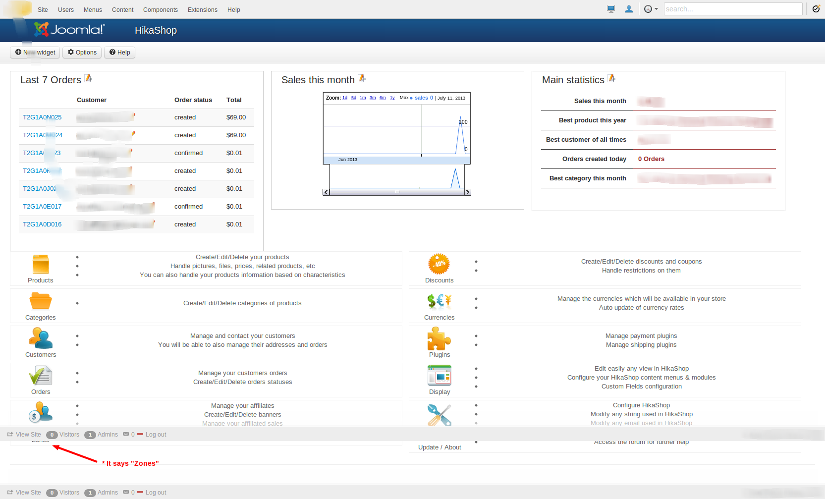

13 years 2 months ago #113292
I can't see this menu, please see the screenshot for what is visible in Joomla! 3.0 and Hikashop 2.1.0

13 years 1 month ago #113335
Can you scroll to the top of your page, and tell me if your have this toolbar :
If not can you change your back-end template and see if this toolbar is showing ?
Thanks.
  • Posts: 15
13 years 1 month ago #114003
Changed from Isis to Hathor and the layout broke! What template do we need to use to make Hikashop work properly? Please appreciate this is getting quite urgent now. Is there a support option where we can give you guys the login details and get you to make the change for us?
  • Posts: 86106
  • Thank you received: 14207
13 years 1 month ago #114008
HikaShop works with all the default backend templates of Joomla.
If you have an issue with a default template, it must be another extension that you installed which messes with the menus. So please deactivate it.

  • Posts: 15
13 years 1 month ago #114019
Thanks Nicolas, I have found the problem to be caused by JSN Power Admin. I have found the setting and it is working as requested. Thanks for your help.
