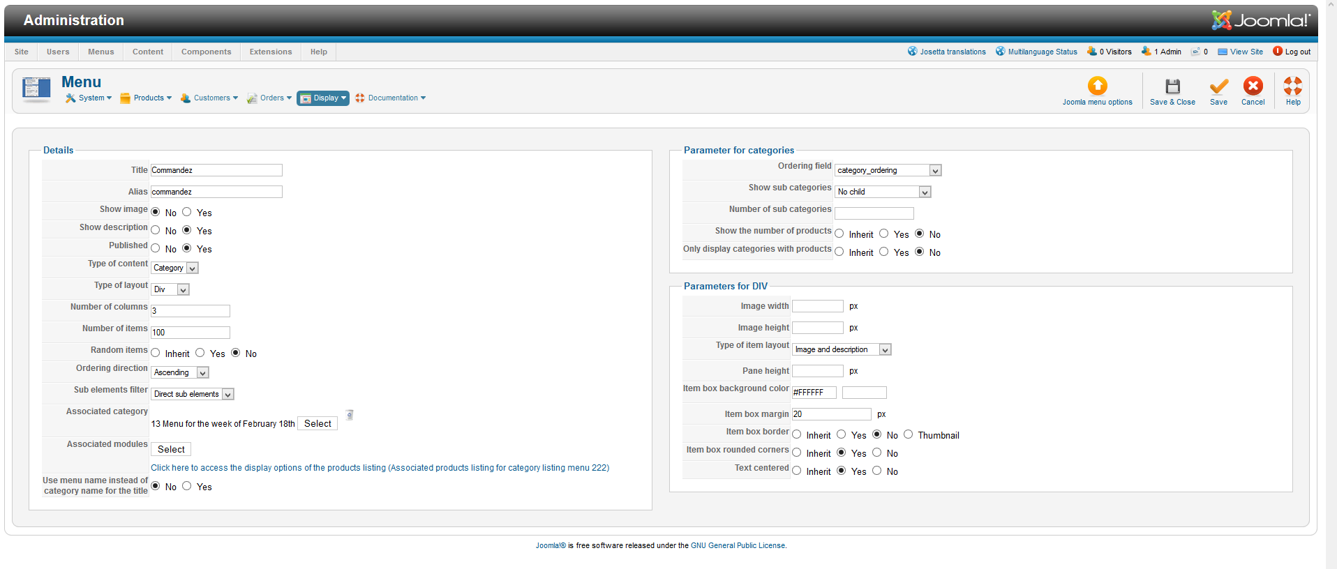

Here is my french menu item:

Your menu is a category listing menu. You have to check the configuration of the attached product listing module.
You can click on the link in the zone "associated modules".
The configuration that we want to check is here (in the module).

Ok, I think that you should just configured your french content module (with the ID number 195)like your english content module (with the ID number 191). For example you can set the Type of Item Layout of your French listing to "Image and Title".
