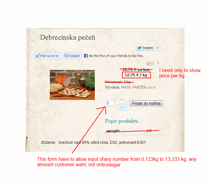

AD2. I did exactly what you recommend but the result is notwhat I need.
The eshop have to be able for selected products to get orders base on customers requirement of any weight, If he want 0,222kg he input this ammount, if customer wants 2,345kg provide thsi number and system will count price based on weight input, calculated using price per kg.
I attached screenshot.

13 years 2 months ago #113185 by Mohamed Thelji
1. Regarding the text that you want to hide, you'll be able to do that :
- By using some CSS code.
Or
- By editing your your listing_price file of your product view of your front-end template.
2. If you want your quantity input to allow decimal number, you'll have to do a lot of code customization and it would require some development knowledge.

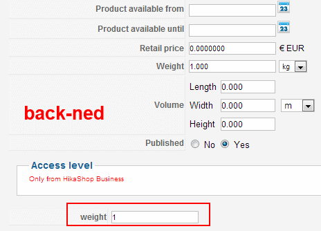

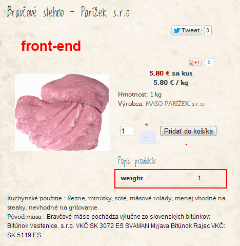

13 years 2 months ago #114192 by dkubik
I follow the instruction given by Nicolas "You can create a custom item field called "weight" via Display>custom fields and then install and publish that plugin and it should work automatically." and in front end i get one filed, as you can see on first attached screenshot called back-ned, when I provide the number in this field, in front-end it looks like on second screenshot called front-end
Is this what it should work like, or am I doing something wrong?

13 years 2 months ago #114249 by Xavier
Yes the custom fields work like that, you can hide it in frontend if you want.
Just toggle the button of frontend in the custom fields listing.

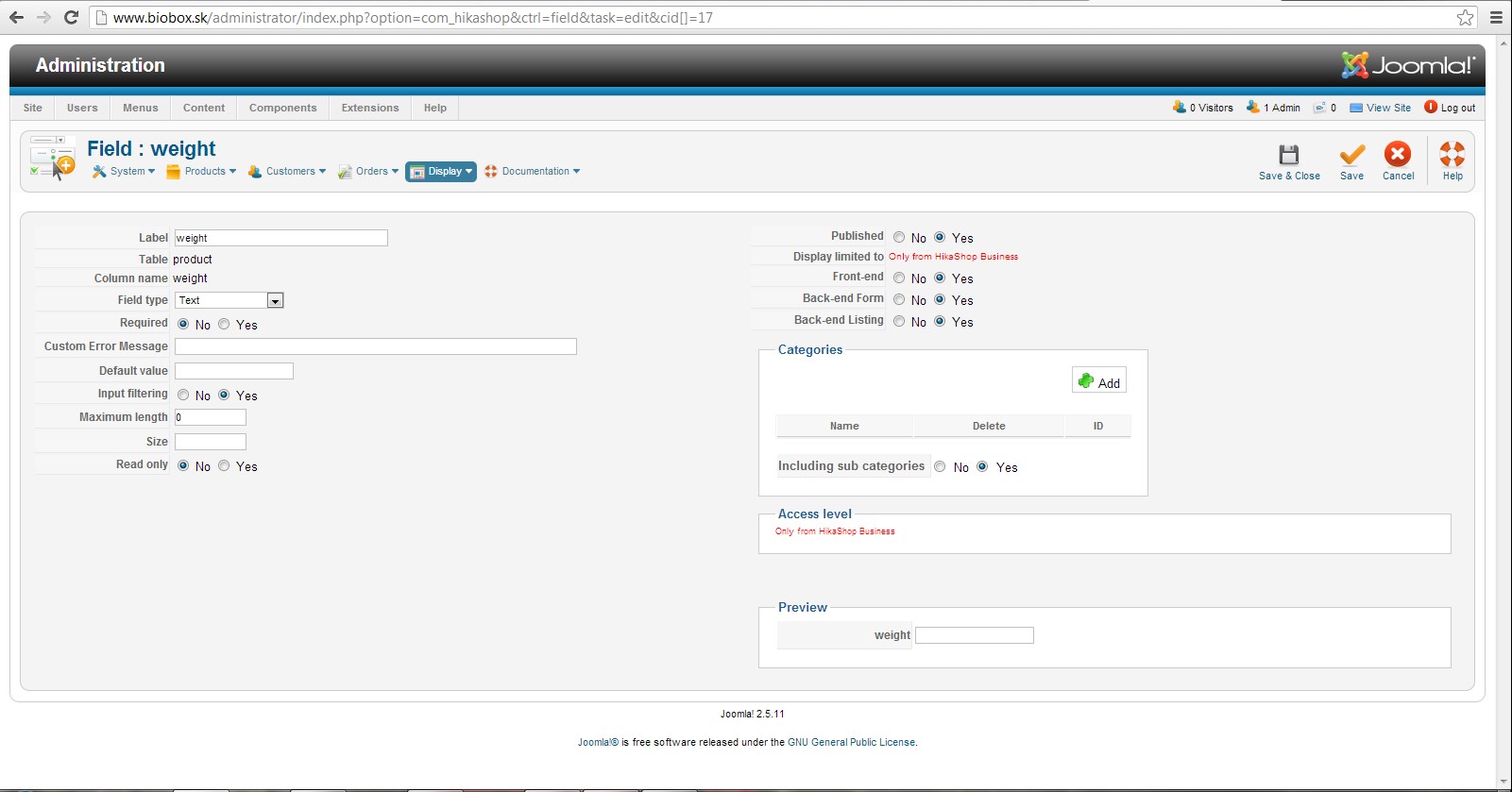

13 years 2 months ago #114283 by Mohamed Thelji
Can you show me how did you configured your "weight" custom field, trough "Hikashop->Display->Custom fields" ?

13 years 2 months ago #114312 by dkubik
Hello
I made a screenshot of details of this Field, please see the attached file.

13 years 2 months ago - 13 years 2 months ago #114412 by Jerome
As Nicolas said and as you said, we are talking about a "custom item field".
What you have configured is a "custom product field", not an item one.
Nicolas forget to mention that the custom item fields are available in the business edition of HikaShop, like the custom order fields.
