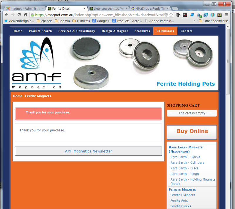

ok, I have had another look and the after_end file is the correct one for the formula.
But how do I know if it is the correct one for the payment gatway (Eway)?
Attached is the thank page after payment (not sure if that tells us anything.)
Don't look at what is and ask 'why?'; look at what isn't and ask 'Why Not!'
Last edit: 13 years 1 month ago by sambob.
13 years 1 month ago #113528
For eway, you have to edit the file "eway_thanks.php" in the eway plugin via ftp.
It don't use the standard HikaShop view.
