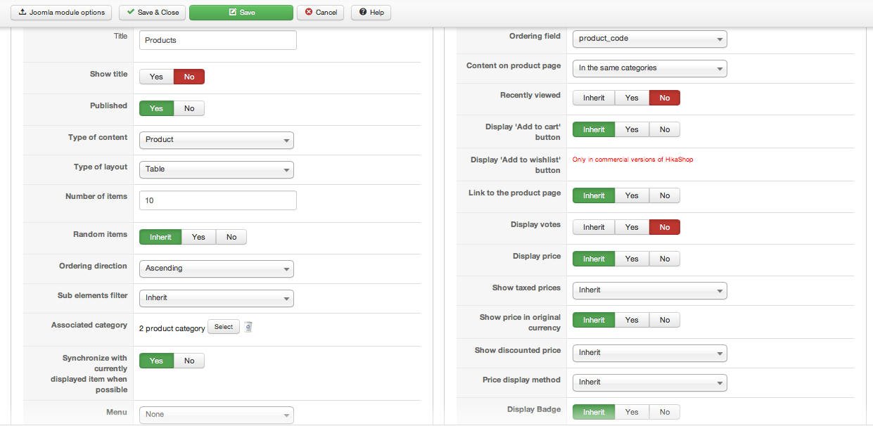

The product list is enabled as a module displayed at the bottom of the page. A screenshot of the module from the 'content module' part of HikaShop is attached.

13 years 1 month ago #113548
There is no pagination for the modules.
When you set 10 items it display the 10 first items.
The following user(s) said Thank You: lewisg1

Do you reckon displaying categories in a module, and then the main pages as a product table would work? However, when I tried this, I get the error: "Error: 500 - Layout listing_inherit not found."
  • Posts: 86106
  • Thank you received: 14207
13 years 1 month ago #113628
If your product listing module is attached to your category listing menu as an associated module, the pagination will be displayed. That is in fact the recommended setup of our documentation:
www.hikashop.com/en/support/documentatio...html#categories_menu
However, modules displayed by the template on specific template positions cannot have pagination.
Regarding the error, it means that in the "layout" option of your menu/module you selected "inherit". Please select "table" or "div" and it will work.
