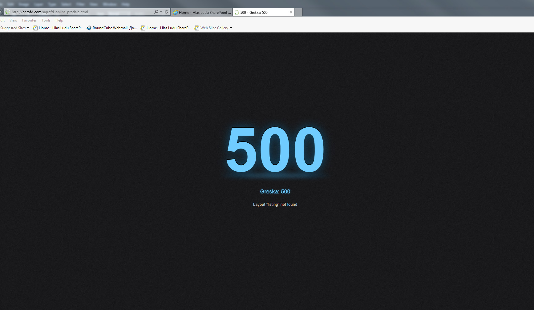

Hi I have the same problem. But error is 500 Layout "listing" not found. When i I try to log in.
Thank you. Miroslav

  • Posts: 12
11 years 5 months ago #196602
This was really fast, thanks.
Link is www.agrofd.com/ and menu ONLINE PRODAJA.
Everything is fine until you log in below right .. or enter anything .. instead of comments.... appeared error 500
Thanks.

  • Posts: 12
11 years 5 months ago #196631
Hi, interesting.
Have you tried to type in the login form anything, or can you log in directly onthe site page ONLINE PRODAJA?
I always get a 500 error.
I tried on different computers
Thanks...
  • Posts: 86104
  • Thank you received: 14203
11 years 5 months ago #196643
I hadn't tried with the Joomla login form, only with the HikaShop login form of the HikaShop checkout.
I indeed have the problem with the Joomla login form. But this has nothing to do with HikaShop.
I would recommend to delete the Joomla login module via the Joomla modules manager and then recreate it with the default settings.
If that doesn't help, I would recommend to seek advice on the forum of joomla.org where you'll find people knowing a lot more about issues with Joomla itself than us.
