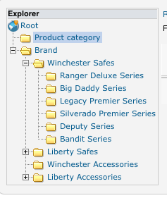

We placed our categories within the Brand section since it made more sense to classify our groups as brands rather than product categories. That may be the issue. Attached is a screenshot of our explorer.

That indeed comes from that.
The categories are supposed to be under the product categories, while the brands in the brands.
And in the products, you need to select a brand in the brand dropdown and categories in the category area.
Otherwise, it won't work properly.
So you can simply add the product category as a second category of your products and the products will then be displayed in the search results.
