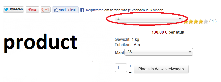

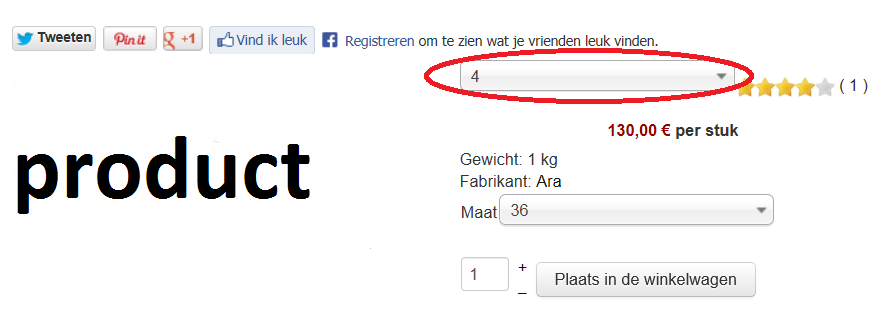

Is it possible to hide the drop down menu for voting? By default it shows a drop down menu next to the images (stars) for voting for a particular product.
When looking at the demo of Hikashop there isn't a drop down menu next to the images for voting. So it is possible, but i don't know how to accomplish this?

Can you please provide a screenshot of your problem ?
The problem that we can see in the first screenshot of this thread show that the drop down is transformed by the "chosen" library.
Since, we added the class "chzn-done" to the classical select so the Chosen library shouldn't put his special content for these select.
If you have chosen dropdown for the votes, I think we should deactivate the chosen library or see why this library initialize his dropdown on "select" which have already the class "chzn-done".
