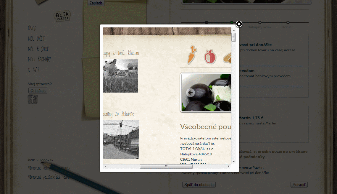

I set up a link in Hikashop->Checkout->Terms and Conditions to an article created in Joomla.
During the checkout I see a url link, but after click on it I get a smaller window on top of the shop, which display it in a wrong way (it show the whole website inside) as you can see it on attached screenshot.
Did somebody get the same issue, or solved it already?
