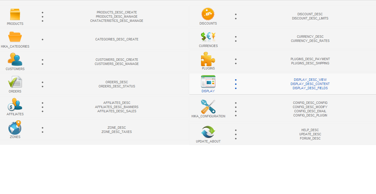

but after upgrade i getting a lot of misposition and error on my live site @@"
take a look www.dreamzfashion.com/index.php , all the unit, price currency are not showing correctly in front end
in backend, i encounter similiar problem on all place , check the attached image

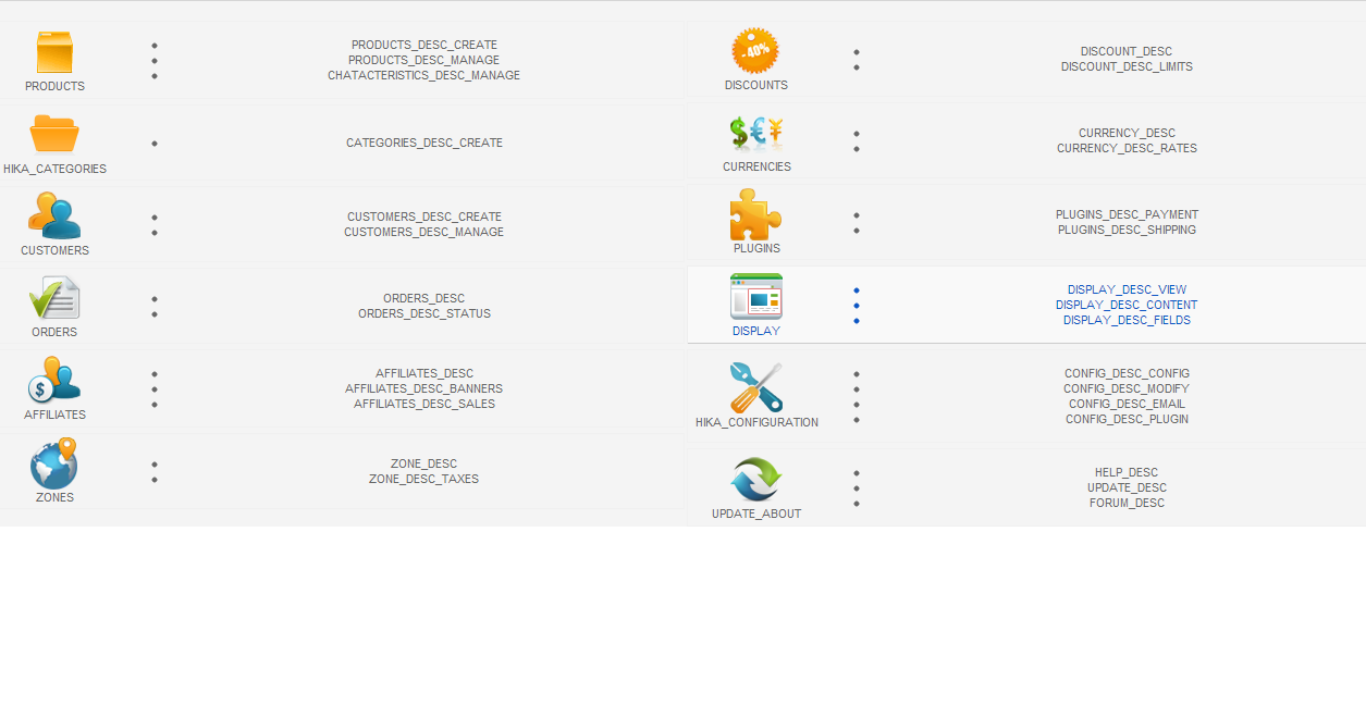

This means that there is an error in your language file. Turn on the debug language mode option of the joomla configuration and go again on the page with the issue. Look at the bottom and joomla will tell on which line of which language file the error is.

12 years 11 months ago #114492
Ok, We found out what the problem was and we fixed it, so you should just :
- Go to "Hikashop->System->Configuration->Language->'YOUR LANGUAGE FILE'"
- Use the Load the latest version from our server button and SAVE
Then it should fix your problem.
