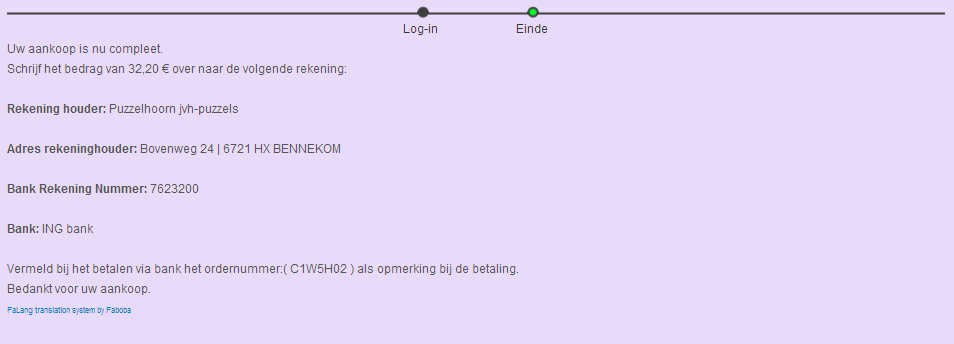

13 years 2 months ago #114494
It seems to be working fine with me :

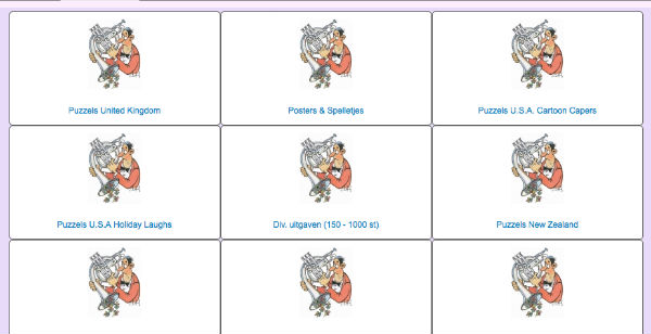

13 years 2 months ago #114509
That is the screen that should appear - and with you it apparently does, but not with me. I get the screen shown below (it is a page listing the product categories):
Can it have anything to do with multi site component 'Falang'? Although I did try to buy something both in German, Dutch and English.
Can you tell me which language preference you used and what steps you took, so I can try and reproduce your result?
