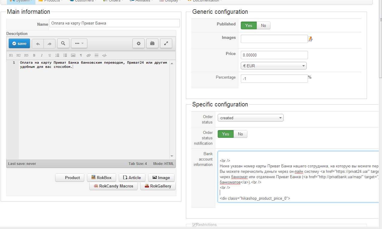

A screenshot of banktransfer plugin is attached hereto. Any mistake in its configuration from my side?

12 years 11 months ago #115046
To check if you pass in the "if" condition you can add "echo $data->order_payment_method;" to see the value returned, and why it's not going in the if.
