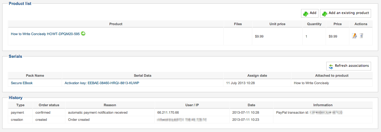

I went in and checked a recent order (which had not delivered serials to the customer), and took a screenshot of the relevant section. It does not appear that there is a problem with serial generation, as the serials are loading in correctly with each order (or at least they seem to be). I have not updated HikaSerial yet, pending your response.

12 years 11 months ago #115700
Ok, so it is a good news if the generation still working.
If you try to change the order status and click on the "notify customer" checkbox, do you see the HikaSerial part in the email content ?
