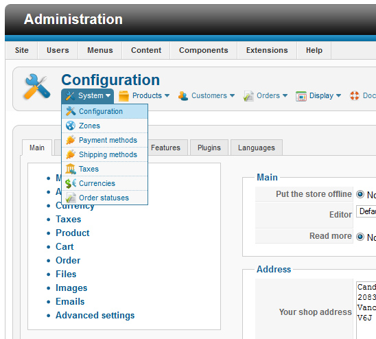

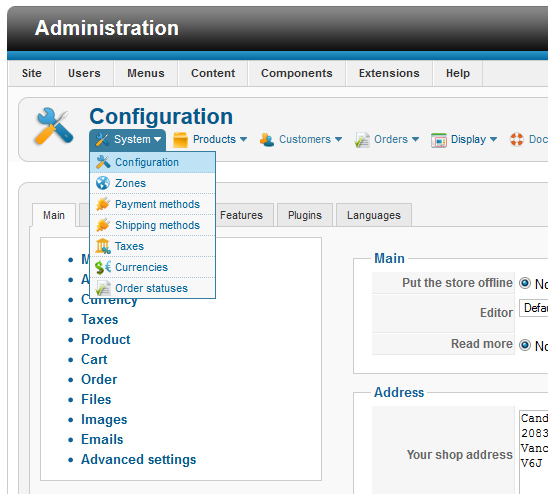

  • Posts: 14
12 years 11 months ago #115756
It says that I have 2.2.0 under the "about" tab. This is what I get (see image.) Any thoughts?

  • Posts: 2334
  • Thank you received: 403
12 years 11 months ago #115787
Could you try to reinstall? The mass action features is included in this built.
