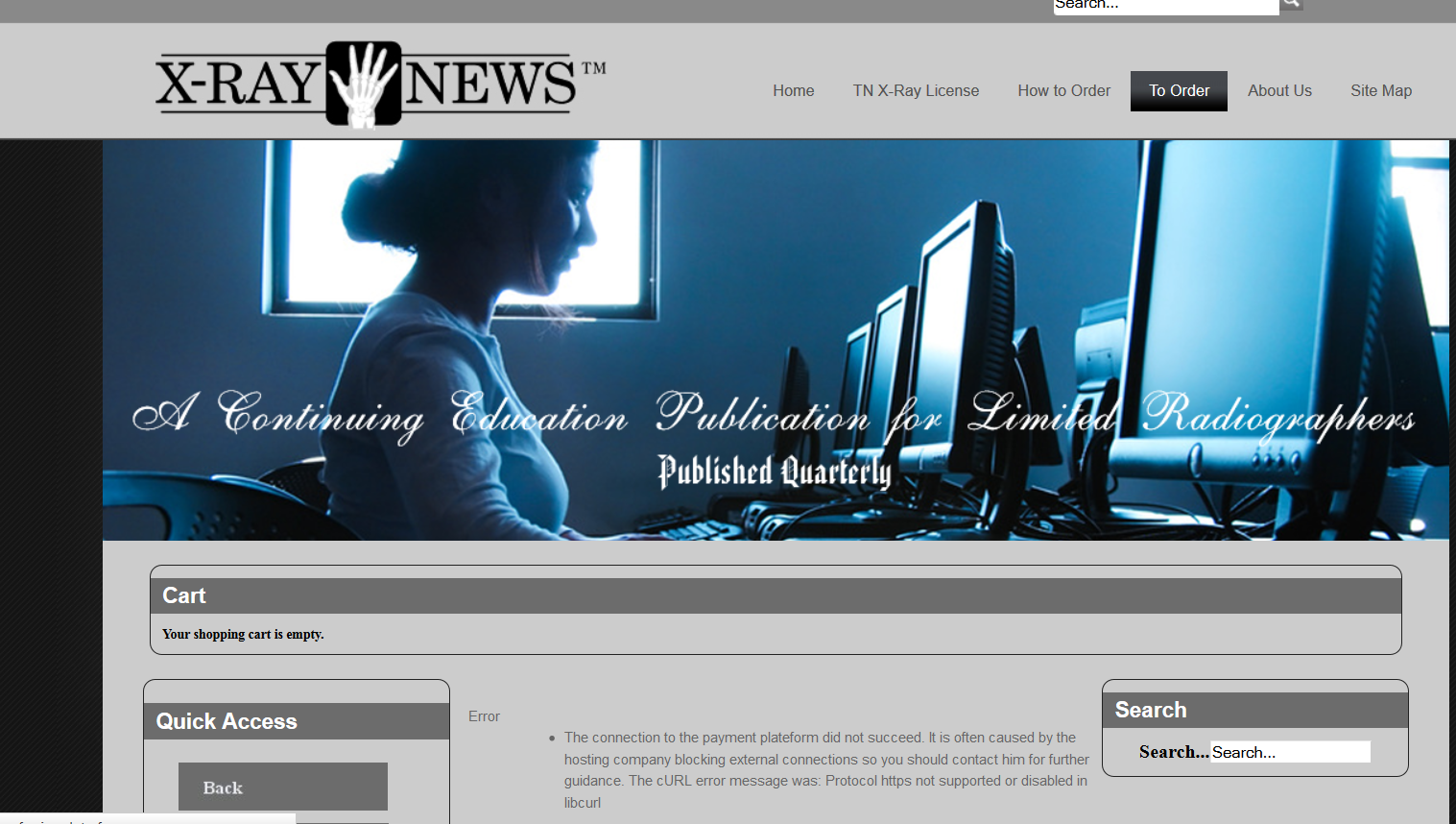

We are trying to setup the authorize.net plugin using AIM. I'm using a Sandbox account for testing purposes. The cart will create the order but will not send it to authorize.net. I can only imagine that we have not clicked a needed box somewhere. We have gone over and over the plugin and everything looks right. We don't get any error message but the customer gets an email with this statement: Your order will be processed as soon as we receive your payment.
Help would be greatly appreciated.
  • Posts: 55
12 years 11 months ago #115748
I found this error which you have to catch before it changes to Thank You for your Order. Our ISP said: As far php curl goes, We have curl compiled. We are going to recompile it using CUrlSSL.
They did this and we still get the error. Anyone have any ideas? Thanks!

Can you try to download again HikaShop on our website and install it again on yours ? Maybe there was an issue with that ?
Normally, it is not possible that the order is created if the payment is not sent to authorize.net
Regarding the connectivity issue to authorize.net, cURL tells you that the problem is that libcurl on your server does not support SSL.
Our plugin requires that so that the security of the communications is guaranteed.
Maybe the plugins you're using on drupal and zencart do not use SSL and communicate in clear with authorize.net (I don't think that you can be PCI-DSS compliant without that though...).
Anyway, you can always try to remove the SSL security by changing https to http in the URL option of the plugin.

I found the problem. I can't believe it. I've checked this several times, but there was a space in front of the url. :side:
