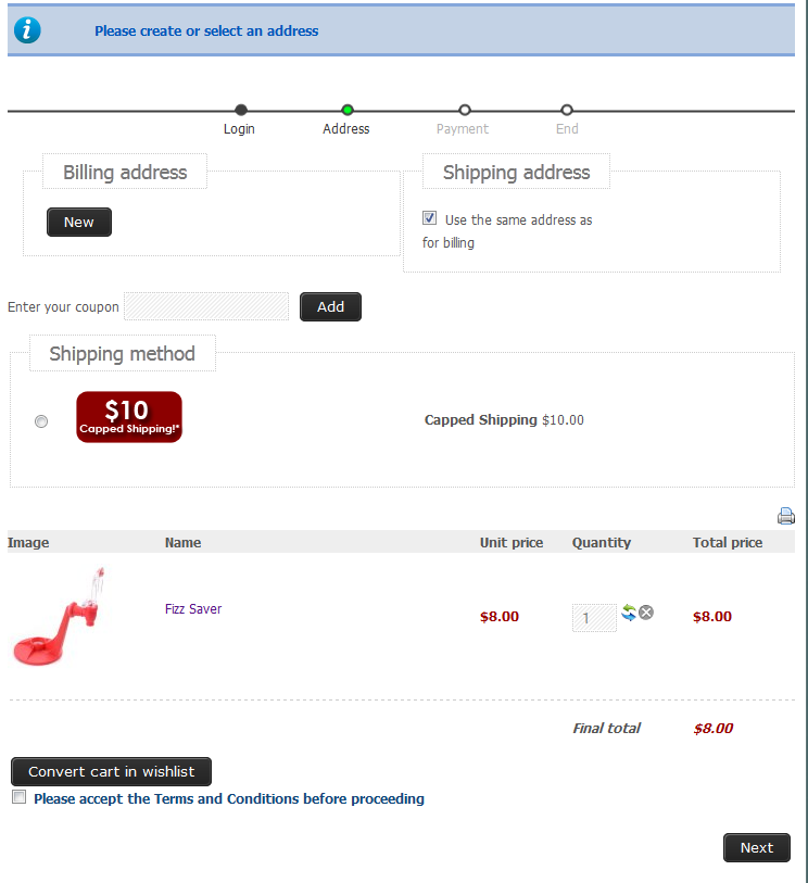

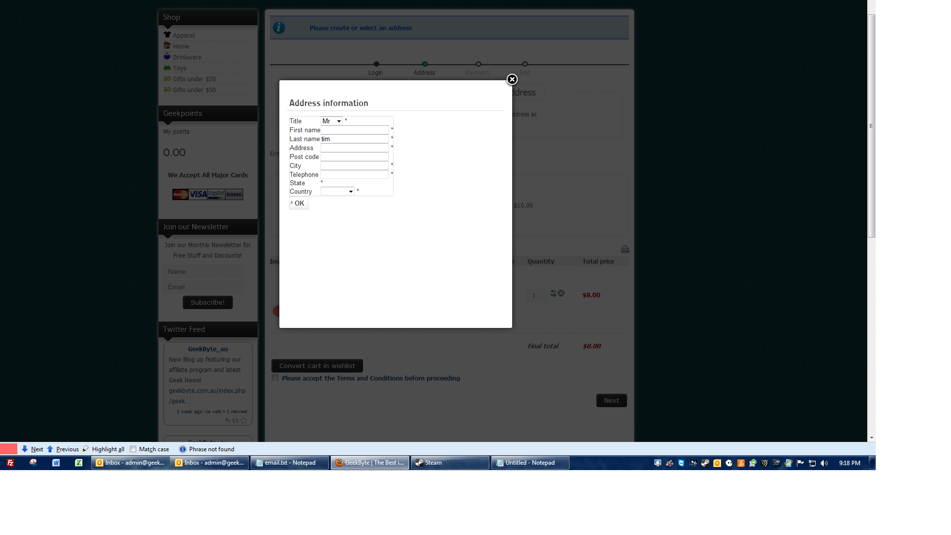

When users register to my site they use a simplified registration form.
After they've been shopping and attempt to checkout - they get a popup that asks for the billing information. The popup isn't very nice looking.
If you close the popup - the billing address section has a button that just says "New" and then if clicked re-opens the popup.
Is it possible to have the users fill in this information on the base checkout page instead of having to open the popup?
If I need to keep the popup I can probably figure out some css to make it look nicer.
I've attached a couple of screenshots.

I have the same issue, when you try to access the site from a mobile device. The popup covers the entire screen and the user cant see the submit button etc.. Where is the source file to fix the sizing for the popup????
  • Posts: 85884
  • Thank you received: 14124
12 years 10 months ago #119424
You can edit the file "address_view" via the menu Display>Views and change the part size: {x: 450, y: 480} of the line:
<a id="hikashop_checkout_<?php echo $this->type;?>_address_new_link" rel="{handler: 'iframe', size: {x: 450, y: 480}}" href="<?php echo hikashop_completeLink('address&redirect=checkout&task=add&step='.$this->step.'&type='.$this->type.$url_itemid,true);?>" onclick="return hikashopEditAddress(this,<?php echo (int)$same_address; ?>,true);">
