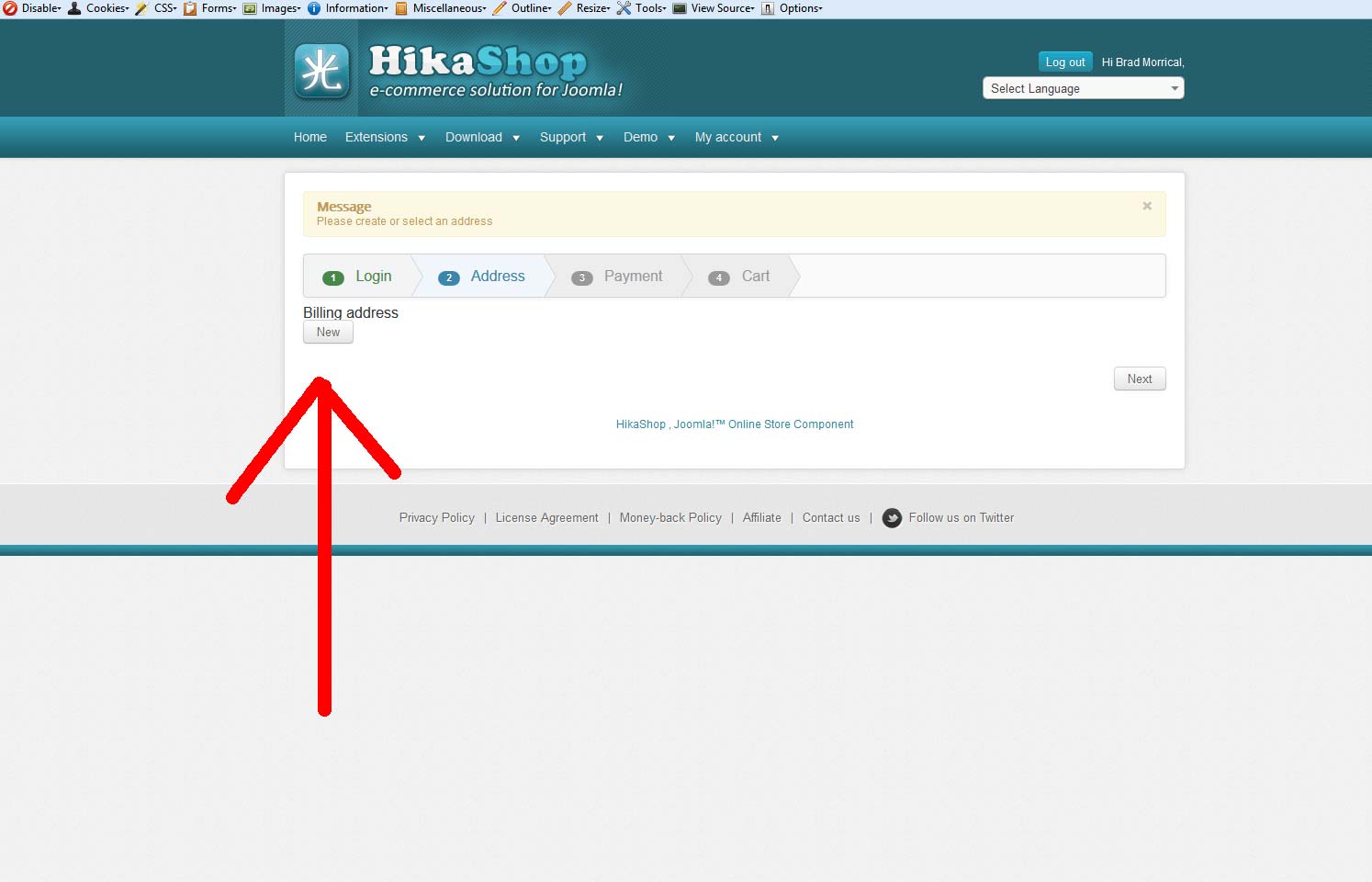

Hello, I am trying to buy your business package and the checkout is broke.
When it asks for me to enter a billing address I can't click 'New' or 'Next" They both do nothing.
Please advise!

12 years 1 month ago #116924
I tried it on my end and it seems to be working fine, can you try it again ? :).

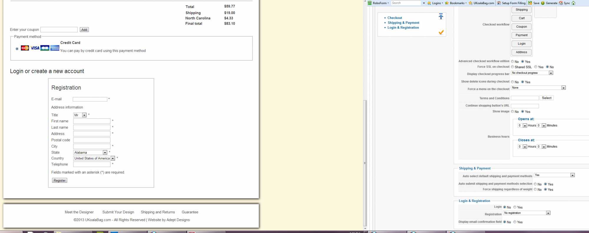

12 years 1 month ago #117947
Hi, I purchased the Essential version.
I configured exactly as you described, yet I am still being asked to 'Register' I simply need address info for billing, shipping and tax.
(see image)
Can you help me resolve?
12 years 1 month ago #117994
What is displayed is correct, it's the form for the address.
You just have to do some translations override, like changing "Registration" to "Your address", and "Register" (on the button) to "Use this address".
