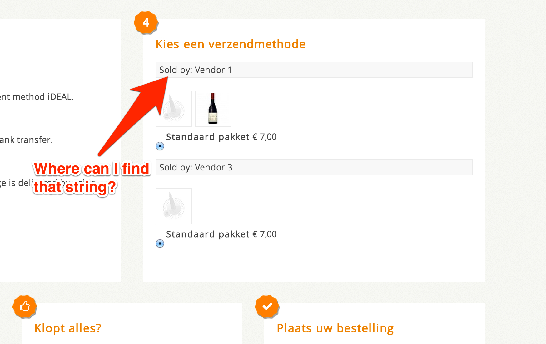

I can't find a particular language string, see the attached screen dump. Have installed the Dutch language files, but it seems the string "Sold by:" is not translated at all. According to the structure of the checkout view, this string is located in components/com_hikashop/views/tmpl/checkout/shipping.php, somewhere around line 30. However, the only string I can find there is SHIPPING_INFORMATION (line 36). And that's definitely not the right string. So, where is "Sold by" added to the HTML?
Any thoughts on this?

Shipping per vendor is a feature coming from HikaMarket. So the translation string comes from HikaMarket's translation file, not HikaShop.
There is actually no translation file in Dutch for HikaMarket.
Like for HikaShop, you can go in the Languages tab of the configuration of HikaMarket in order to translate it in your language. Do not hesitate to use the "share" button once done so that we can include your translations in HikaMarket so that others can benefit from that.

Ok, thanks for the info. Have started to translate the strings. Within a few weeks I'll share them.
