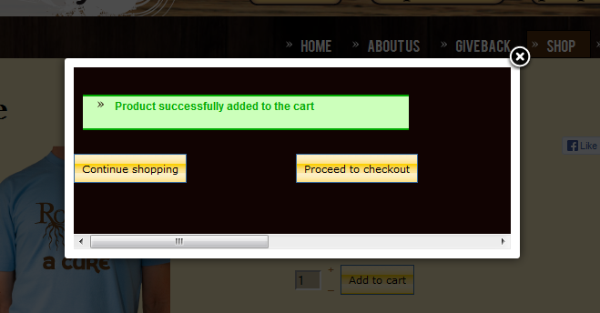

12 years 11 months ago #126939
Please refer to ths site tangyweb.com.au
Currently I have it set to show a popup whenever something is added to the cart. This is ok, however I want to know how much you can customise it? Maybe change the way it looks, and make it stay on the screen for a bit longer too?

12 years 10 months ago #128823
Hi- how can I edit the size of the popup so there is no slider at the bottom?

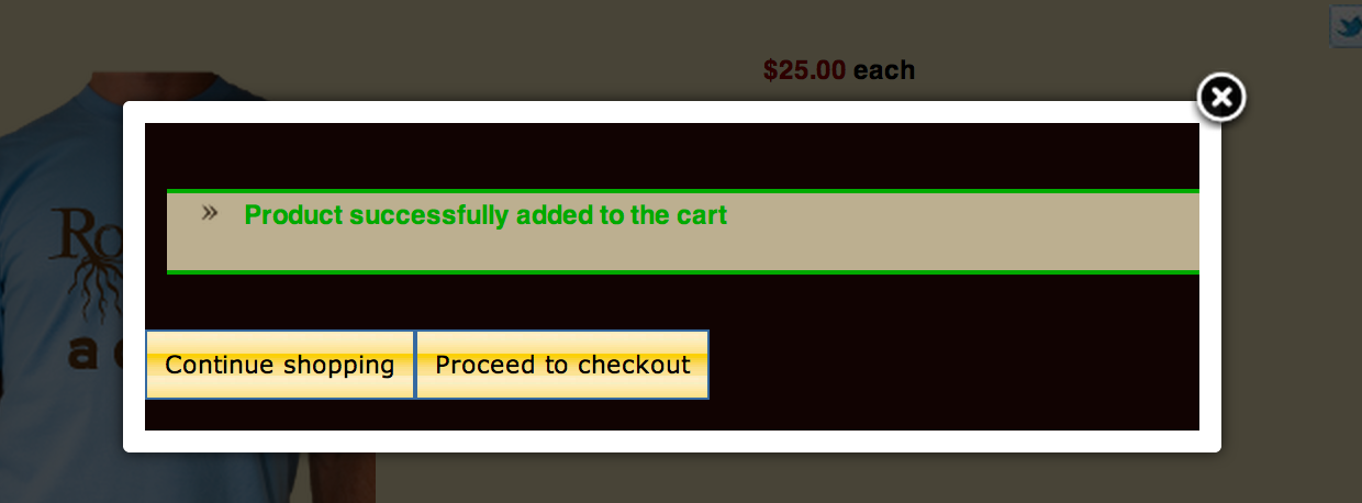

12 years 10 months ago #128866
You'll probably find your answer through this thread :
You can edit the file administrator/components/com_hikashop/helper/cart.php and change the line:
echo '<div style="display:none;"><a rel="{handler: \'iframe\',size: {x: 480, y: 140}}" id="hikashop_notice_box_trigger_link" href="'.hikashop_completeLink('checkout&task=notice'.$url_itemid,true).'"></a></div>';
  • Posts: 47
12 years 10 months ago #128880
Thanks Mohamed. I did follow this thread already and changing those dimensions changes the box size, but there is still a slider at the bottom because the "container" ? is too big (I guess). The picture I included is only half the box. It slides to the right some more, and when you click in the box the slider appears at the bottom. Here is a better example:
Last edit: 12 years 10 months ago by word.
12 years 10 months ago #128960
You can add some css properties to your template to set the width of the main div of the notice.
Here is how to customize the display, I think that this tutorial could help you:
The class needed should be: .hikashop_notice_box_content{width: 300px !important;}

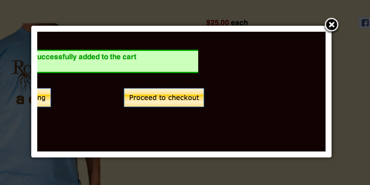

12 years 10 months ago #129643
Ok, I appreciate your help but I think there is a misunderstanding. The code you gave changes the message box, but not the box that the message box is in. Please see:
Here, I put 900px for the width and see what happens. When I put 300, the green box shortens, but the box that everything is in (the black box) is still very long and has a slider at the bottom.
I think this is a Joomla template thing but I am not sure. Can I give access and have you see firsthand what I am talking about?
edit: I just emailed you the backend access info.

  • Posts: 86105
  • Thank you received: 14205
12 years 10 months ago #129647
The popups border are define in the file www.tangyweb.com.au/media/system/css/modal.css as its a standard joomla display element.
Regarding the slider, that's actually because of the CSS of the template which force the width of the page (and the area in the popup is considered as another page). You should remove that in your template and that will remove the slider and it will be centered properly.

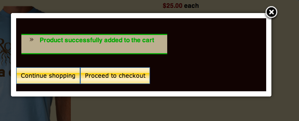

  • Posts: 47
12 years 10 months ago #129770
Thanks Nicolas. I am really sorry for bugging you guys with this, but I am still having a hell of a time figuring this out. :S Can you please look at the template CSS and tell me what I am missing? I do not see anything that forces the width of the page. If I set the rt-main rt-container width to 300px, it does what I want in the box, but the rest of the page is not right.
Thanks so much for your help with this.

I just re read what you wrote and tried the cart.php mod. This does change the size of the box, but not the size of the container that the box is in. I still get the slider and that is what I am struggling with.
I'm pretty sure this is a Joomla template thing as Nicolas mentioned, but I just can't figure out whats sizing that container/page/box whatever it is!
My template css is listed above if that helps.
