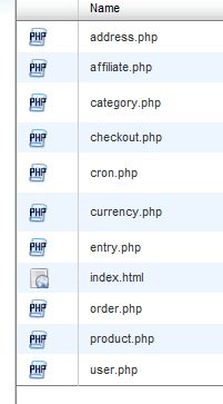

For the watermark, I could find the file with toggle on the end - have attached a snipping for you to see what is available. Tried doing a search for that line in cpanel, and nothing came up... :blink:
Thanks for your help :)
  • Posts: 86181
15 years 6 months ago #8646
You're looking at the folder components/com_hikashop/controllers and not the folder administrator/components/com_hikashop/controllers

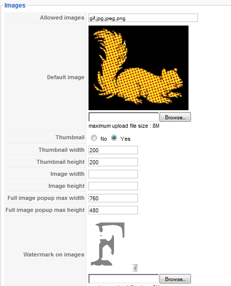

15 years 6 months ago #8707
Yep, please see attached :)
  • Posts: 86181
15 years 6 months ago #8716

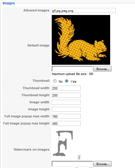

We need to see the options themselves in the tab files and not just the tab bar :)
  • Posts: 392
15 years 6 months ago #8717
of all the tabs? :)
  • Posts: 86181
15 years 6 months ago #8719
  • Posts: 392
15 years 6 months ago #8722
Oh, ok!
Last edit: 15 years 6 months ago by Bugger101.
  • Posts: 86181
15 years 6 months ago #8724
I see that you still have your watermark. Did you try to remove it and upload images after ?
  • Posts: 392
15 years 6 months ago #8726
Yes, the watermark has gone from the pictures, but now when I try to upload new images, I get a blank square... :/
