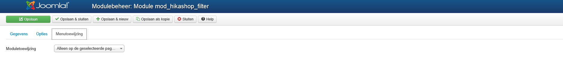

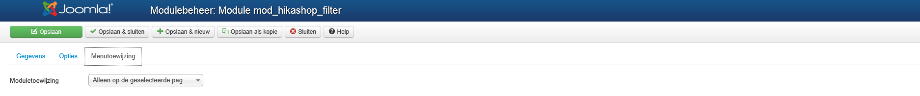

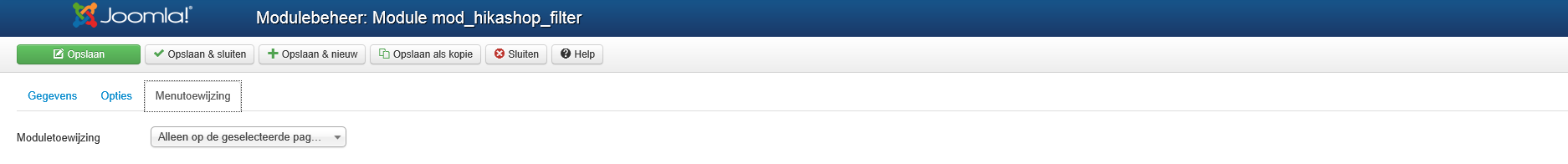

1. I am using the filter module. I only want the filters to show on the product view (the menu item which shows ALL the products). Now when you click on a single product the filters are also visible on the product page (the page with only ONE product). How to exclude the filters from the product page?
2. The same goes for the checkout. I am using a module for the checkout. Now the filters are also visible on the checkout page. How to exclude the filters from the checkout page?
! i already set the standard joomla module restrictions to "only show on this page". But the filters are still visible on product page AND checkout page.
Last edit: 12 years 10 months ago by Jimmy.
12 years 10 months ago #129012
Even if you have already set it the problem is probably coming from the way you configured the "Module Assignment" Joomla restriction of your filter module, Can you show how did you configured it through some screenshots ?

I set the "module assignment" to only "show on the select pages", which is the HOME page.
But when i am on the HOME page and i try to proceed to the checkout (which i am using the cart MODULE for) the filters are also visible on the checkout page.

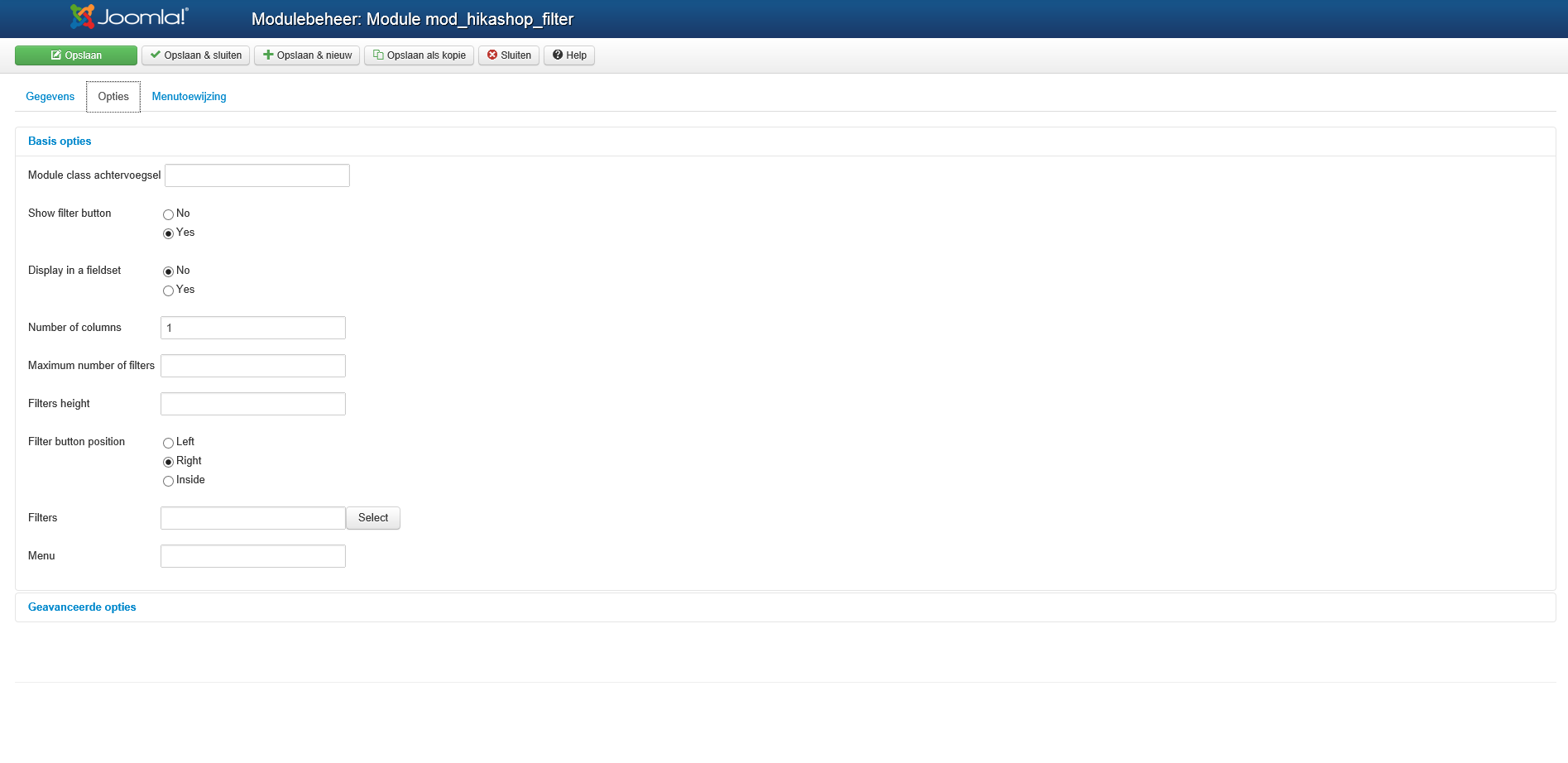

12 years 10 months ago #129245

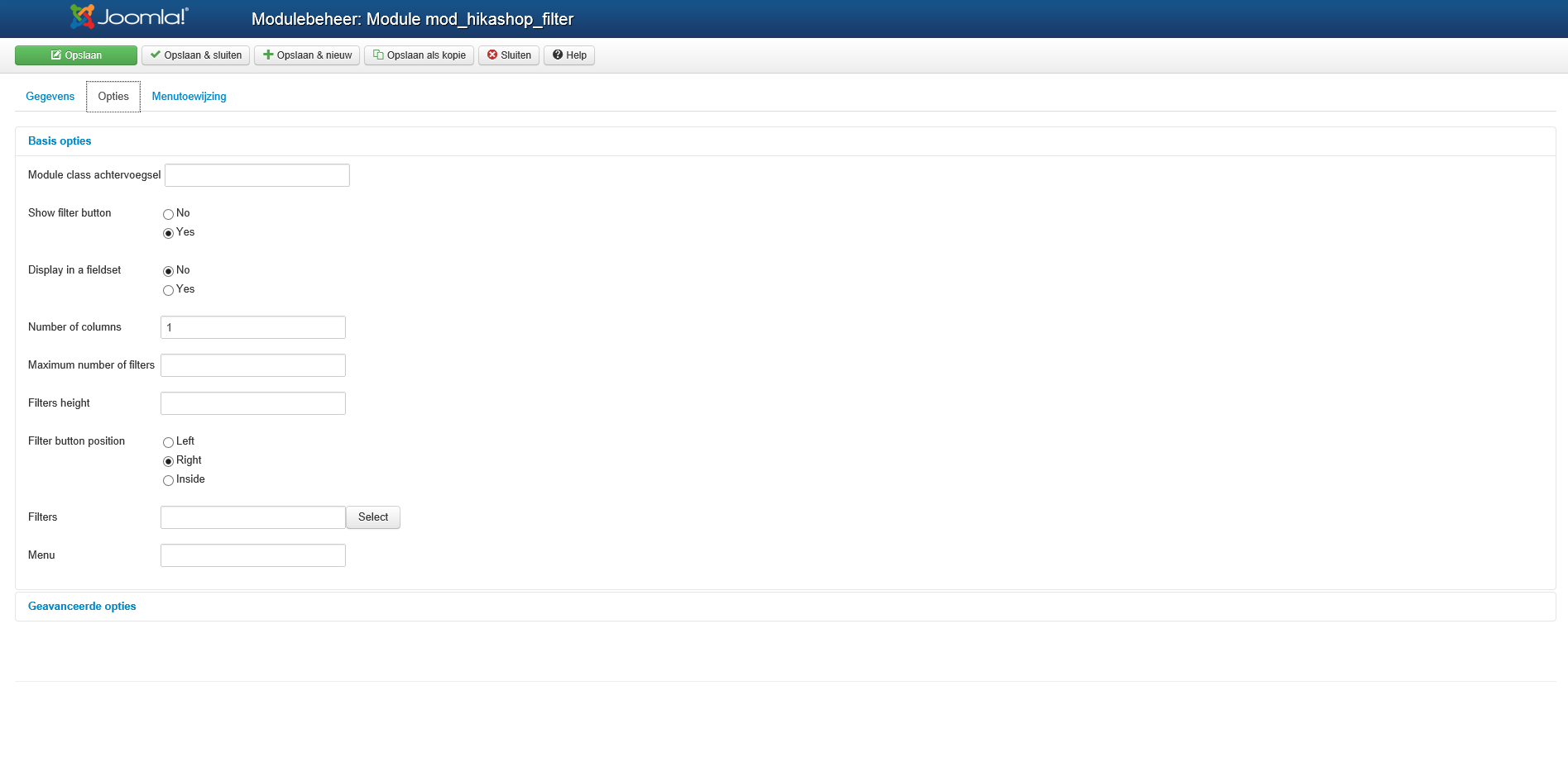

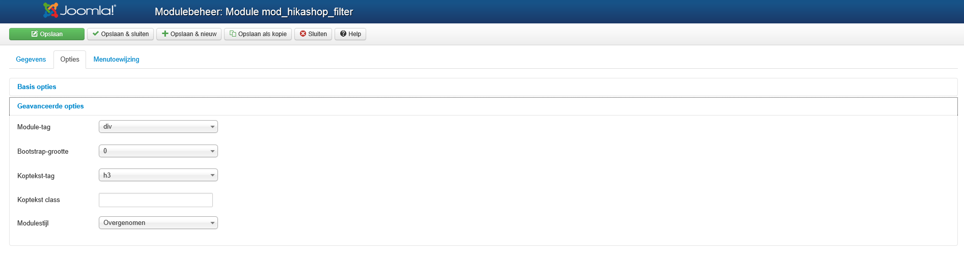

Can you show me through some screenshots how did you configured :
- Your checkout : "Hikashop->System->Configuration->Checkout"
- Your filter module, especially the module assignment and Menu selection options.

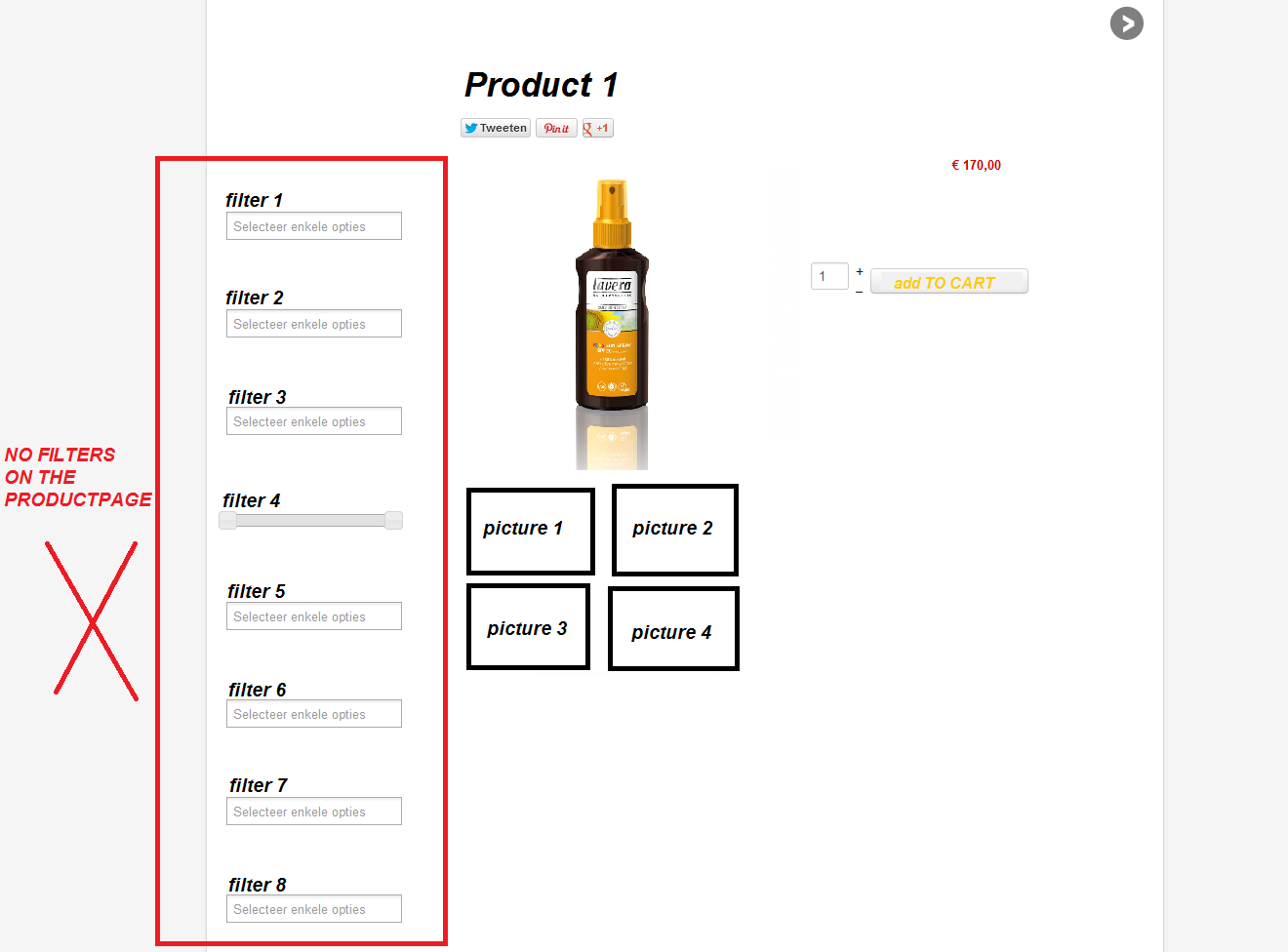

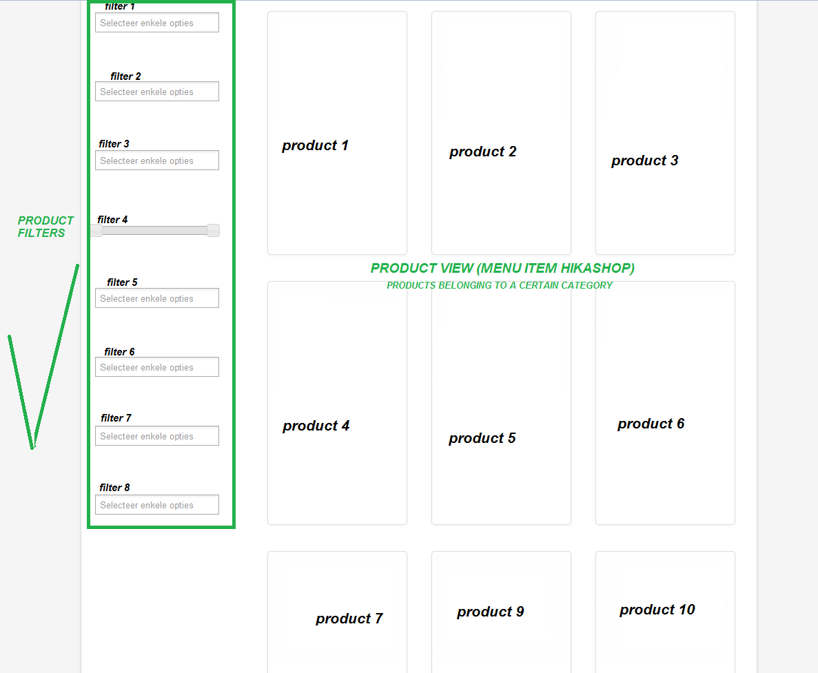

Thanks Nicolas. It worked, the filters aren't visible anymore at the checkout page.

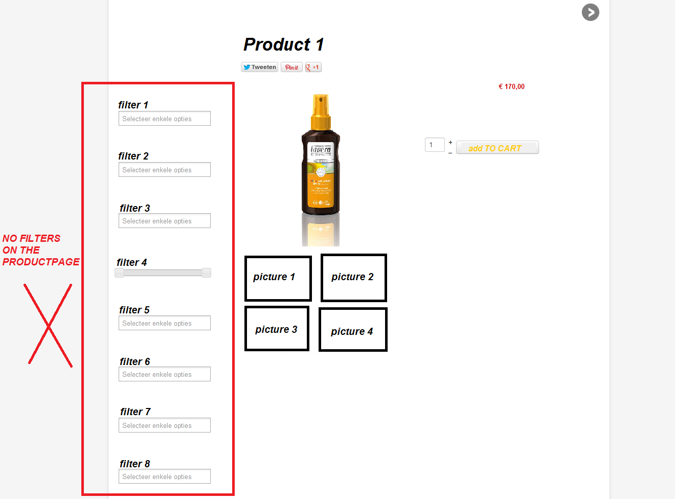

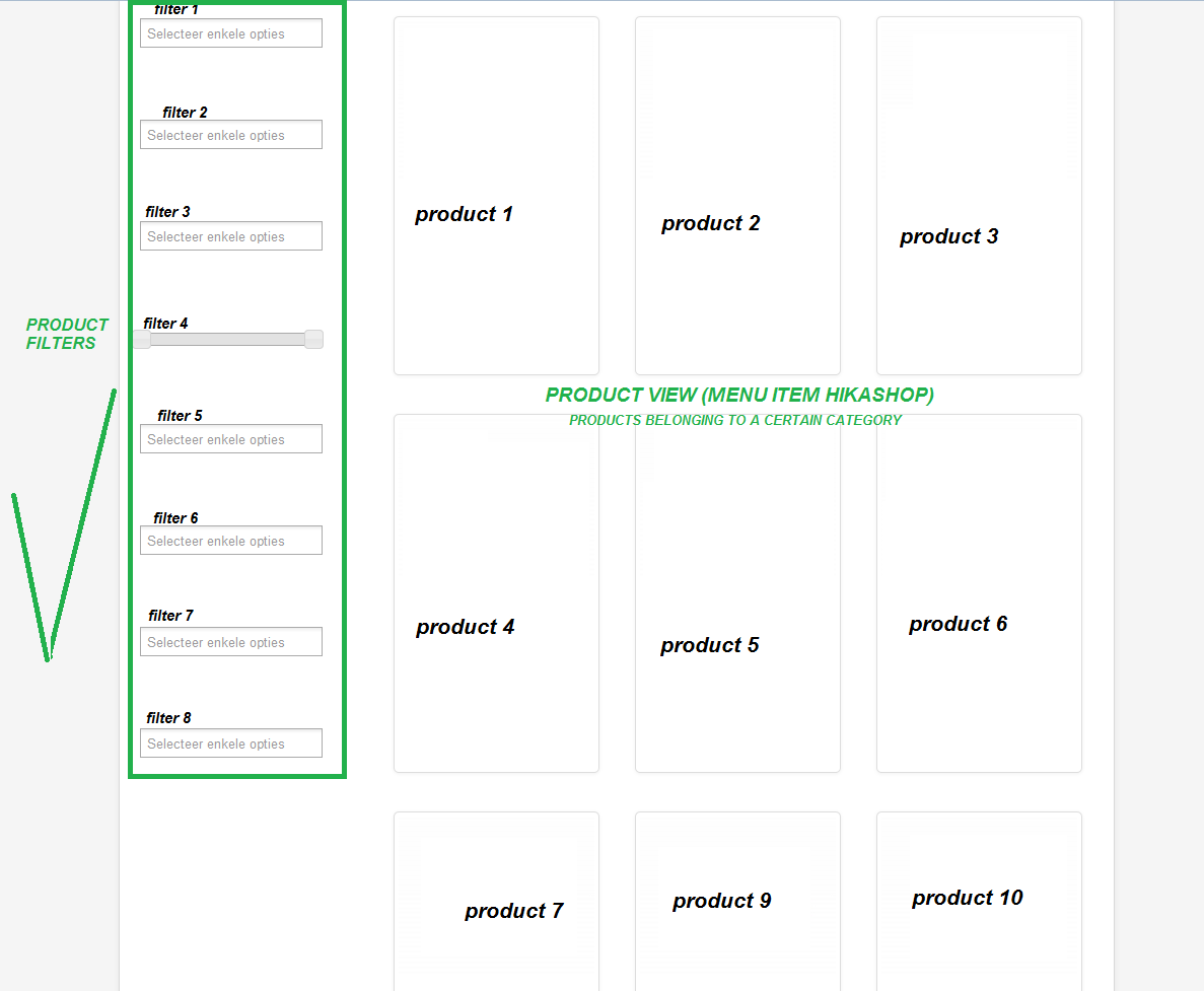

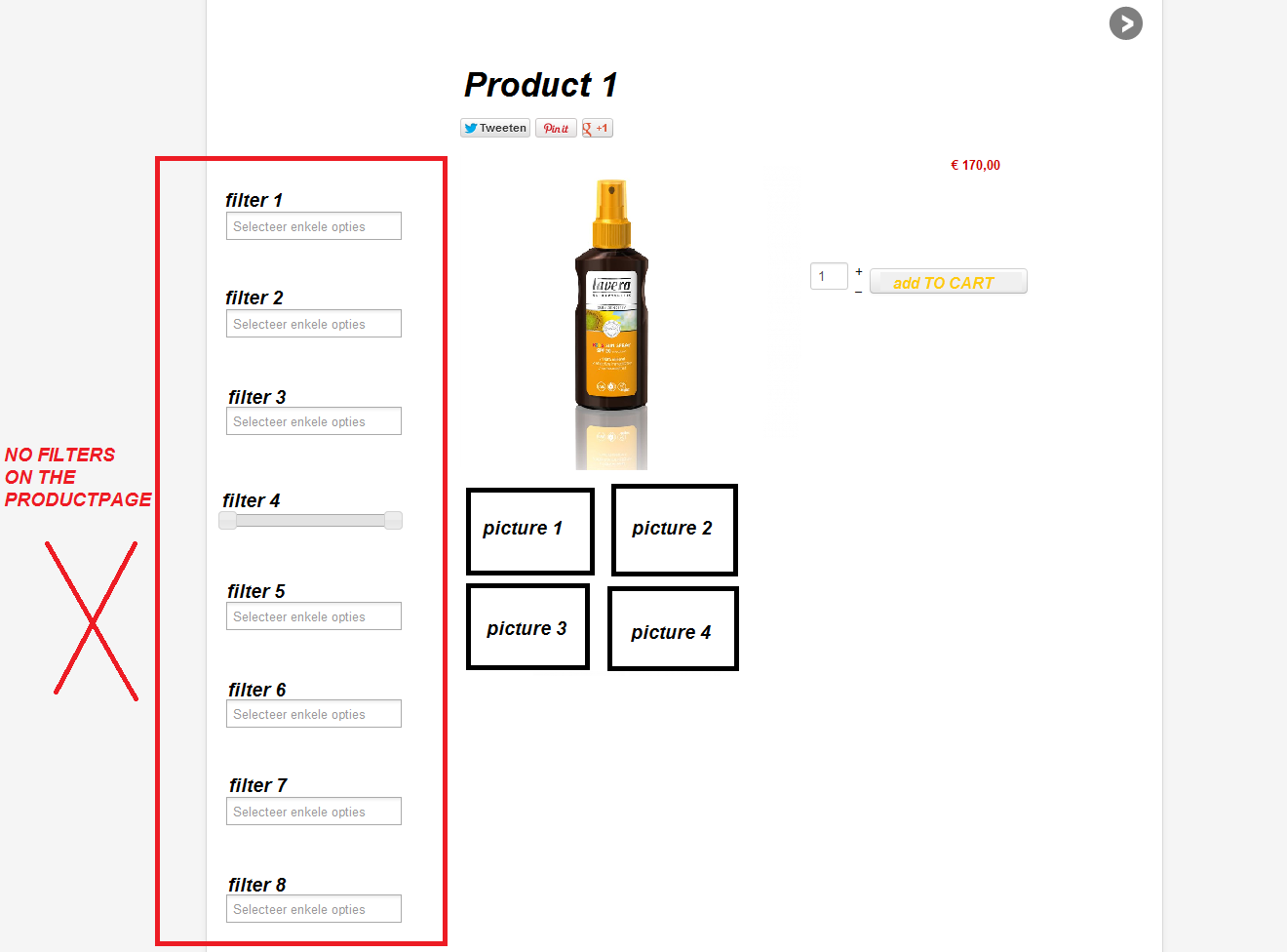

BUT they are still visible at the product page. I'm using a hikashop "product view" menu item to show all the products within a category (for example Suncreme). When you click on the Hikashop "product view" menu item you will see ALL the suncremes we offer --> screenshot 1. HERE i want the filters to be visible.
BUT when clicking on a product --> screenshot 2. It opens the productpage. THERE i DON'T want to have the filter to be visible.
Hopefully you can help me with this one.
12 years 10 months ago #129487
For the product page, I guess that you can disable the modules displayed in the product page thanks to the option "modules under the product page" in Configuration > Main > Product.

12 years 10 months ago #129644
Joomla has no option to discriminate between the product page and the products listing page as they are on the same menu item.
You will need to use an extension like Advanced Modules Manager which allows you to discriminate both type of pages for each module display on your website.
