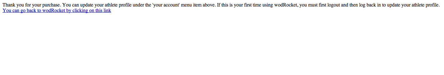

After users pay via Authorize.net, they are shown a white screen and a message which says:
"Thank you for your purchase. You can go back to wodRocket by clicking this link" (img below)
I would rather they are just redirected back to my site automatically.
How do I do this?

I am sorry but that thread seems to take people to a downloads folder etc.
I just want people to AUTOMATICALLY come back to my site (the home page) and see the "thank you for your purchase" language there NOT authorize.net.
Right now, they see the screenshot above on authorize.net.
