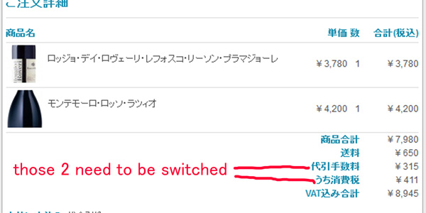

  • Posts: 142
12 years 8 months ago #136164
Thanks for your help, but I'm not a crack about php or any things else. therfore I need detailed help from you guys.
Here a printscreen of the mail that my customers get after placing the order
The upper one is the the fee for "cash on delivery" and the lower one is the tax from the product and shipping fee.
I need to change the secuences of thos two.
Can you explain me how to do that?
regards
Raphael
