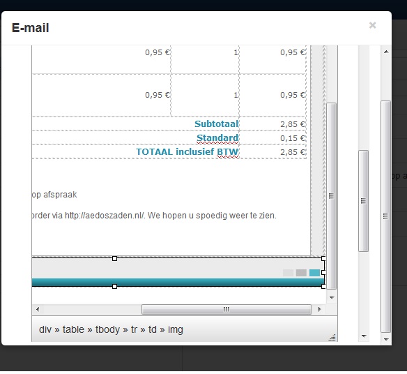

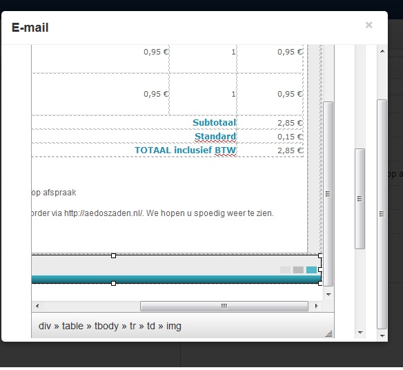

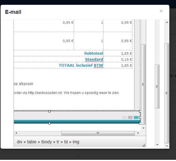

EDIT: how to change the word "standard" on the automatic email that is sent, I cant find it in the files nor in the translation files
thanks in advance
Last edit: 12 years 8 months ago by mike22. Reason: question changed
12 years 8 months ago #138798
Can you tell me exactly what is your "standard" word ? is it a product name ? variant ? a shipping method service ?
  • Posts: 23
12 years 8 months ago #138824
sorry i forgot to add it, it is says standard in the automatic emails sent after an order is made see attachment, I looked in the email files as well as the translational files but I could not find where this standard comes from
  • Posts: 86105
  • Thank you received: 14206
12 years 8 months ago #138859
This is the name of your tax rate that you can find via the menu System>Taxes. Simply create a new tax rate with the name you want and change it in your tax rule(s) and it will display what you want.
