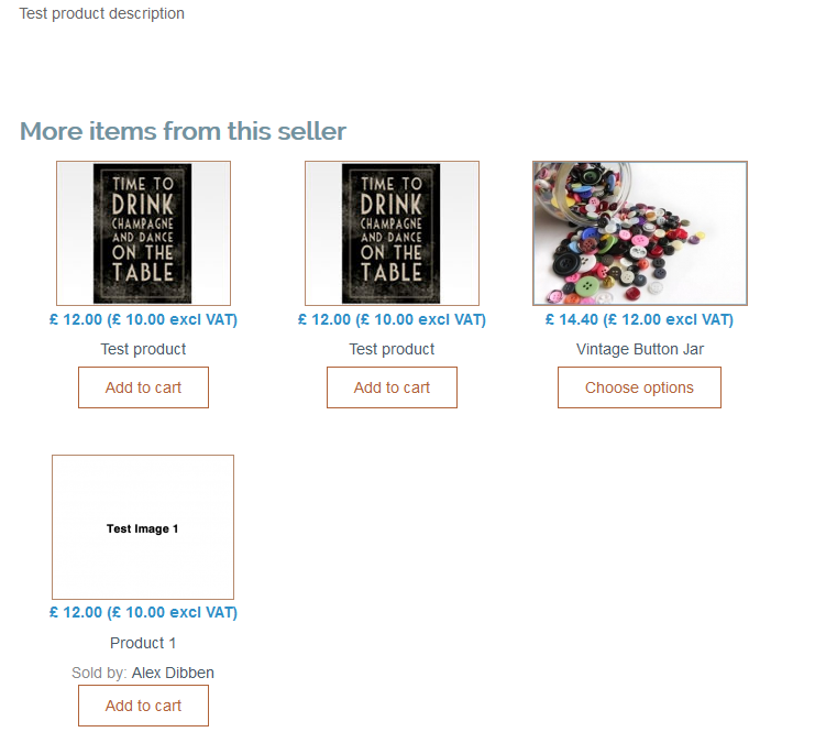

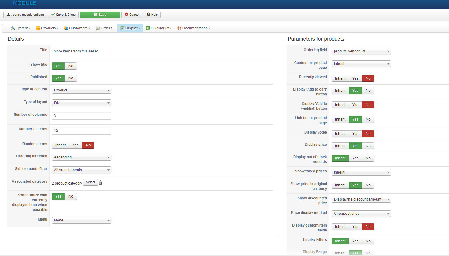

I have hikamarket setup, and i would like a module to show more items from the seller underneath their products. I have created a module and set the 'Synchronize with currently
displayed item when possible ' i.e to sync with sellers other products, however other products are being shown. If it is not possible to show only from that seller is it possible to order them so that other sellers items are listed first?

I am not sure why it is not showing any of the vendors other products let alone another sellers products...
www.warestreetmarket.com/newsite/Artist/...y-victoria-penn.html
Do you know how it decides what a similar product is because i think the similar products we have showing don't really have any relation to the current product...
Alex
12 years 5 months ago #148289
Your configuration does not display the products of the same vendor.
To do that, you have to implement the feature thanks to a plugin, using the trigger explained in my previous post.
Your current configuration just use a special sorting on the vendor_id and display all products in all sub categories.
It can't have link with the current product until you implement it with the trigger.
