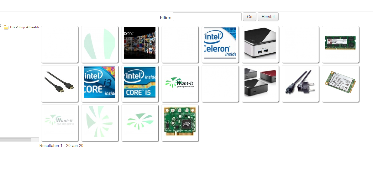

12 years 6 months ago #145987
This is a capture of the image selection popup of the products. What is the problem with it ? It looks normal to me.
  • Posts: 8

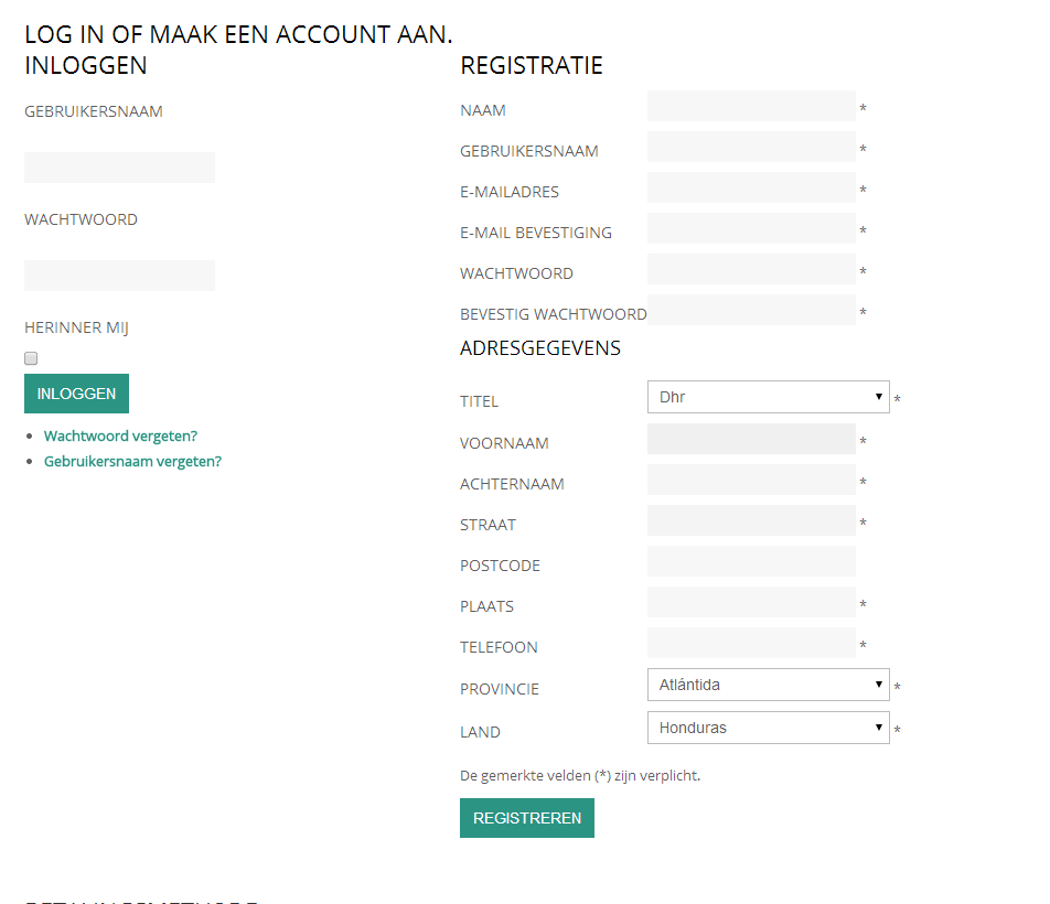

12 years 6 months ago #146186
yes it is a capture of the image popup screen but half of them are white and do not display the image, and the images are not bigger than 300 x 300.
and for reason i can not select holland or netherlands in registration it is not there. how do i add a country in the registration section.??
thanks so far.
Last edit: 12 years 6 months ago by mworron.
12 years 6 months ago #146245
What is the image type ? JPG, PNG, ... ?
Regarding the size, thanks to check your parameters in Configuration > Main > Images.
For the countries not present in the registration, they maybe are no more published in the zones, you can publish them again via the menu System > Zones.
