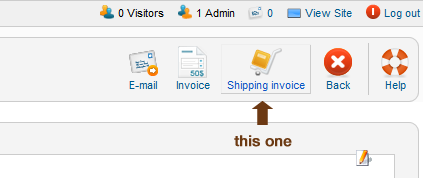

Thanks for this, I see the invoice however there is another one, called shipping invoice, please find attached (this is button is visible on the order page).
Alex

The "invoice" and the "shipping invoice" are using the same view in HikaShop.
You can customize the "(shipping) invoice" by overriding the view "order | invoice".
There are one view in the front-end (for the customer) and one view in the backend (for the administrator).
You will see in the page some " if($this->invoice_type=='full') " to make the difference between the invoice and the shipping invoice.
