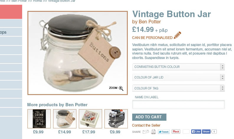

I would like to add a custom field on the front end so that the customer can type in some text on the order. So they might want some custom name, i would like a text field that they can type into. Currently the custom field will only show if i enter text into it...
I have attached a design to explain what i mean.
How would I go about doing it?

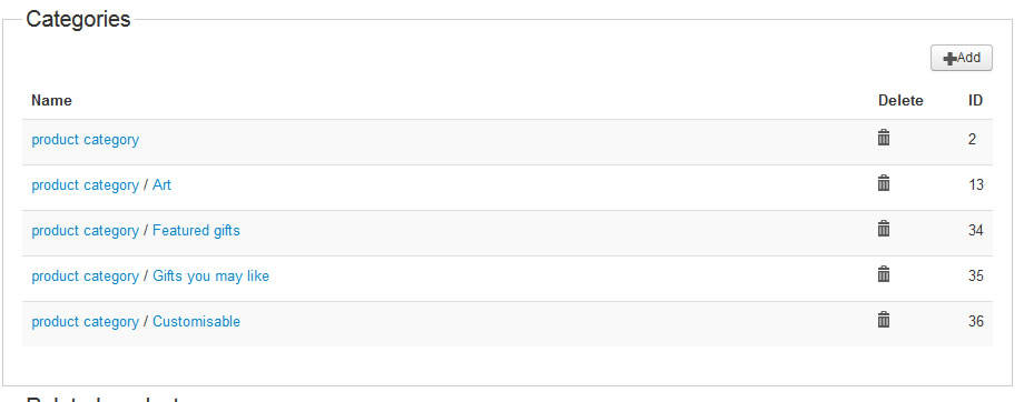

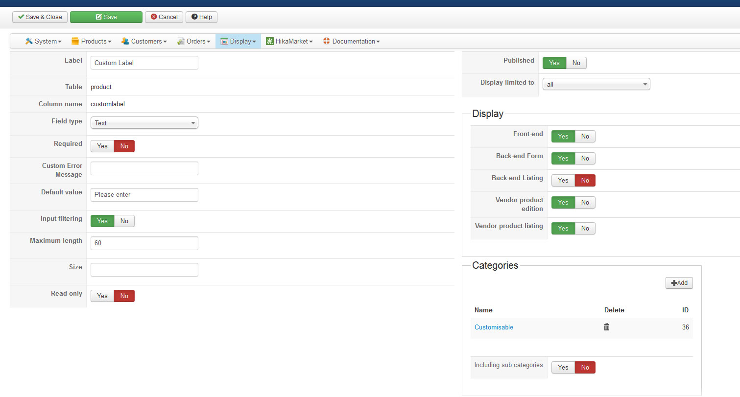

Thanks, I have followed the steps:
1. Create 'custom field' in table 'product' of field type 'text'
2. Make it apply to categories 'customizable'
3. Add my product also to category 'customizable'
However when i check the front end I cannot see a reference to the field.
www.warestreetmarket.com/newsite/Browse-...tage-button-jar.html
I have screen shot of config attached.
12 years 5 months ago #148434
I think that you should use an Item Custom field to do that :).
Not product... Item.
  • Posts: 377
  • Thank you received: 7
12 years 5 months ago #148495
Thanks, This works better with just item 'text field'
