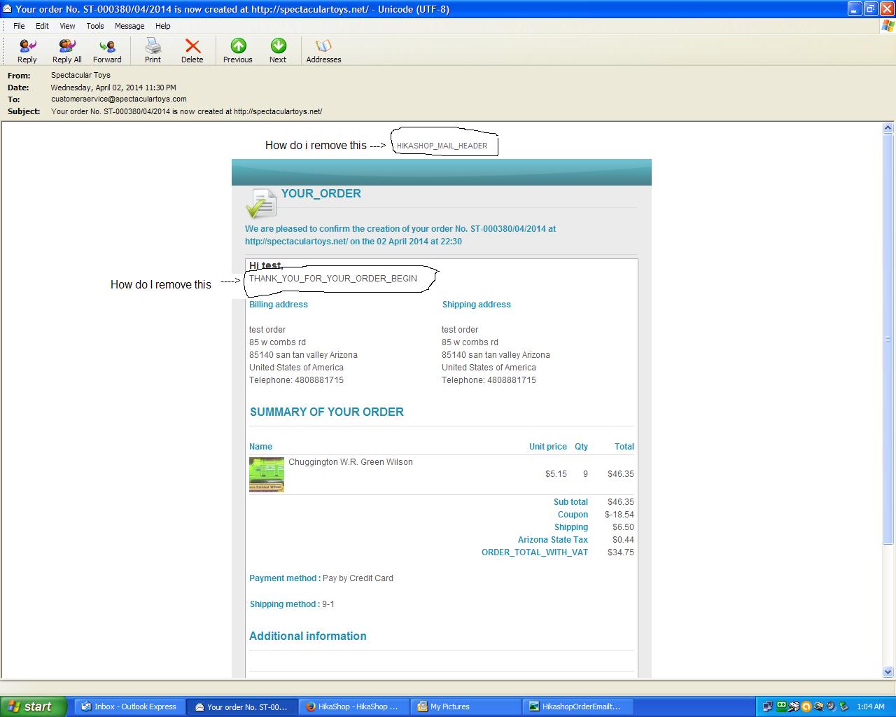

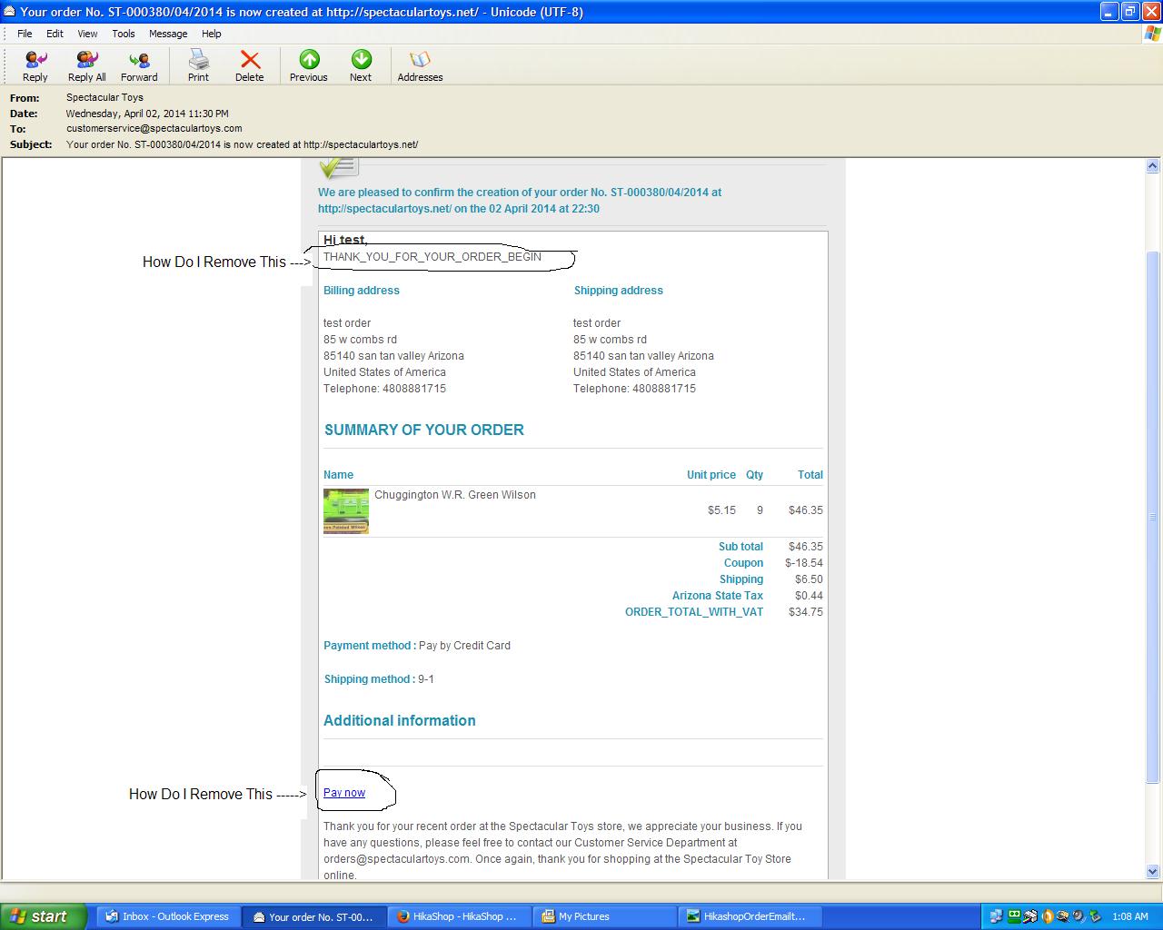

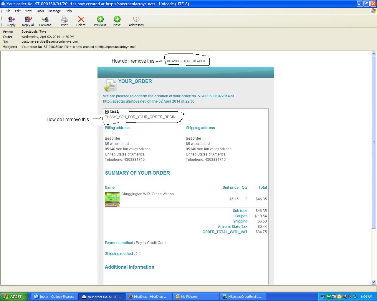

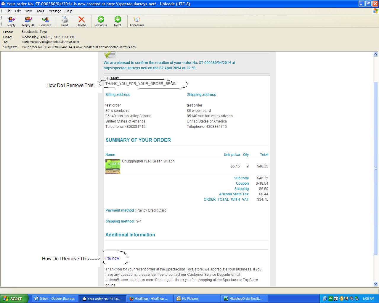

I just had my cart updated to the most recent version and when I did a test order to see if everything was working, there was a problem with the order email a customer receives.
I do not have customers login to the backend, I have the cart set up so the customer checks out as a guest. When I did a test order and received the order email details, there were a few things in this email that I want removed.
First issue in question: the letter starts out with Hi , then right below that it says: THANK_YOU_FOR_YOUR_ORDER_BEGIN .
I want this part removed from the letter it doesn't look professional: THANK_YOU_FOR_YOUR_ORDER_BEGIN
Second issue in question: at the bottom of the letter it says PAY NOW and it's a link the customer can click on to bring them to the backend of my site. I do not have my customers create accounts, so I do not need them to log in. They just checkout as a guest. Plus if they have already paid, this could be confusing to them.
I want this part removed from the letter I don't need it. How do I remove that section where it says Pay Now in their Order letter they receive after paying for the order.
Third issue in question: at the very top of the letter it says HIKASHOP_MAIL_HEADER and it's a link the customer can click on to bring them to the backend of my site. I do not want that, I want to remove it.
I want this part removed from the letter I don't need it. How do I remove that section where it says HIKASHOP_MAIL_HEADER ?
I have attached images of the Order Email so that you can see what I'm talking about. Please help me to remove this so that customers do not get this information when placing an order,.
Thank you.

1. 3. The problem is probably coming from the fact that you don't have the last translation file version so the solution will probably be to edit your translation file through "Hikashop->System->Configuration->Languages", and use the "Load the latest version from our server" button.
Also note that if you really don't want these texts, the solution will be to edit the value of these translation words.
2. The solution will be to set the "Payment of orders not paid immediately" to NO through "Hikashop->System->Configuration->Main"

I really only need to get rid of the "HIKASHOP_MAIL_HEADER" , as it's a link to the backend of the sit
The solution will be to add these lines through your translation file :
THANK_YOU_FOR_YOUR_ORDER_BEGIN = " "
HIKASHOP_MAIL_HEADER = " "
