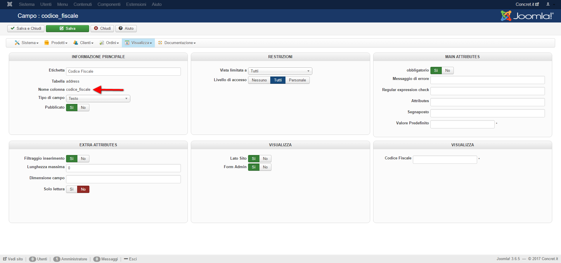

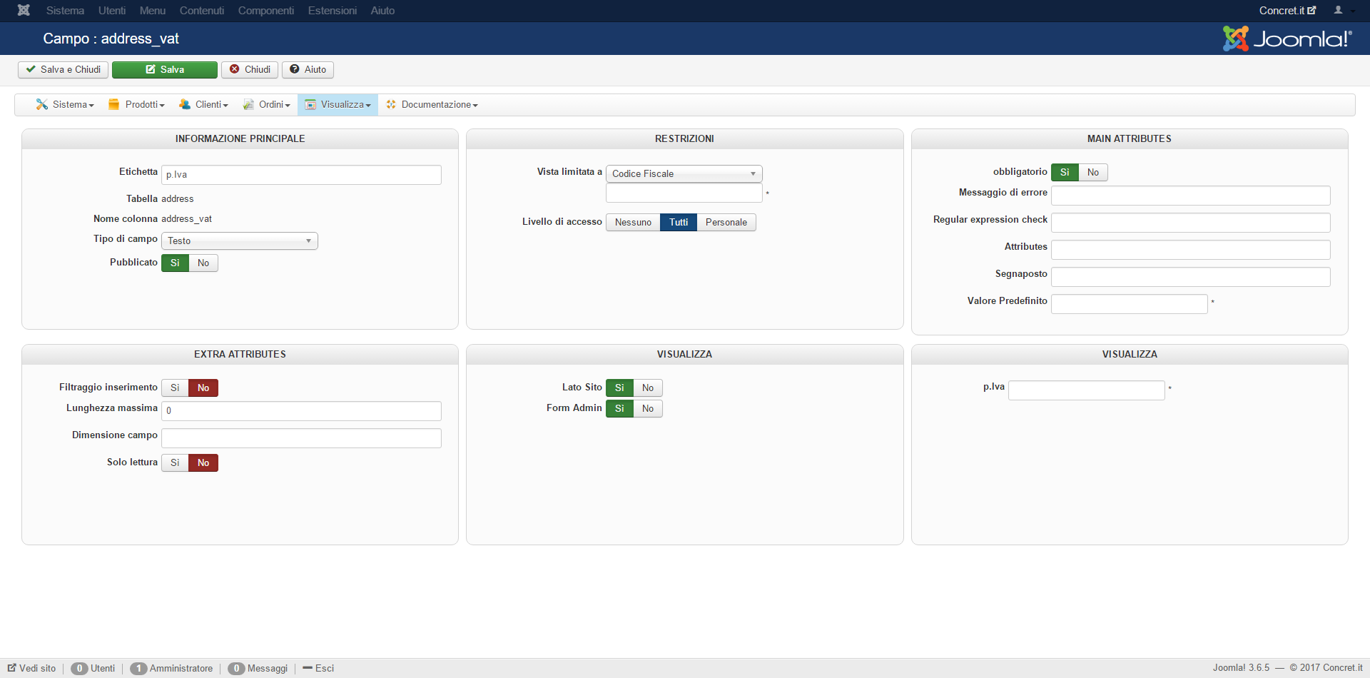

  • Posts: 33
9 years 7 months ago #260438
Hello Nicolas, I send you screenshots of the two custom fields.
But the third custom field, the one where you can choose between the individual and the company did not create, probably I did not realize you had to do it ... can you please explain to me how to set it?

  • Posts: 86102
  • Thank you received: 14203
9 years 7 months ago #260455
You need to create a custom field of the type "radio" for example, and enter two values for it.
And in the two other custom fields, you need to select the corresponding value of THAT third custom field in the "display limited to" setting.
So it's normal it doesn't work if you don't have that third custom field.
