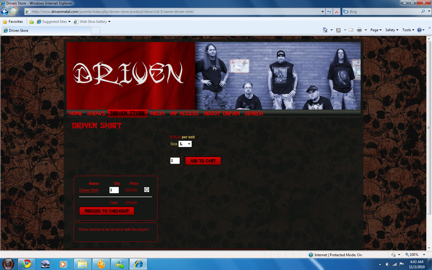

15 years 10 months ago #885
Here is a screen shot

  • Posts: 19
15 years 10 months ago #887
It looks the same as the screen shot with google chrome except that the player works there.

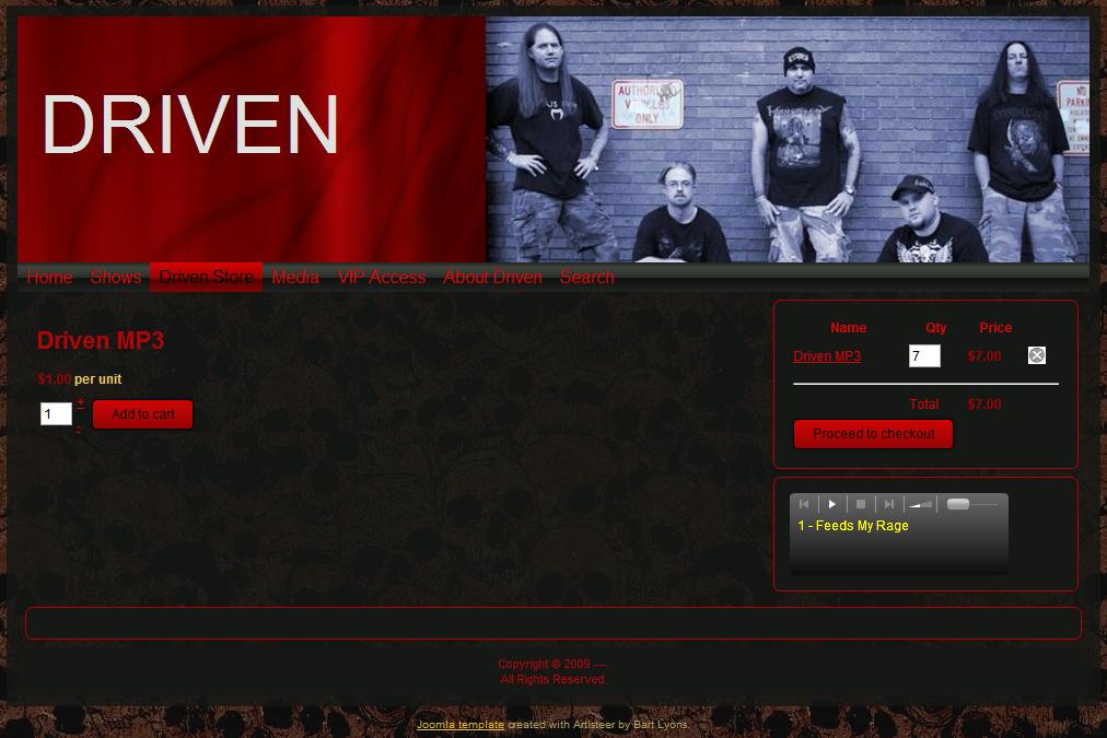

15 years 10 months ago #888
Here is what I have:

  • Posts: 19
15 years 10 months ago #890
Ok it didn't do it when i added the mp3 download your using. Try the Driven T shirt.
  • Posts: 19
15 years 10 months ago #891
Thats the only item i have Variants on atm. That help you any?
  • Posts: 86101
  • Thank you received: 14203
15 years 10 months ago #893
Yes, that's probably the problem.
I think that when there are variants and that there is no image displayed, there is a div missing an end tag.
please replace the file components/com_hikashop/views/product/tmpl/show.php with the file in the archive enclosed
