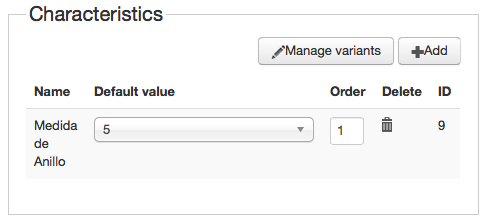

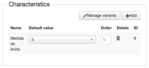

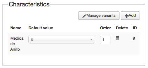

Yes, At backend, in all mass populated product pages, i can see at characteristics Panel that were added "Medida de Anillo"

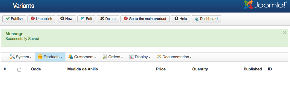

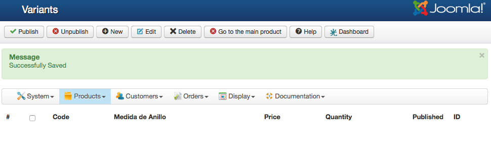

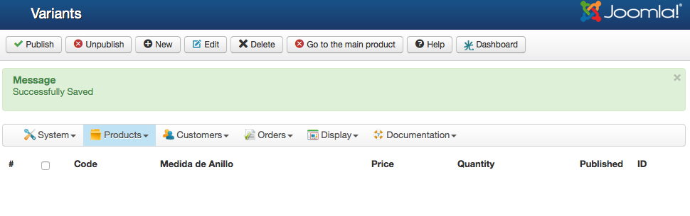

And when click on Manage Variant Products, there is nothing inside!; Is this supposed to be like this?

  • Posts: 8

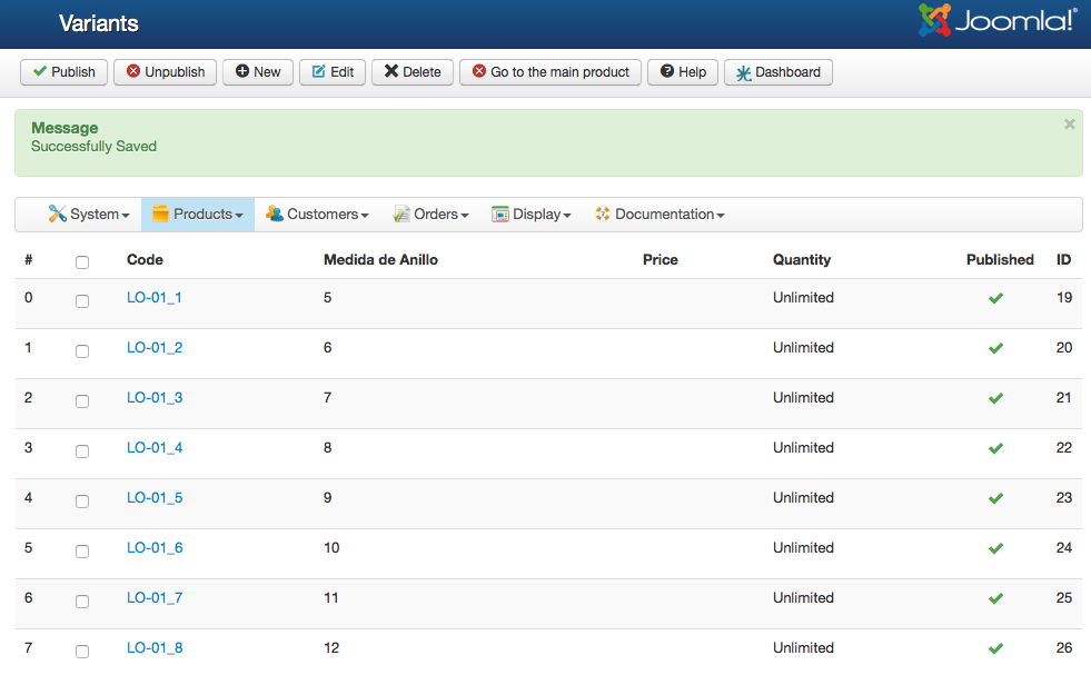

11 years 6 months ago #190540

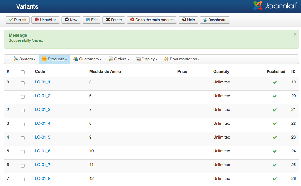

While the hand assigned product characteristics, looks like this when click on "Manage Variants" button:
