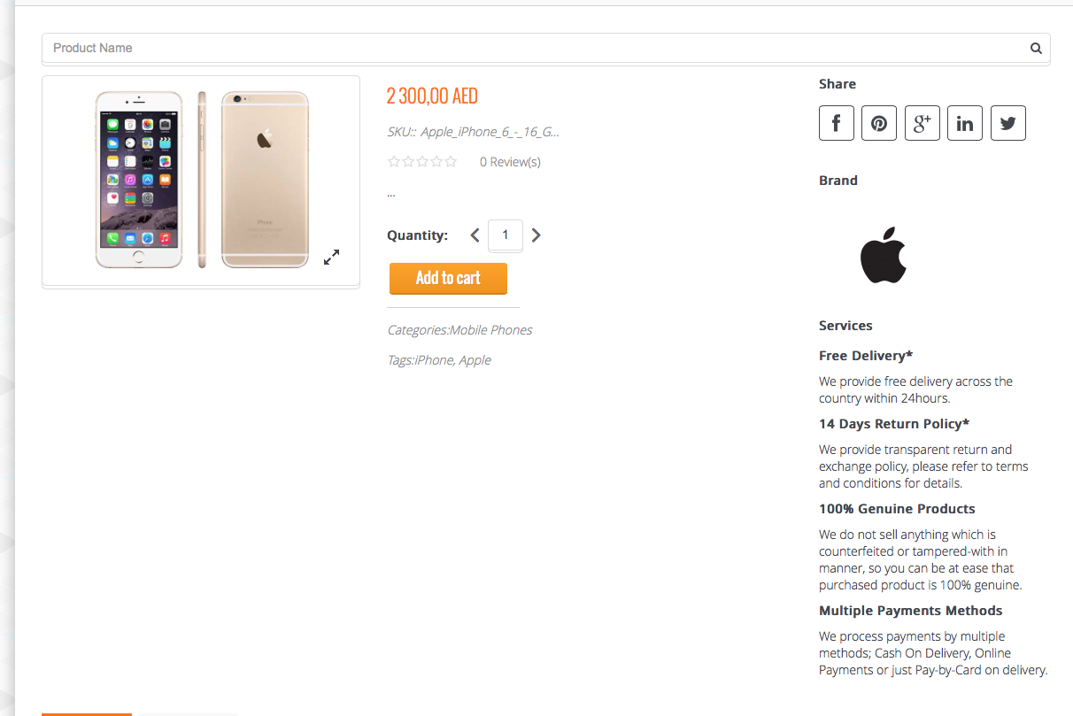

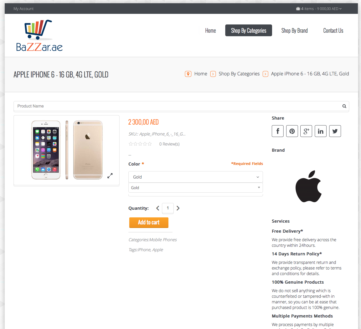

  • Posts: 125
11 years 3 months ago #201844
hello
1). I would like to change the size of the photo in the product description page. Ive tried everything it doesn't change. ( i Attached a screenshot for reference)
2). The variants ( charesterics) drop down is duplicated for some reason it shows 2 drop downs instead of one. ( I attached a screenshot)

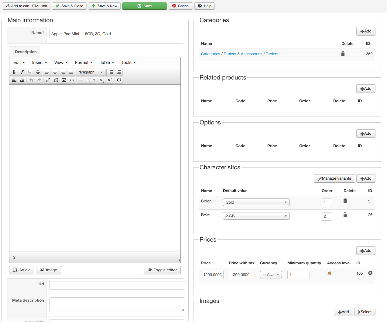

11 years 3 months ago #201855
1.
Ok, so in that case using the "Product page image width/height" options should do the job, if not, your Template CSS file is probably forcing your product image size, so the solution can be to redefine your Product image by using some CSS code : www.hikashop.com/support/documentation/1...the-display.html#css
2.
That issue is probably cause by the way you configured your product, can you show me some screenshots of how you configured your product page, especially the "Characteristics" tab ?

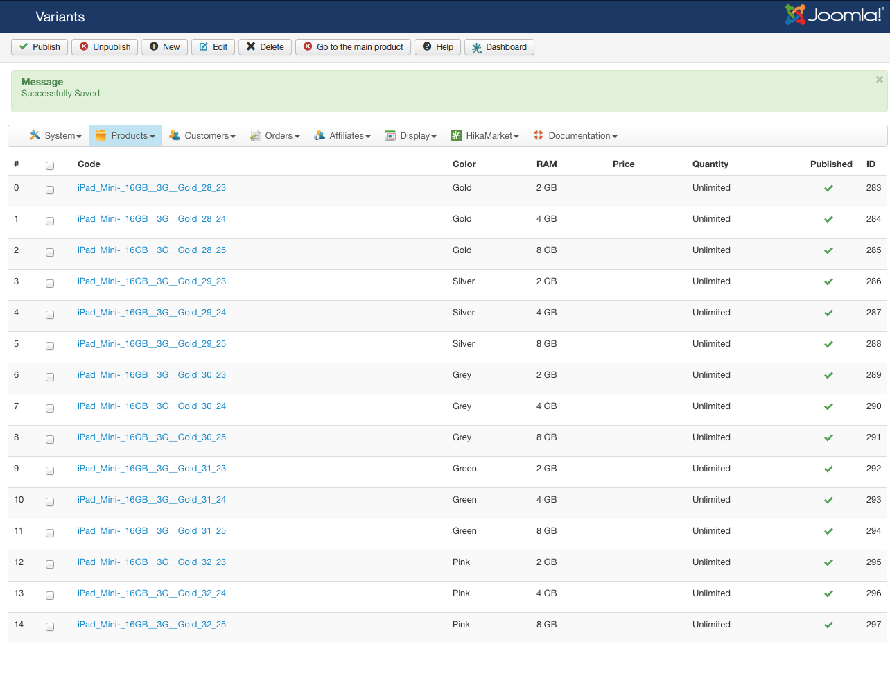

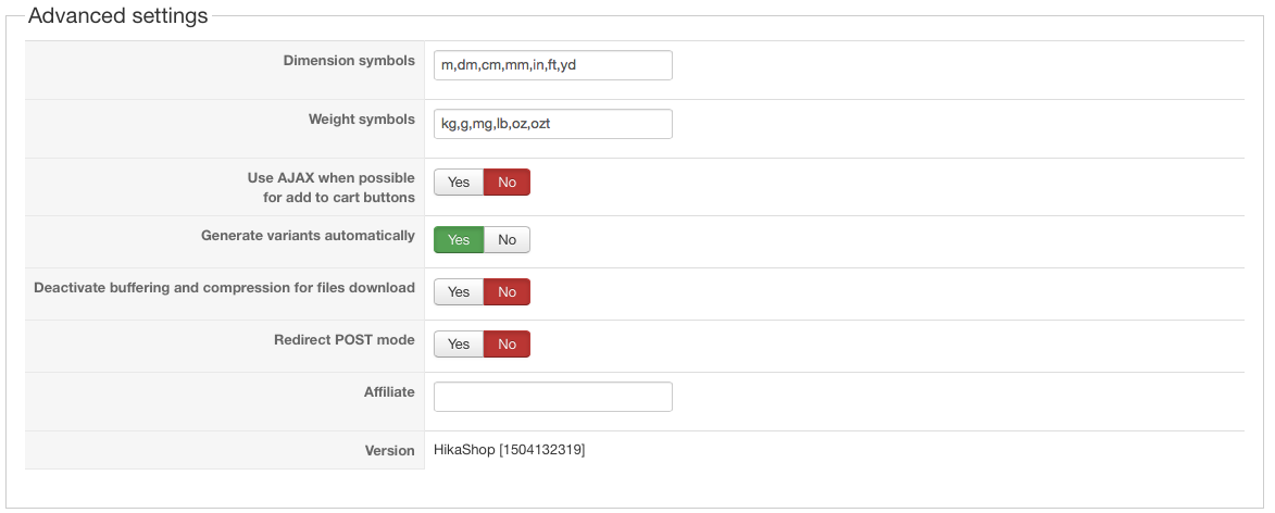

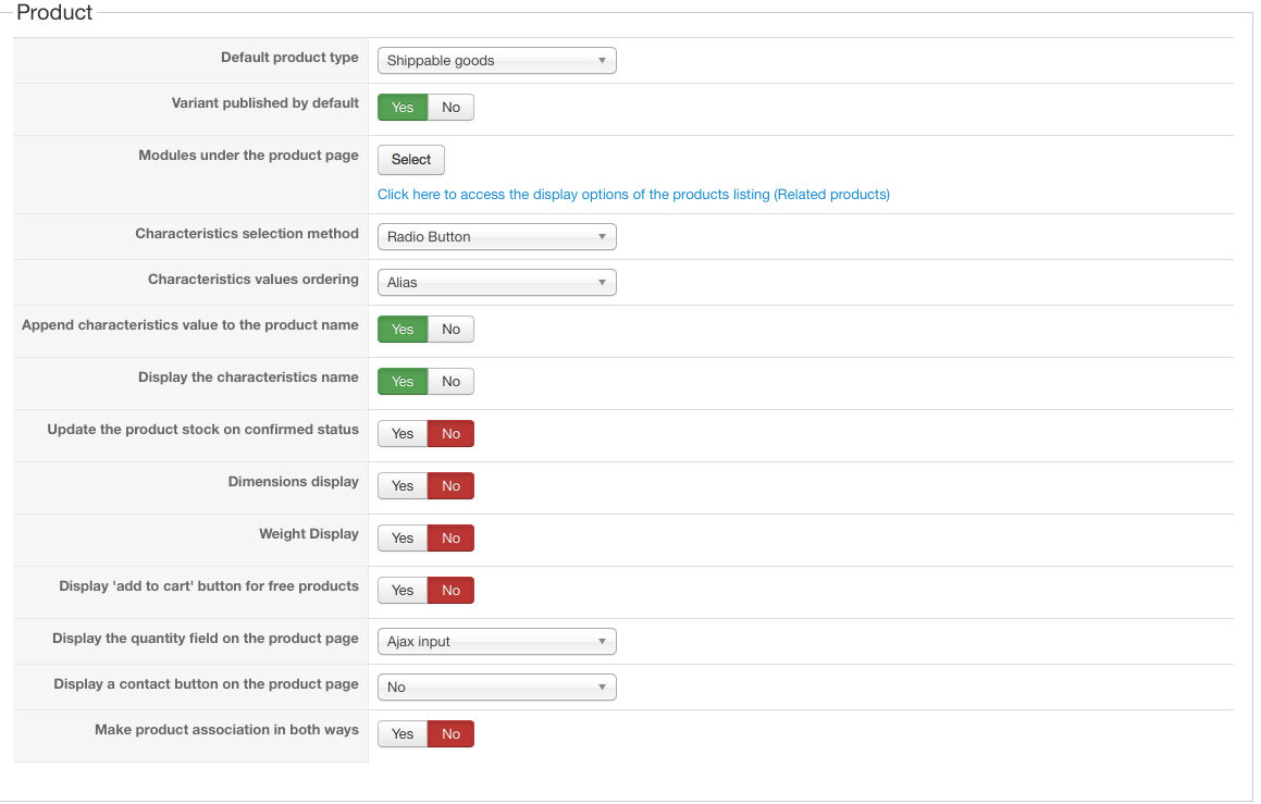

  • Posts: 125
11 years 3 months ago #201930
1. Ok awsome i managed to fix the picture issue, thank you loads!
2. Ive attached the screenshots for you to see the configuration about the charesterics.

  • Posts: 125
11 years 3 months ago #201963
Yes here they are
regards,
  • Posts: 86104
  • Thank you received: 14203
11 years 3 months ago #201983
In my penultimate message, I was talking about the product settings not the settings of the HikaShop configuration.
Could you also provide a link to that product page ?

  • Posts: 125
11 years 3 months ago #202286
Ive attached the configuration
11 years 3 months ago #202299
It seems to be a JavaScript / CSS issue. The dropdown is a HTML "select" tag, but thanks to bootstrap this is transformed into a HTML "ul - li", so the select should be hidden and only the ul - li displayed.
Please check thanks to your browser console if there is no Javascript errors, and check in the html if an element shouldn't be hidden.
A link to your website could help us to find the reason of that issue.

  • Posts: 86104
11 years 3 months ago #202702
The issue apparently comes from a conflict between the Joomla chosen library and something called "selectify" on your website (maybe from your template ?).
Try to turn off the "Use Chosen library" setting of the HikaShop configuration, as it is by default.
