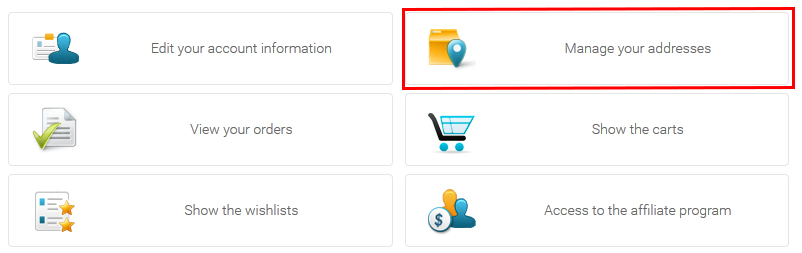

Hello, i have 2 questions.
1- I would like to remove the " manage your addresses " from the user control panel. I've tried some codes posted here in the forum but did not work .
2- How do I insert buttons ( just like this ) on the control panel ? Is there any tutorial or something?

1 - In the view "frontend / your front-end template / user / cpanel", you have to place just before
Some code to remove the buttons you do not want, like
2 - With the same kind of process, you need to add a new entry in the PHP array variable
More about customization and view overrides :
Code:
foreach($this->buttons as $oneButton) {
Code:
unset($this->buttons['address']);
Code:
$this->buttons['address'] = array(
'link' => hikashop_completeLink('address'),
'level' => 0,
'image' => 'address',
'text' => JText::_('ADDRESSES'),
'description' => '<ul><li>'.JText::_('MANAGE_ADDRESSES').'</li></ul>'

Hello
Similar problem in user / cpanel.php ...this works to remove address
but similar code does not move affiliate program button
Is their a problem with the naming ? I tried affiliates, partner, partners etc ...
thanks
Code:
Code:
unset($this->buttons['affiliate']);
thanks

There is no problem with the naming. The naming is just a number for the affiliate button.
Do a var_dump() of the $this->buttons variable and you'll see the key of each element in the array so that you can use it for the affiliate.
But if you don't need the affiliate button, then maybe it means that you don't need the affiliate feature at all, and in that case, it's even better to just disable the HikaShop affiliate plugin via the Joomla plugins manager.

Yes. I disabled the affiliate plugin and it works. Thanks

Guys, can I ask you to give me a sample code please? Unfortunately I don't know php, and it's quite difficult for me to make it correct. For examle I have a link for new button - site.com/link.html and image for button site.com/image.jpg .Jerome wrote: 2 - With the same kind of process, you need to add a new entry in the PHP array variable
Code:$this->buttons['address'] = array( 'link' => hikashop_completeLink('address'), 'level' => 0, 'image' => 'address', 'text' => JText::_('ADDRESSES'), 'description' => '<ul><li>'.JText::_('MANAGE_ADDRESSES').'</li></ul>' ); foreach($this->buttons as $oneButton) {
11 years 1 month ago - 11 years 1 month ago #217484
by Xavier
Replied by Xavier on topic Remove button from the user control panel
You can use that code:
For the image, you will have to add an image in the folder "media/com_hikashop/images/icons" and name it like: "icon-48-image.png"
Code:
$this->buttons['mybutton'] = array(
'link' => JUri::base().'/link',
'level' => 0,
'image' => 'image',
'text' => JText::_('MY_TEXT'),
'description' => '<ul><li>'.JText::_('MY_DESCRIPTION').'</li></ul>'

For this topic, the solution it is still the same, editing the view or to use css to hide them?
Last edit: 5 years 2 months ago by oxido.
5 years 2 months ago #335406
by nicolas
Replied by nicolas on topic Remove button from the user control panel
You don't need to edit the view anymore.
You can just add such CSS:
Code:
.hikashop_cpanel_address_div { display: none; }

tip: need to use !important
.hikashop_cpanel_address_div { display: none !important; }
