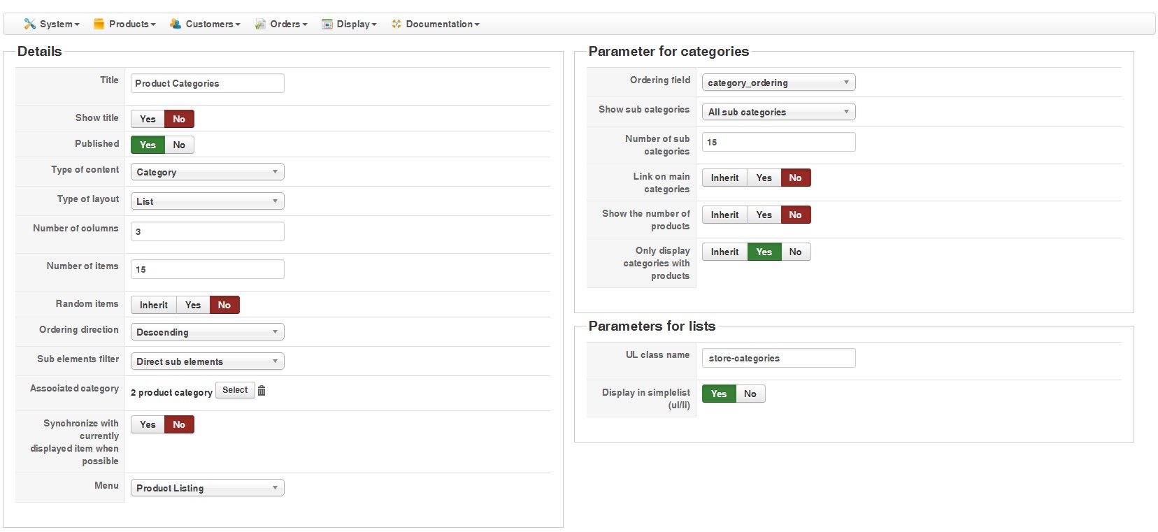

I'm having some issue with creating a module for the side-navigation of product categories.
It is functioning either one of two ways:
Under "Details" I set a "Menu" to use.
If I select a menu that is a Hikashop Category then it will only show product categories, but no actual products will ever be displayed.
If I select a menu that is a product listing, it will show sub-products, but no sub-categories.
Any way to get the best of both worlds??

You should select a HikaShop categtories listing menu in the "menu" setting of your module.
If you don't see any products when you click on a category of that categories listing menu, then it means that there is a problem with the settings of that categories listing menu. Edit it via the menu Display>Content menus and make sure that its settings are correct.
If you don't find the issue with them, please provide screenshots of all the settings of that menu item in the menu Display>Content menus and we should be able to tell you what's wrong.
