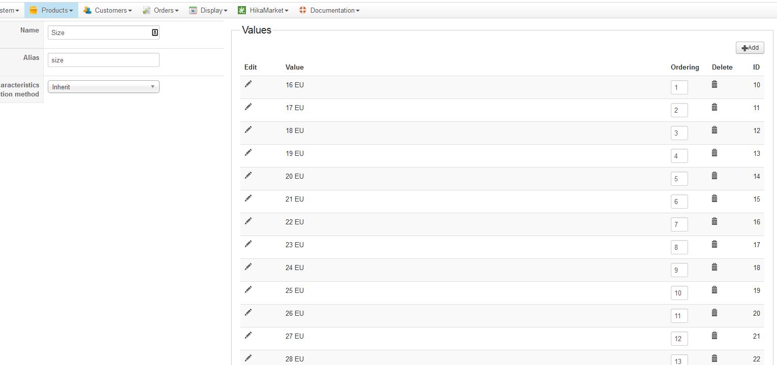

We are having quite a few challenges with one of our installations with respect to variants. They are ordering wrong on the product page in the admin section (we know how to set the order on the products configuration), we cannot get variants to copy when we duplicate some products, and so on. But we will stick with one topic at a time. And this one is that the variant ID is used rather than the name of the variant for the appended name on each variant.
To be more clear:
Our product characteristic is but a single one: size (for shoes). Our variants are named in series 16 EU, 17 EU and so on.
I enclose a screen shot of the variants. You will note that the IDs are different numbers from the sizes. As you see, 24 EU is ID 18. When we create our variants, the system appends to the main product name NOT THE VARIANT NAME, such as _24 EU as we would like, but the variant ID. So our main product name is followed by [main product name] _18 for EU 24.

After we add the variants, we manually edit the variant code for each variant to reflect the proper shoe size instead of the variant ID. Your circle screen shot of our front end reflects the proper variant code after the colon because, (as I vaguely remember), we added that to the view. The code which follows that circle, with the underscore, is what we edit in the back end before we publish the product.
Of course, that's not efficient and the client has been asking me to address that.
To ensure that I don't waste your valuable time, I did a short [unlisted] video showing the process in the admin area as I experience it. I first show you the characteristics, then add a product and the variants. You will see two things: the characteristics/variants are out of order and the added extension to the main name is _[ID], rather than _[name of variant].

It's normal that you get the characteristic value id in the product code of the variants of the product they are generated.
That's the way the system generating the variants is done for efficiency (in the MySQL queries) so that the process doesn't crash and allows you to generate hundreds of variants at once.
If you want the system to generate the variants code with another format, that's possible.
You'll have to develop a small HikaShop plugin implementing the onAfterVariantsCreation($product_id, $new_variants_ids, $element) trigger and use the variables passed to your plugin to update the variants with the product codes that you want.
