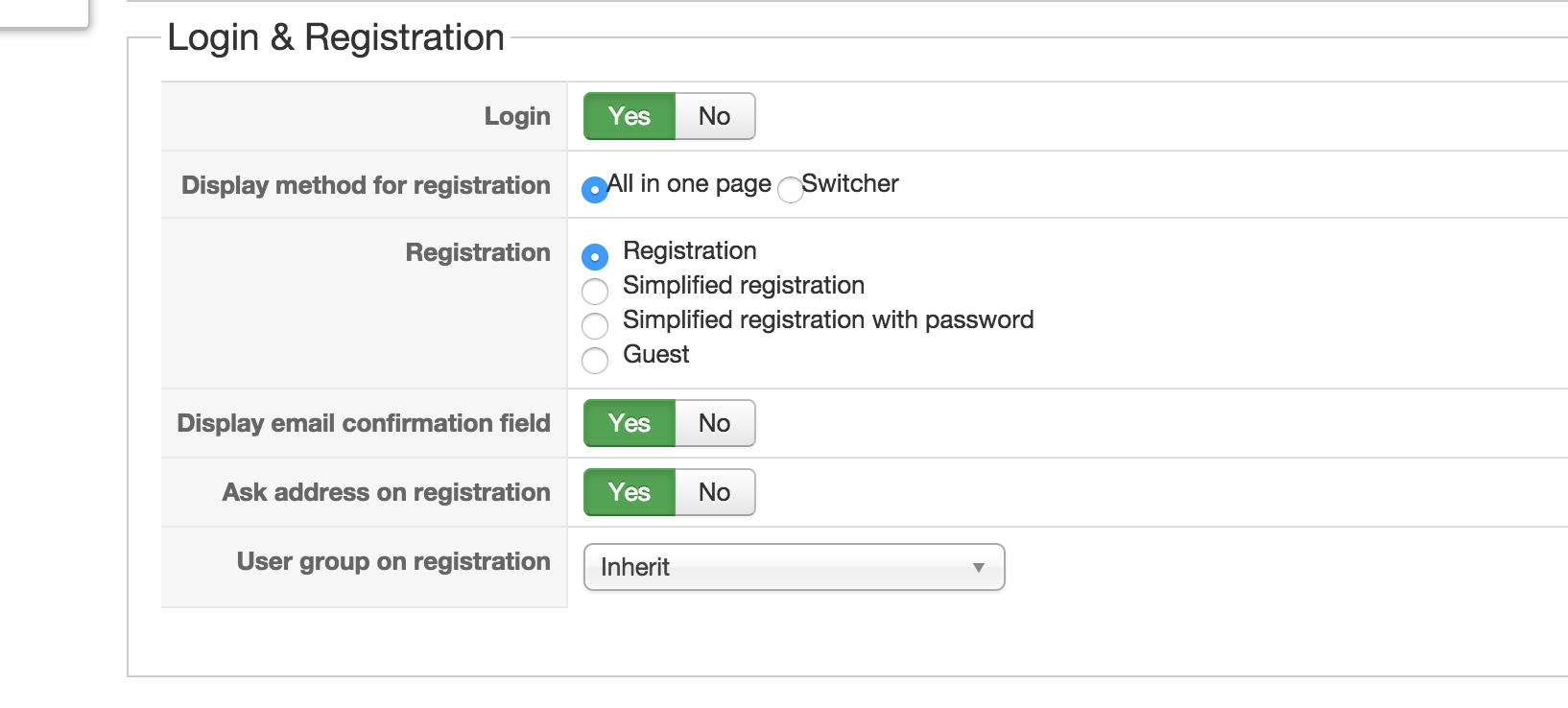

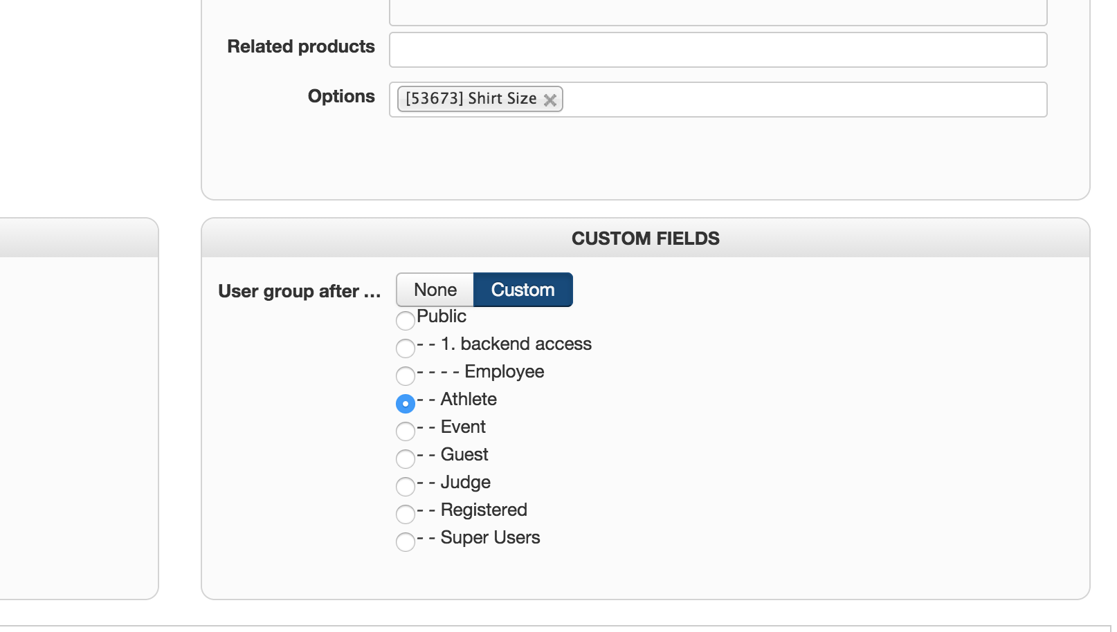

-- Joomla version -- : latest
We have a user group "athlete" which after purchase = "confirmed" has always worked just fine ... the user just needs to logout and back in and they are "athlete".
However it seems to have stopped working. We just updated to hikashop 2.5.0 in hopes of resolving the issue but it persists.
Please advise if we are doing something wrong.
A screenshot of the setting is below:
Last edit: 10 years 10 months ago by cberry1971. Reason: adding one other screenshot:

It could be also interesting to know if the product is a product with characteristics or not ; because the plugin check only the bought product and not his parent (if it's a variant).
  • Posts: 241
  • Thank you received: 5
10 years 10 months ago #212916
AHHHH you just solved it for us. Our developers have created a front end auto create of products and did not add "user group after" status to variants.. only to parent product.
Now we can make the "variants" change and everything should work fine. Many thanks.
