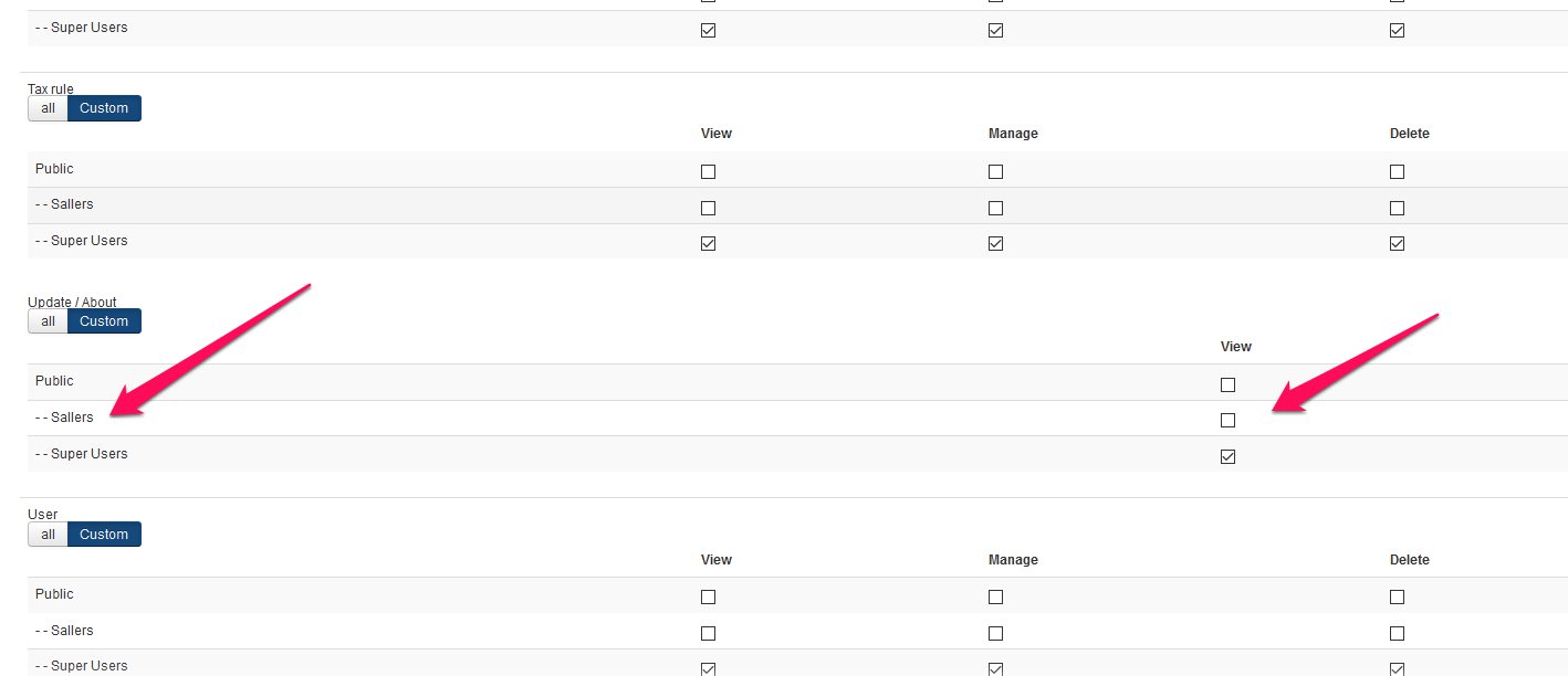

Yes. Go in the Access level tab of the HikaShop configuration, and disable the ones you don't want there:

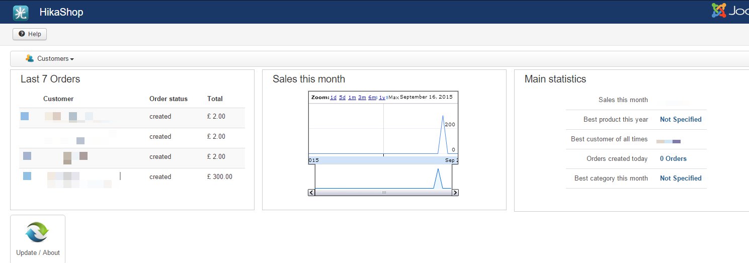

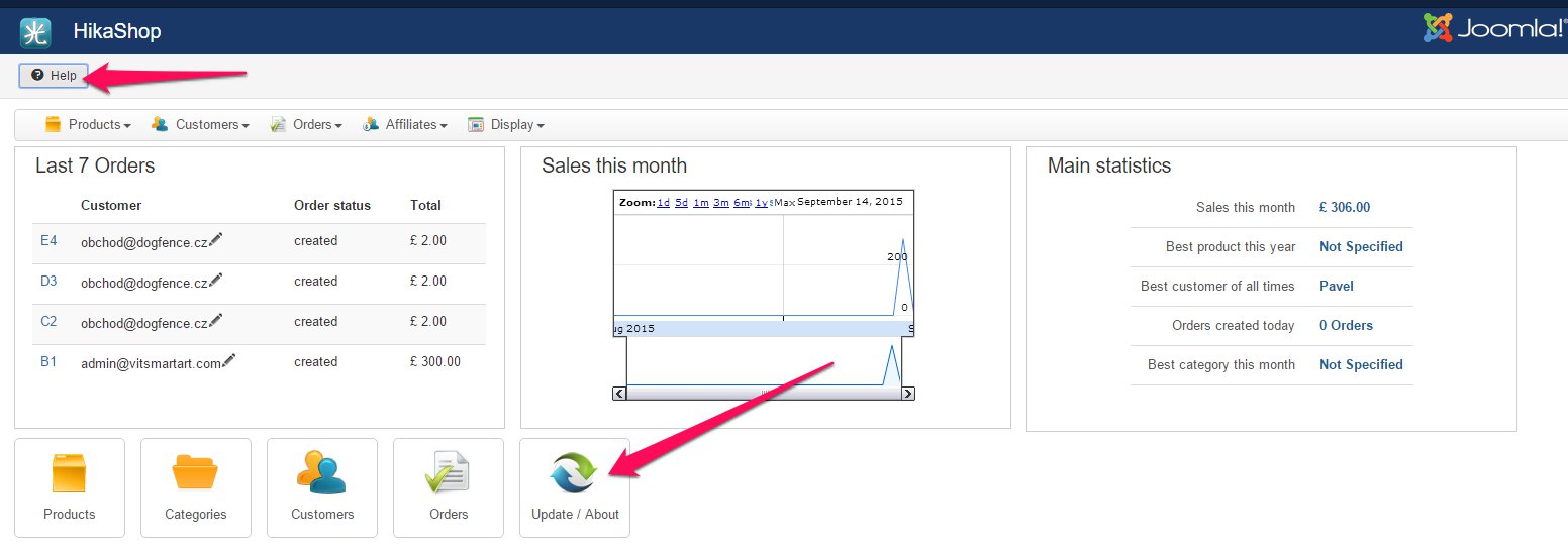

  • Posts: 30
10 years 11 months ago #214378
I know, I found this setting (see. image) but I when I log in as a user Sellers, I still see the button. I tried to turn off all the buttons in the settings Acces level as the test, but button Upgrade / About still appears. (see image2)

10 years 11 months ago #214382
Change the code acl_help_view to acl_update_about_view in the file administrator/components/com_hikashop/views/dashboard/view.html.php and that should fix that.
