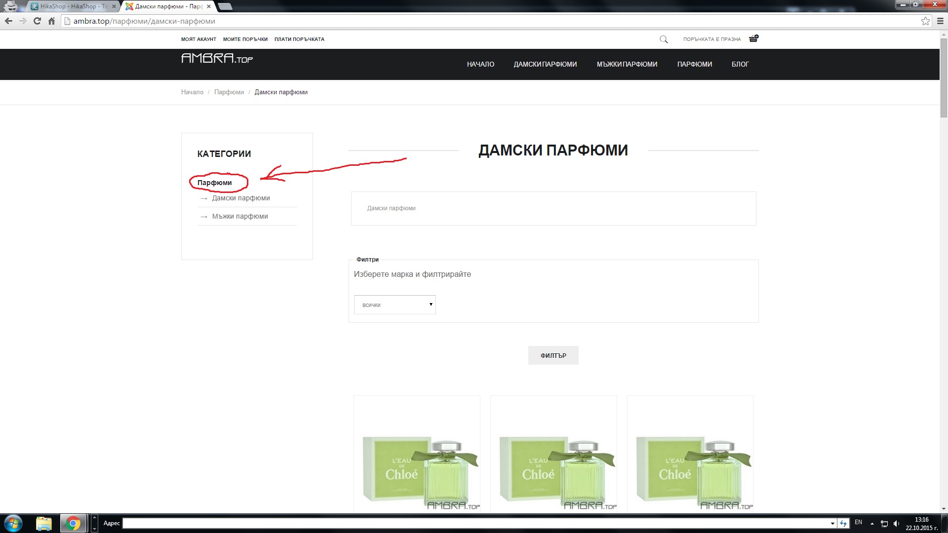

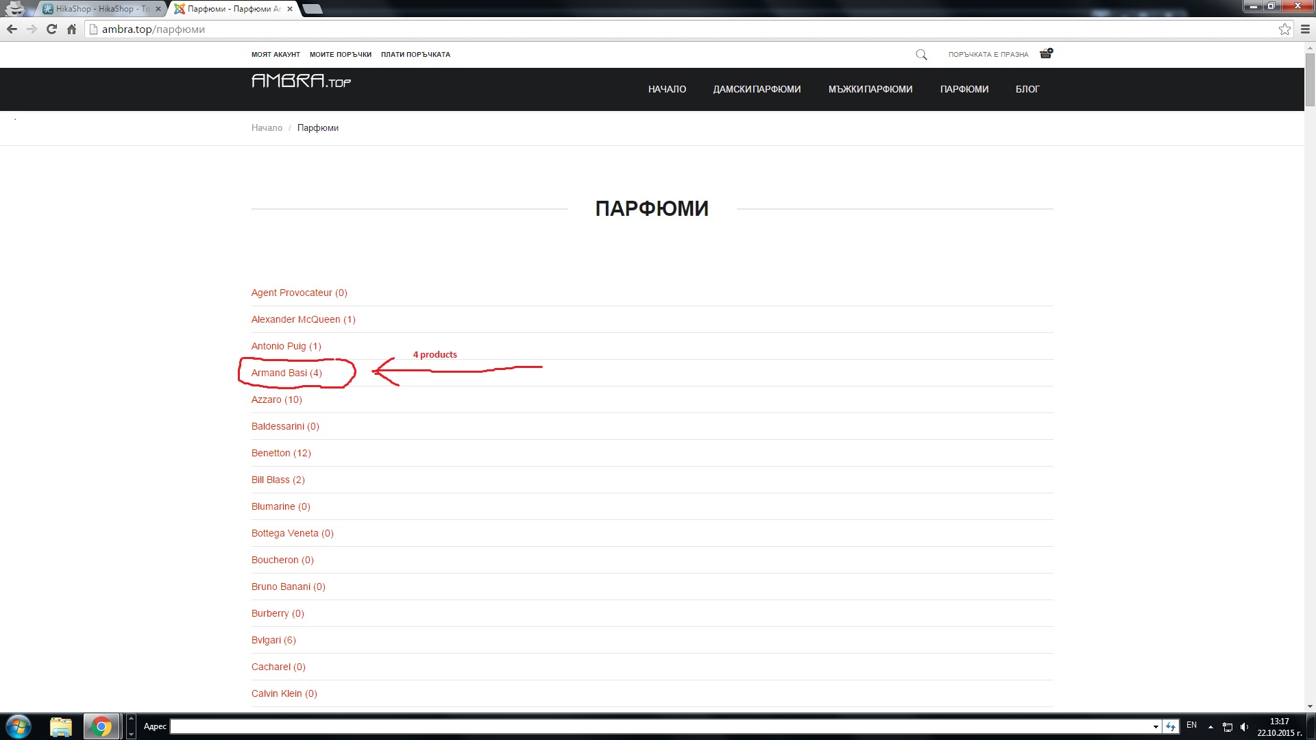

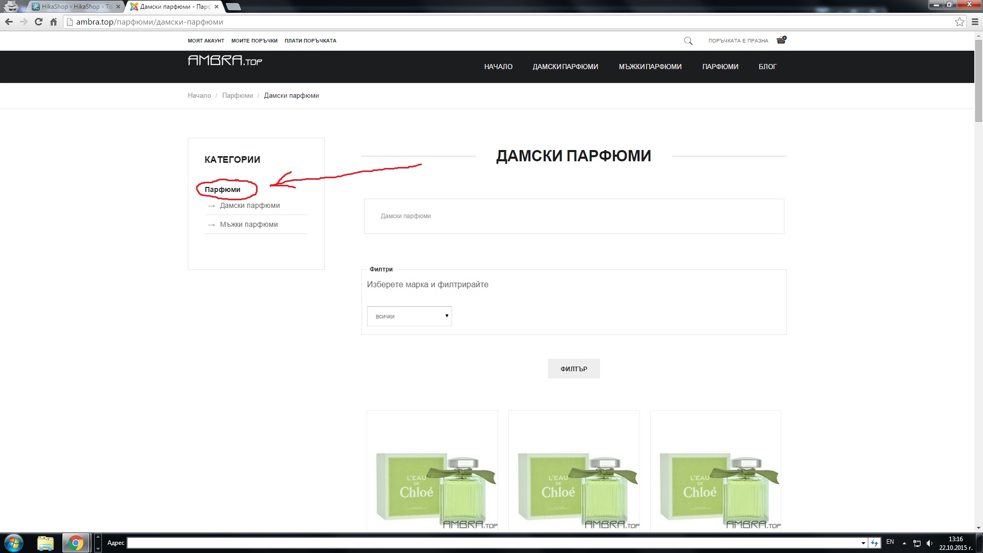

A few questions:
1 question
In the side vertical menu when clicking the perfume opens a list of categories .
What should be done then click on any of these categories to load the products associated with it ?
Now the category has a number of its associated products. How to do so click on to open these products ?
And why these categories are now lined up twice one after another :

10 years 10 months ago #217365
1. Because your category listing content menu's associated module is also a category listing, and not a product listing, you can change it by editing the content module which have the ID number 756
2. To do that you'll just have to set the "Submit on click" option of your filters to YES
3. I didn't totally understood your issue, can you give us more information about it through some screenshots for example ?

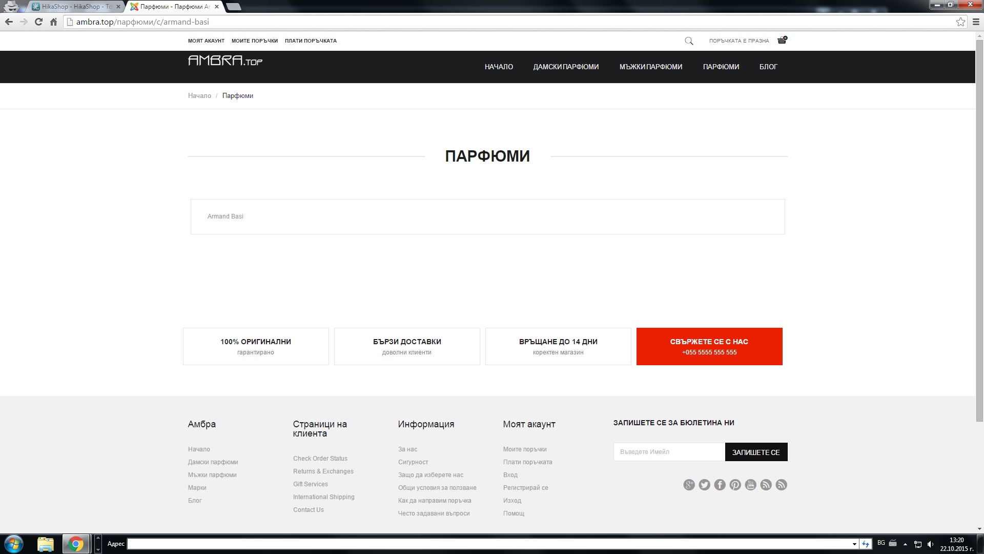

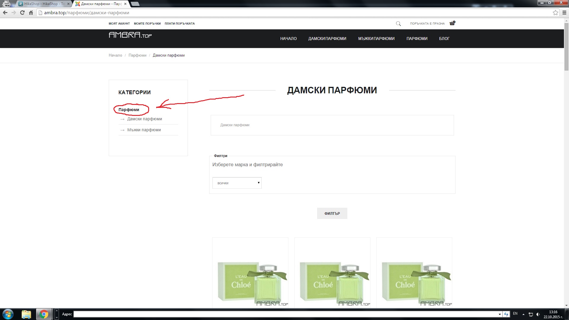

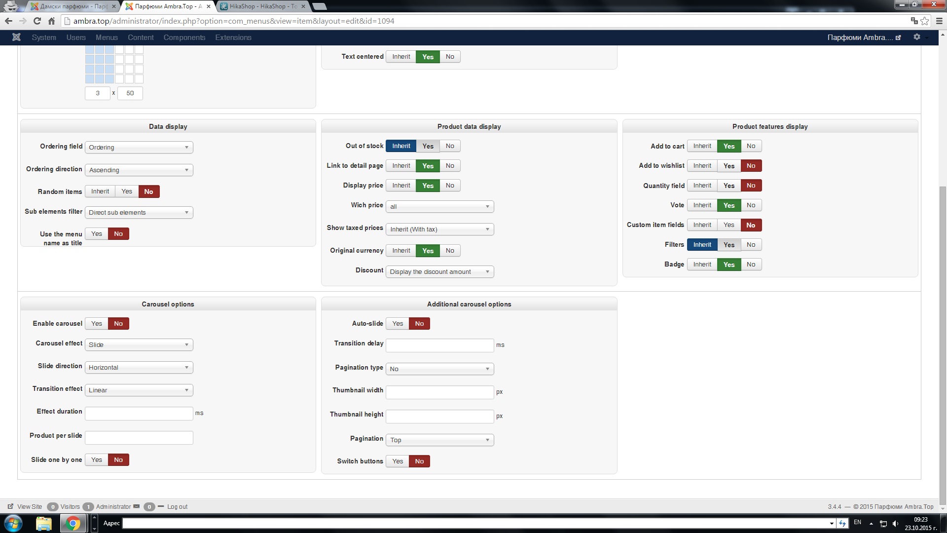

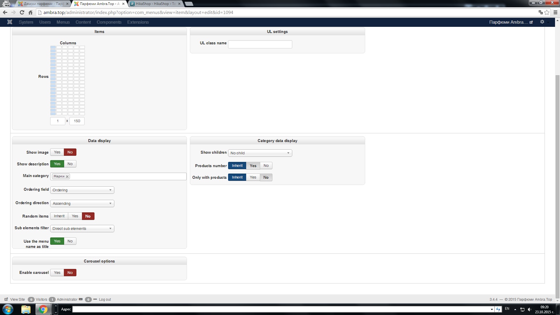

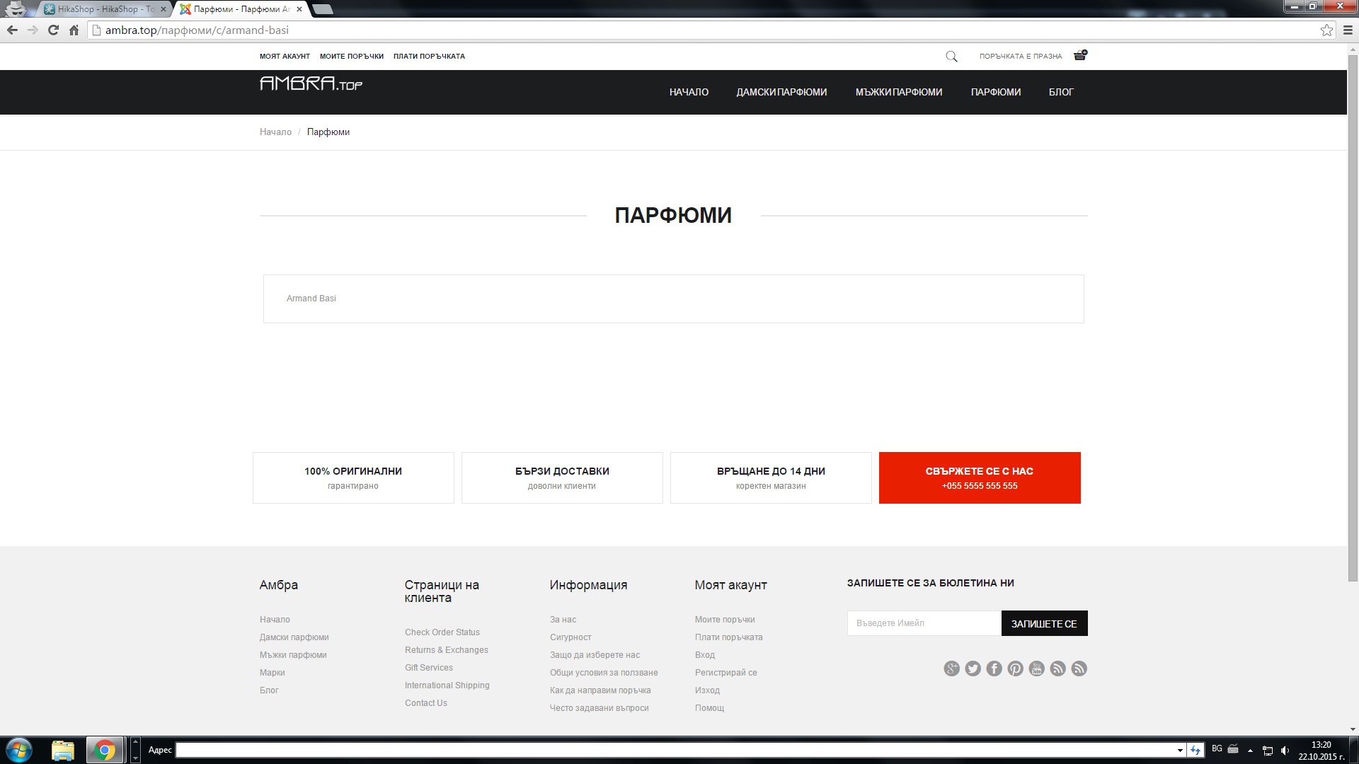

  • Posts: 43
10 years 10 months ago #218036

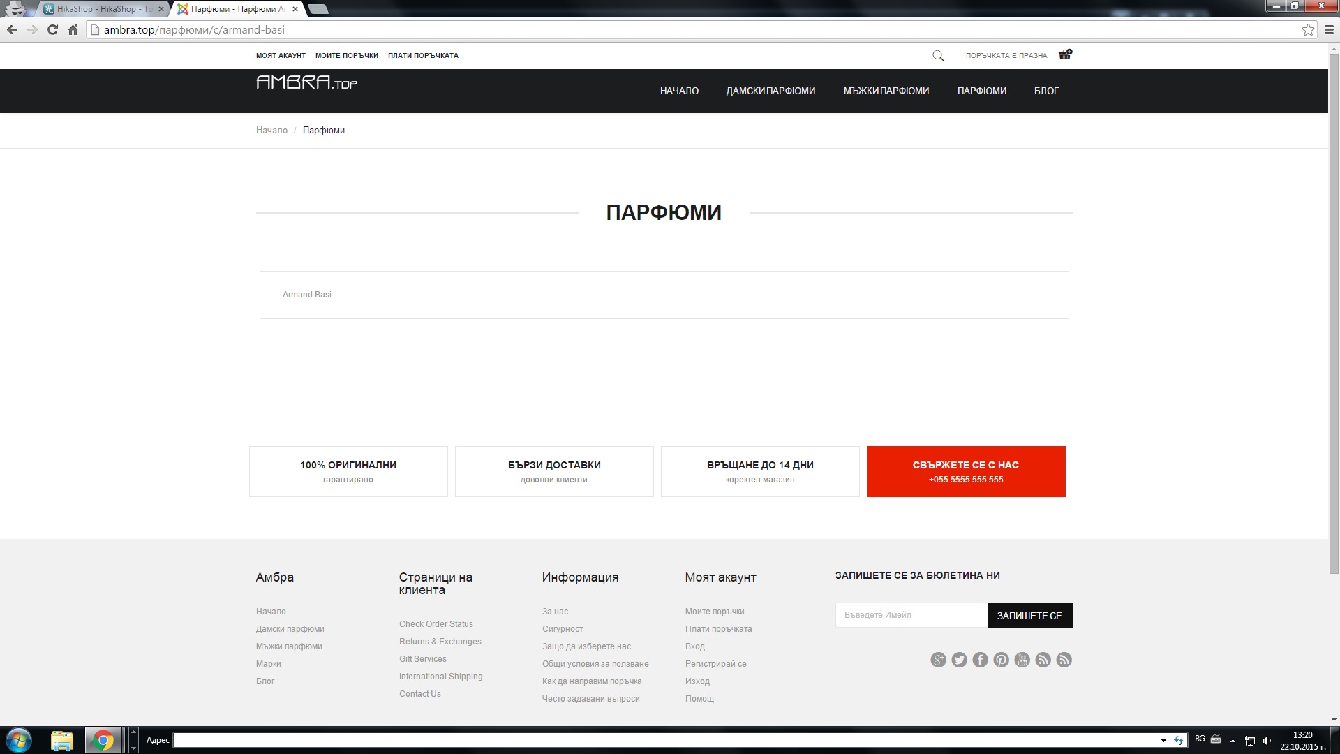

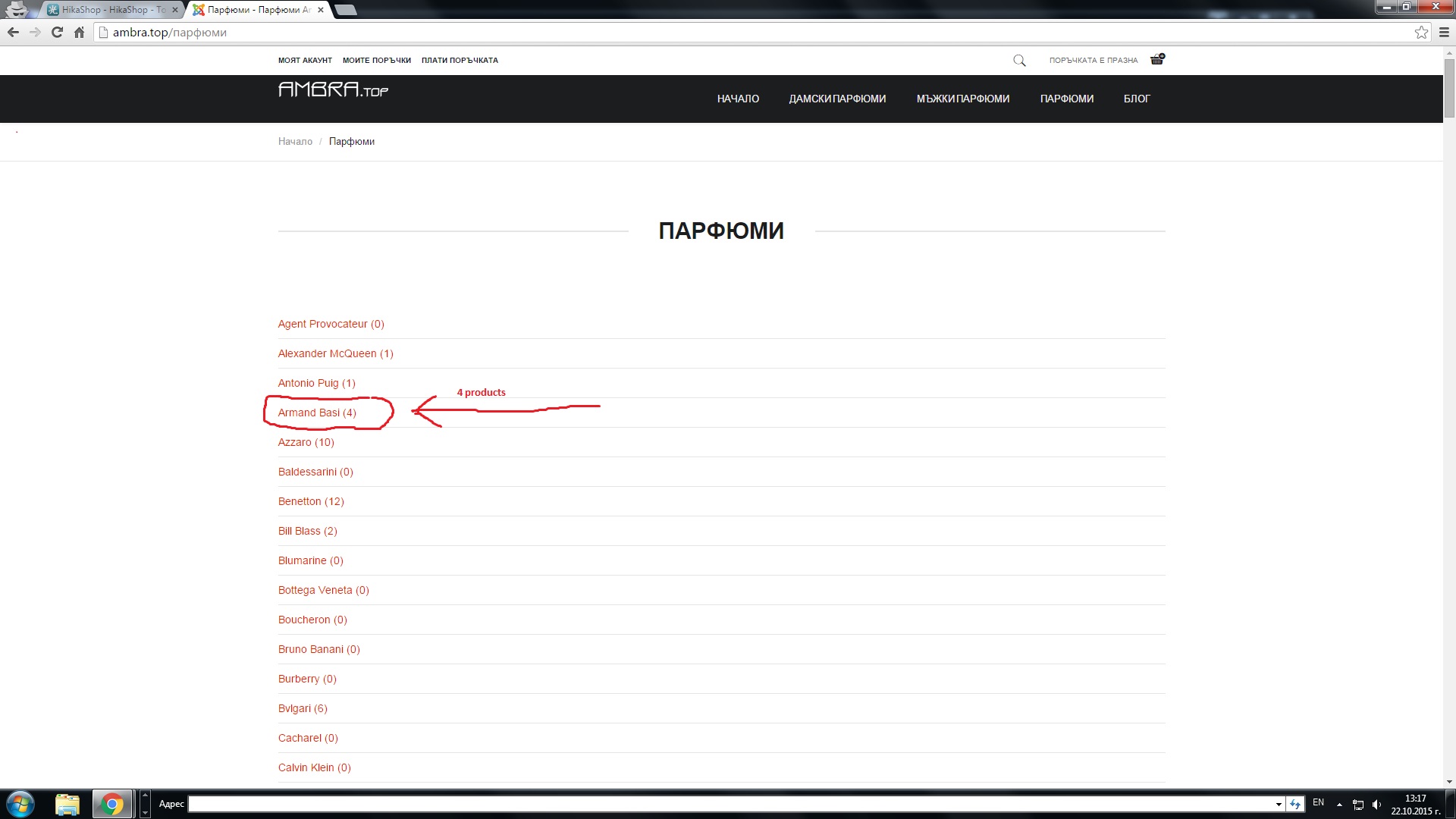

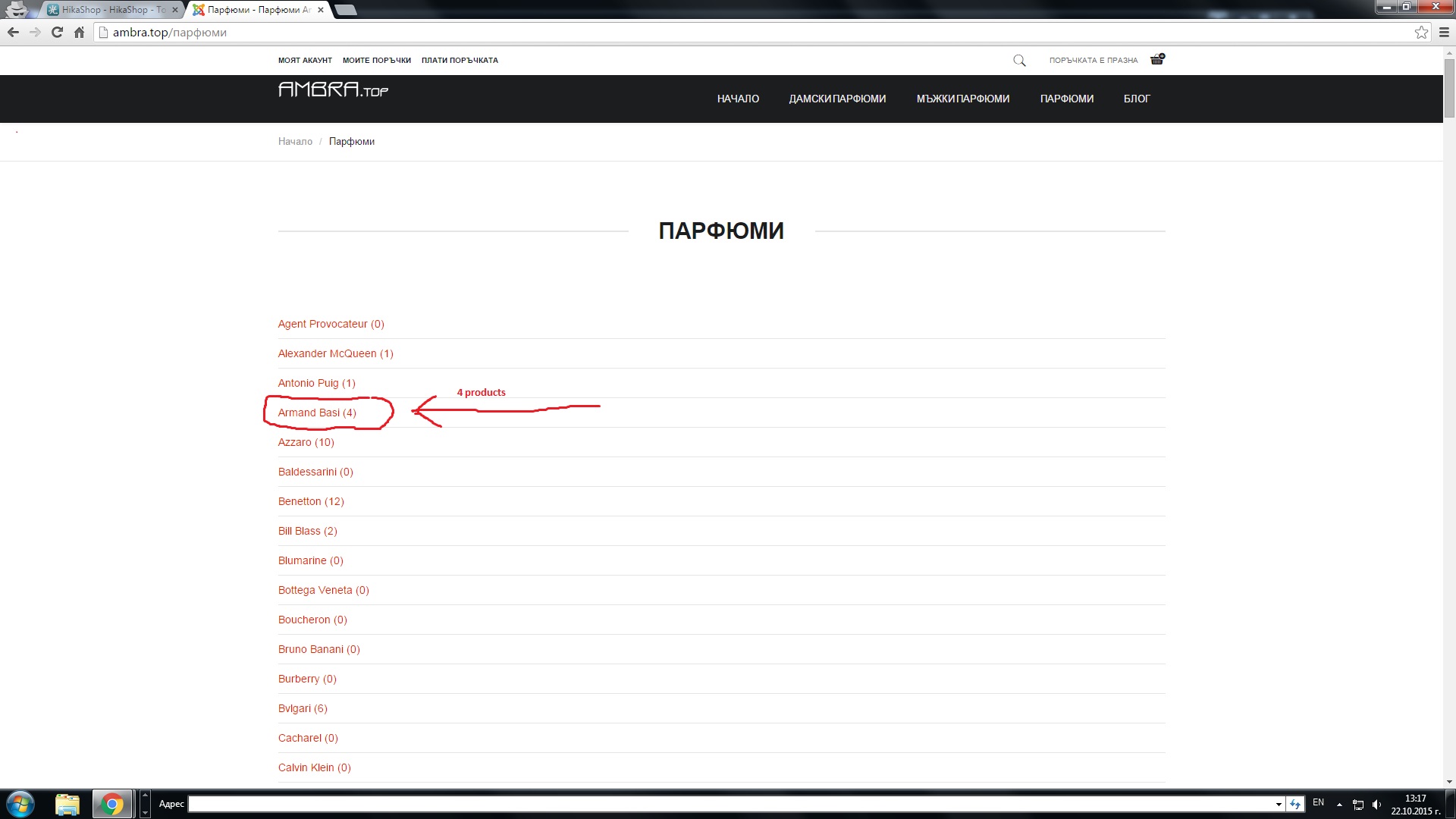

Click on the categories:
A list of categories of products associated with them:
If you click on categories do not appear in the products it:
how to fix this?
If you detailed descriptions.
the site is - ambra.top

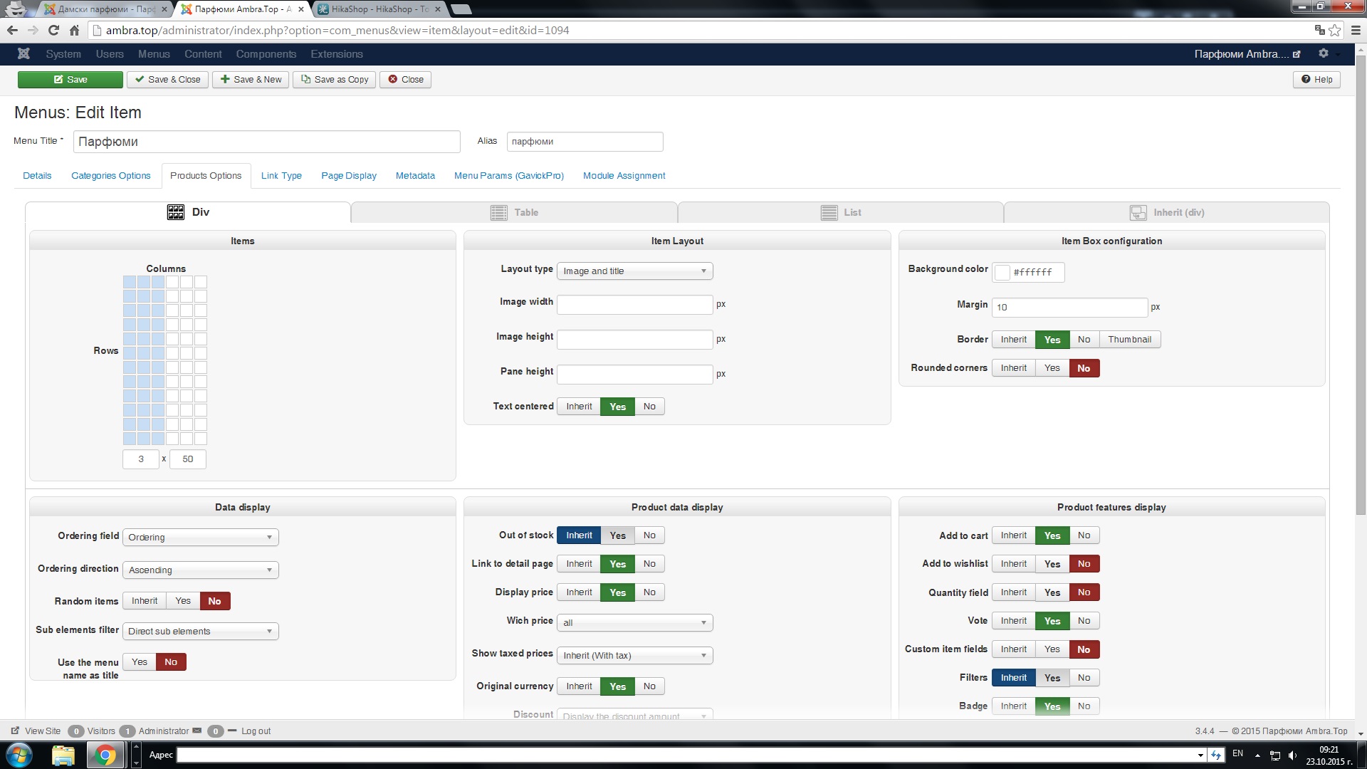

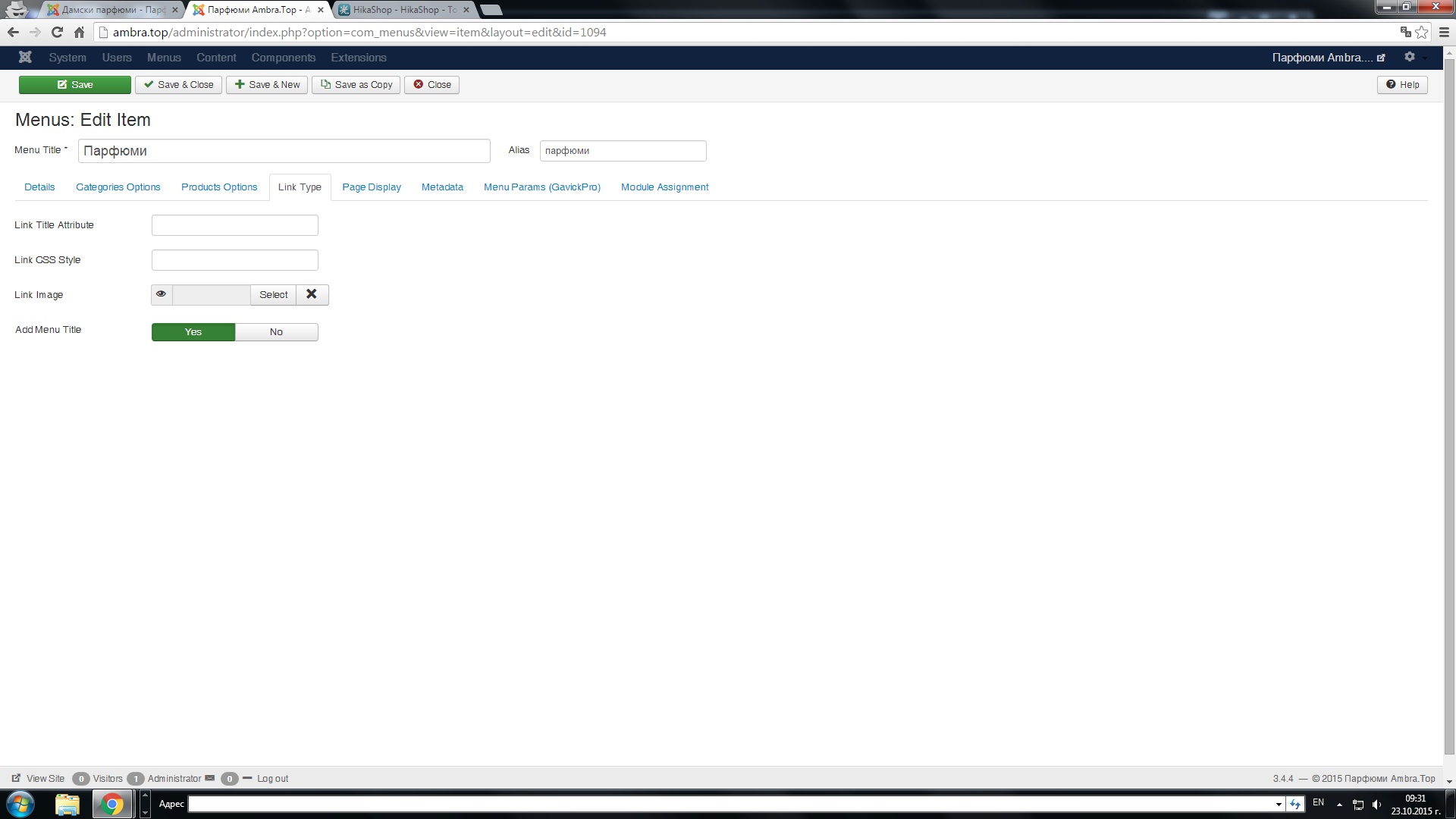

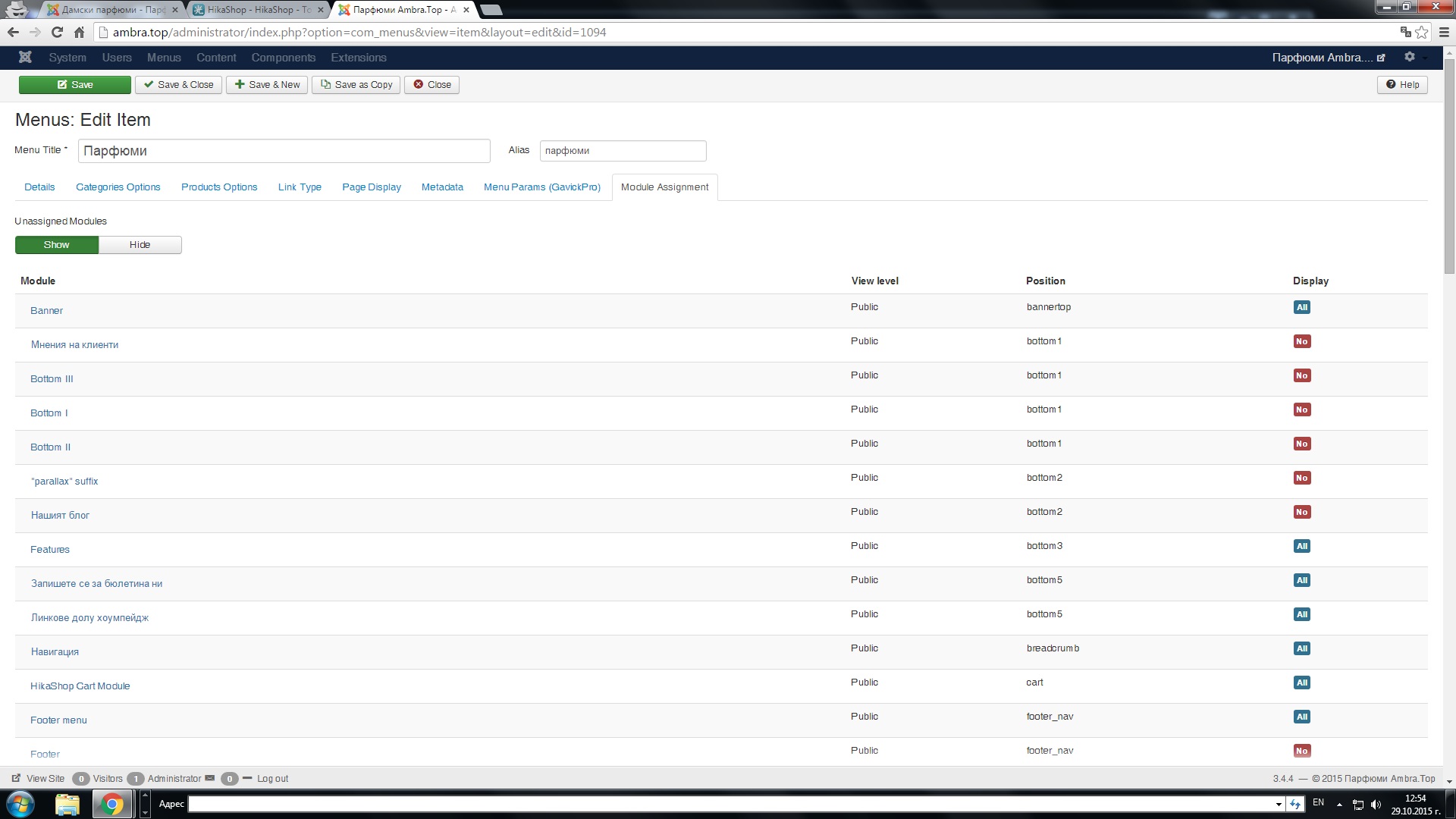

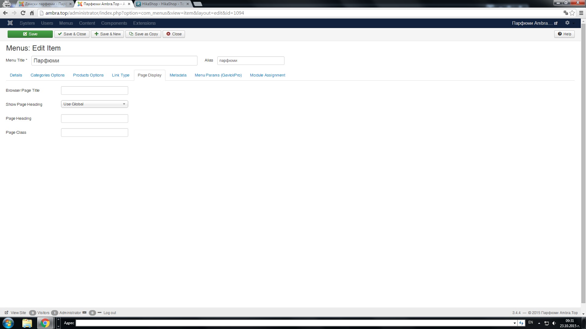

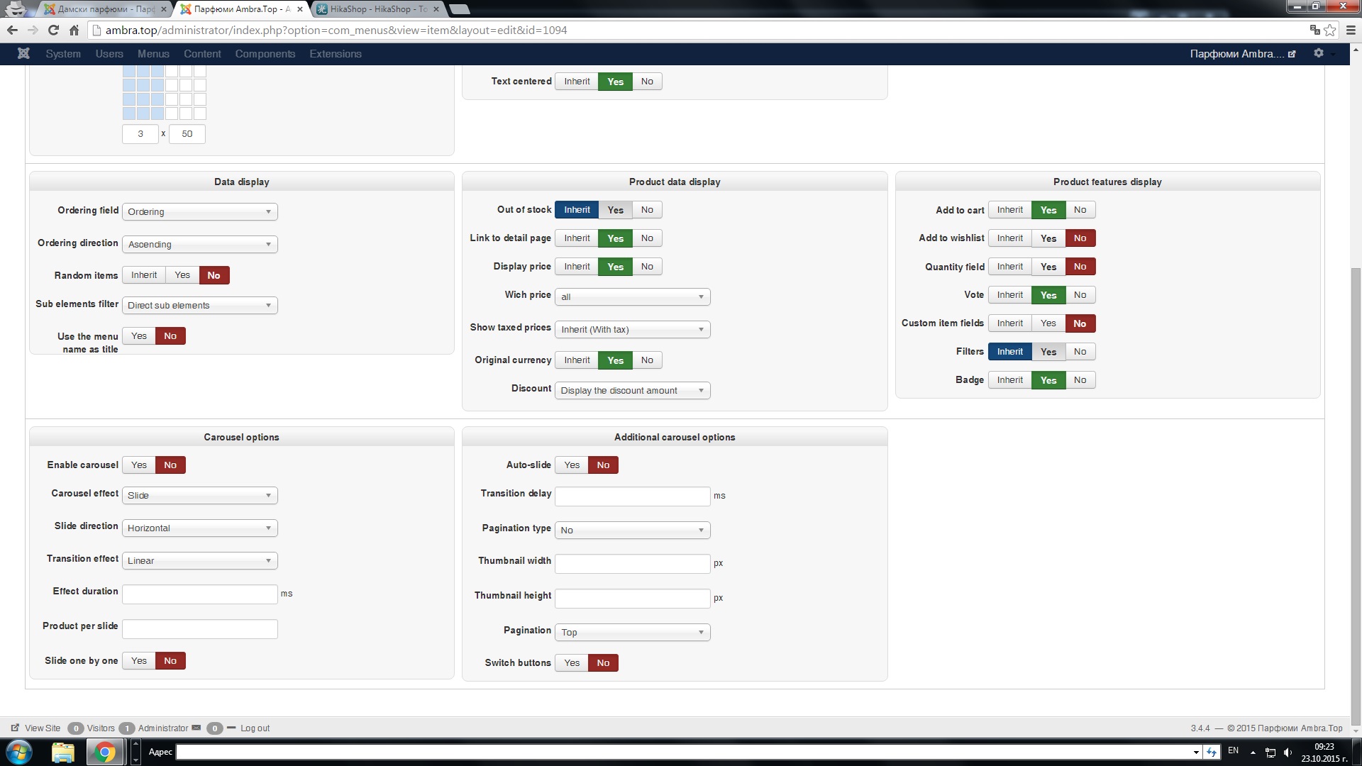

10 years 10 months ago #218043

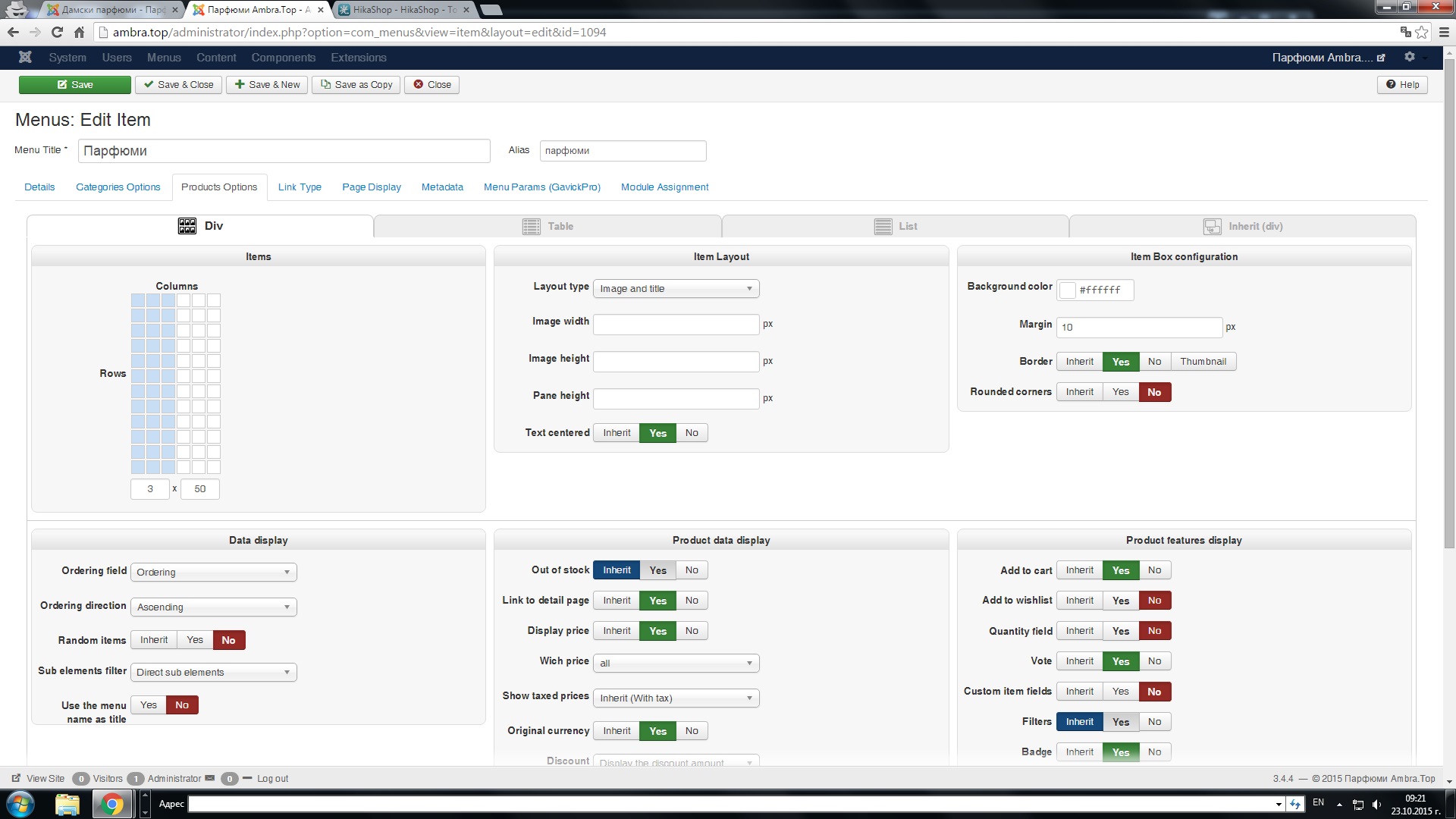

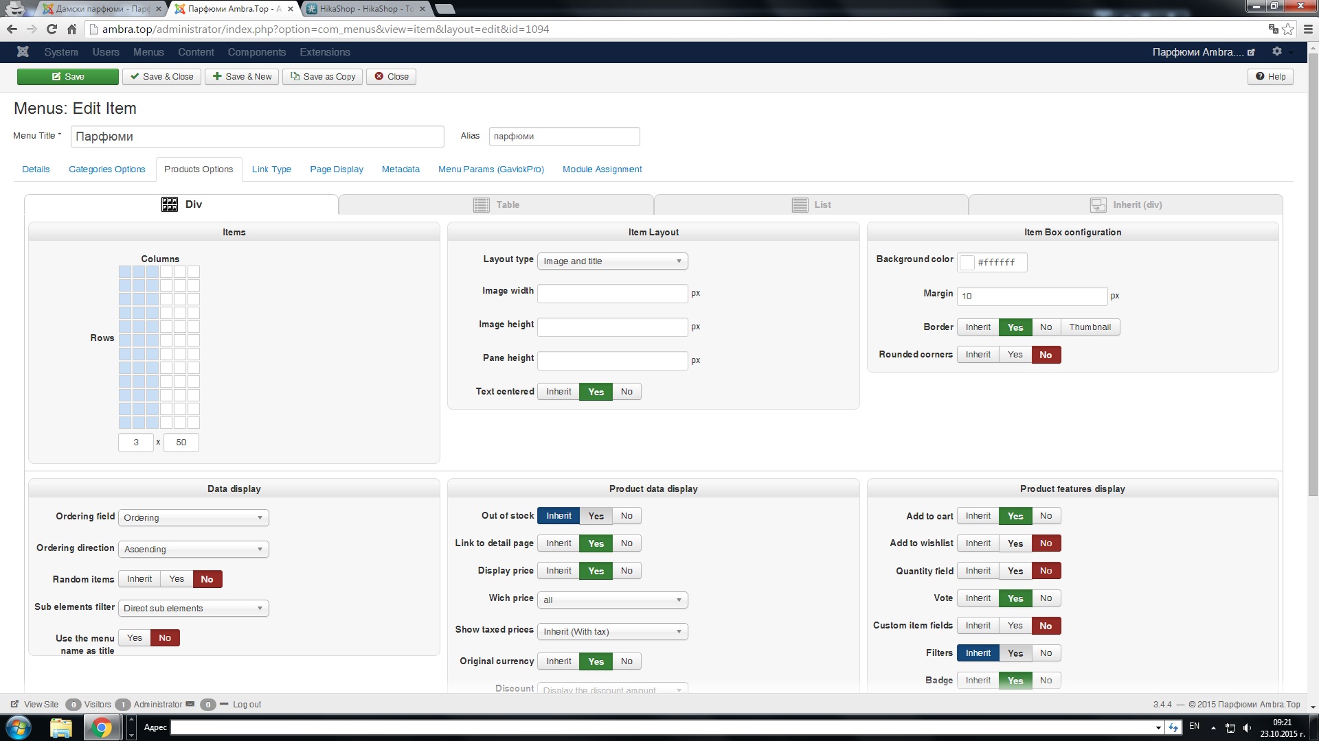

As Nicolas asked, screenshots of your settings for the menu with the alias "парфюми".
For categories and products tabs.
This will help us to analyse the problem.

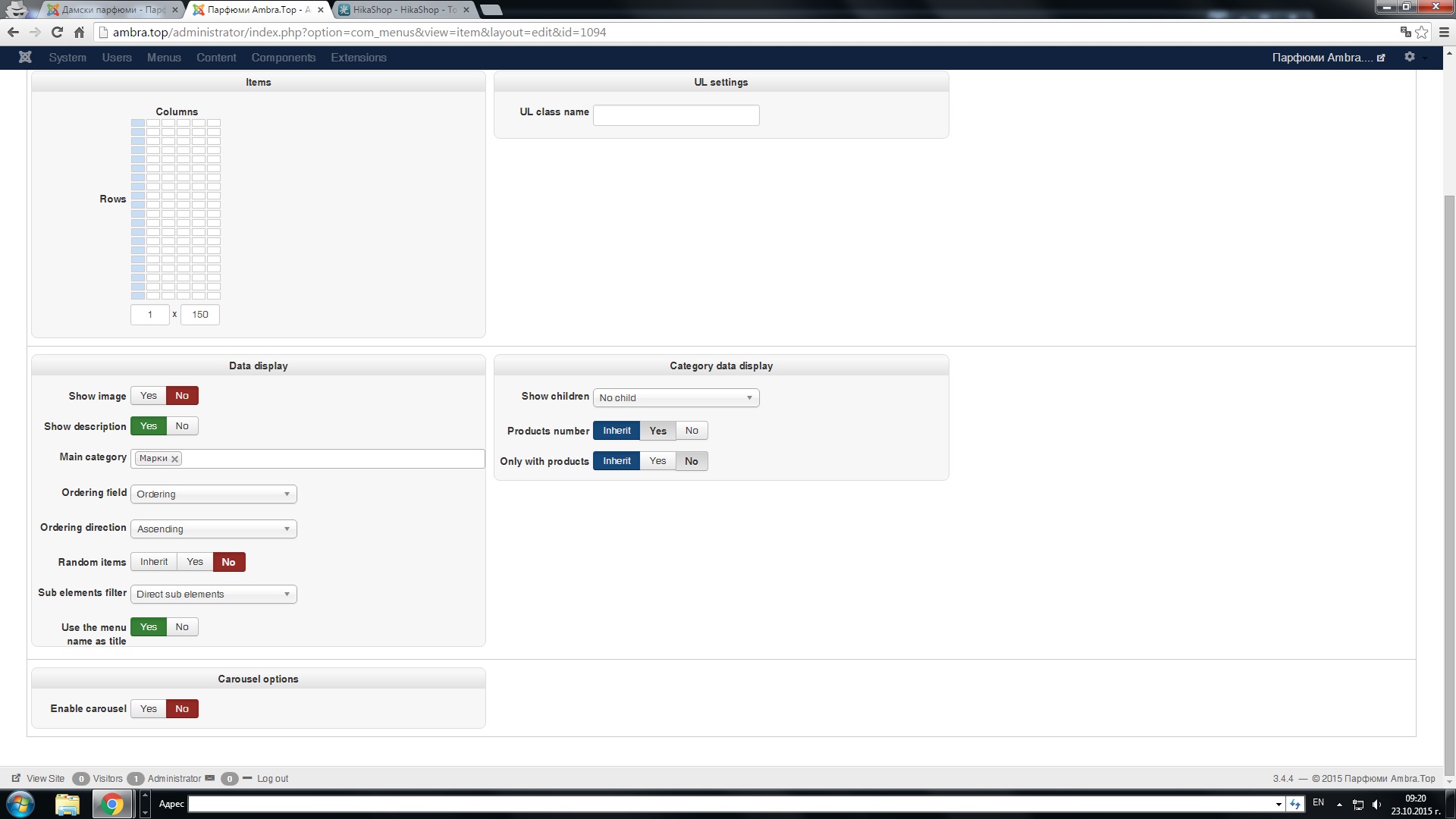

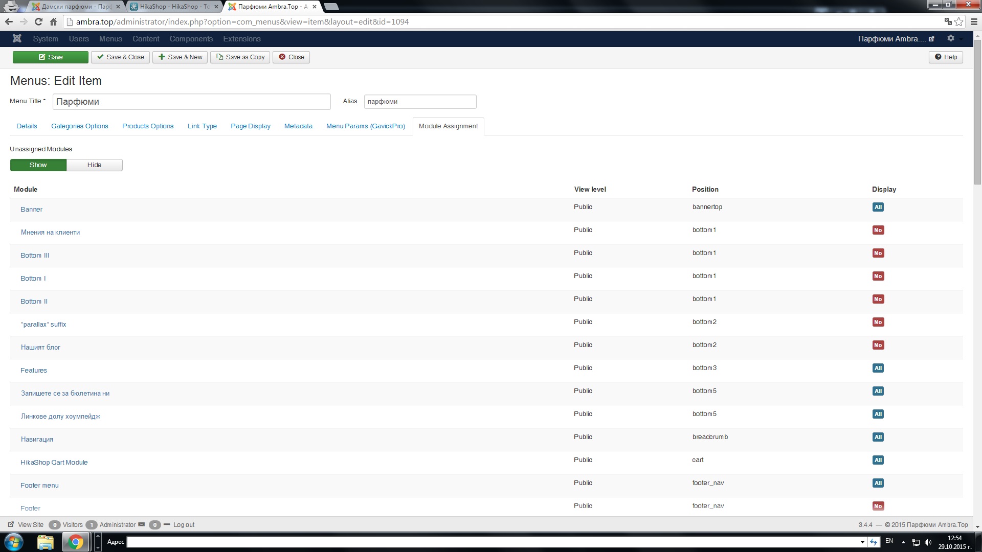

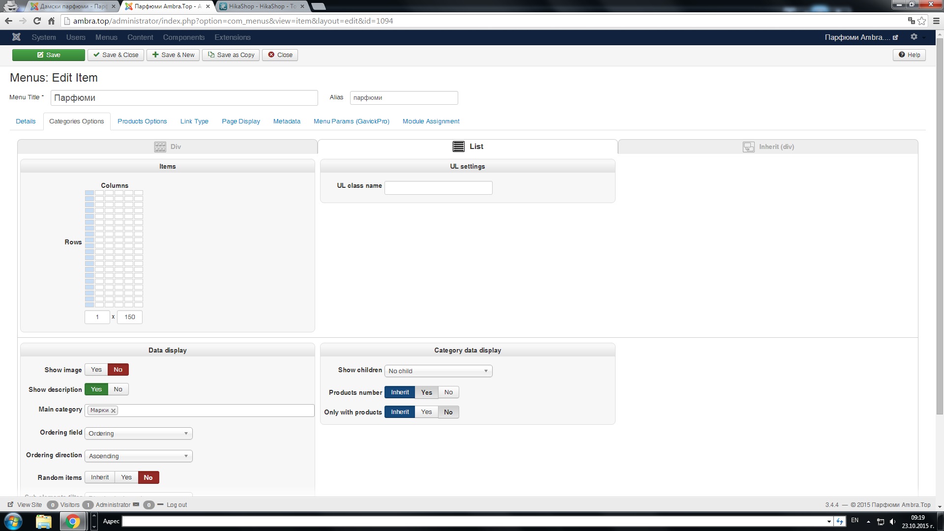

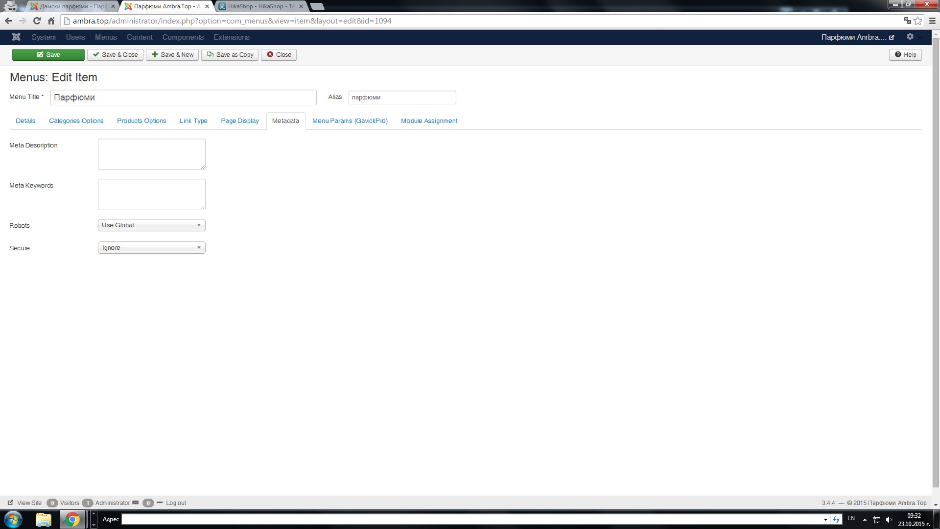

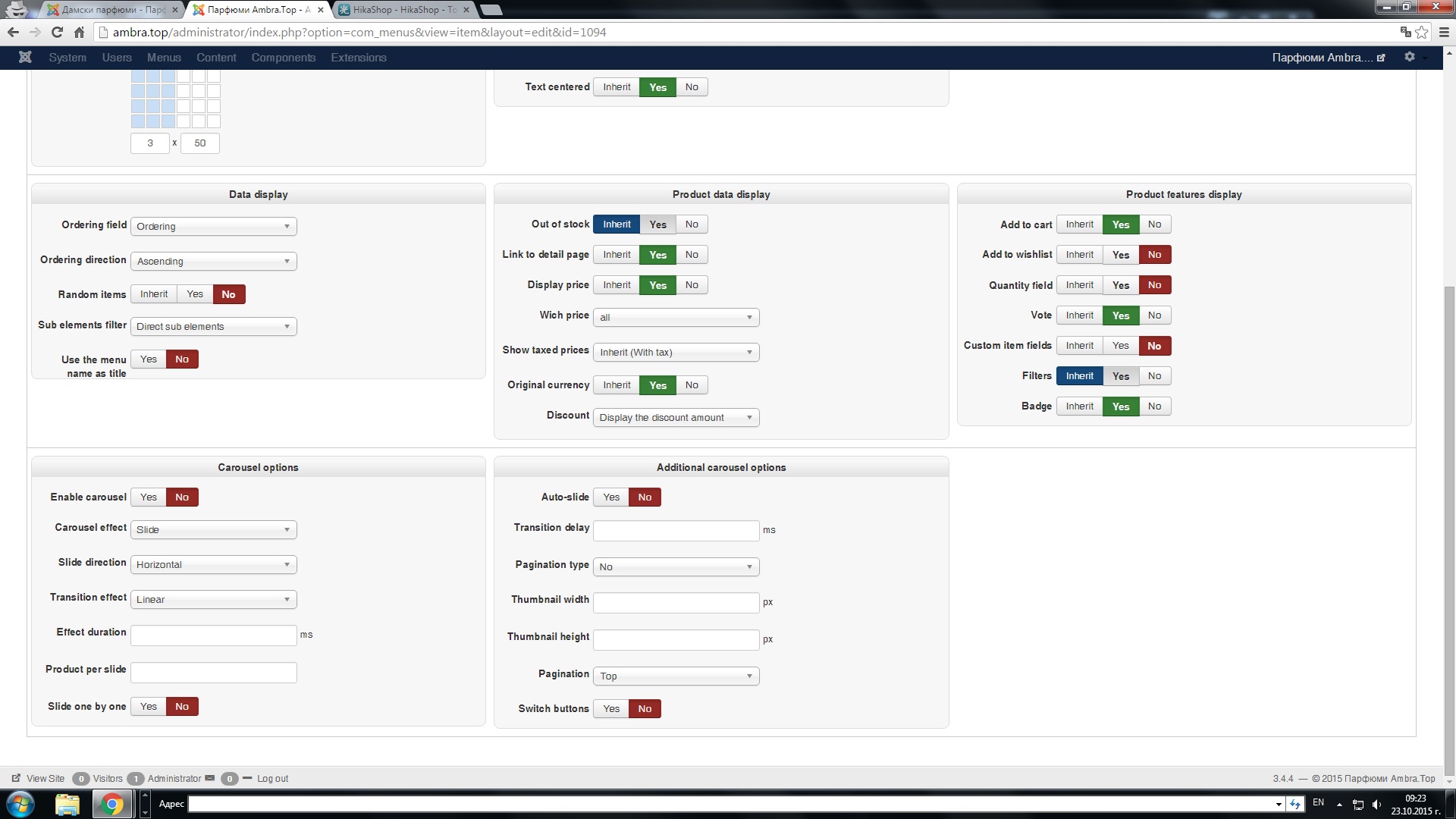

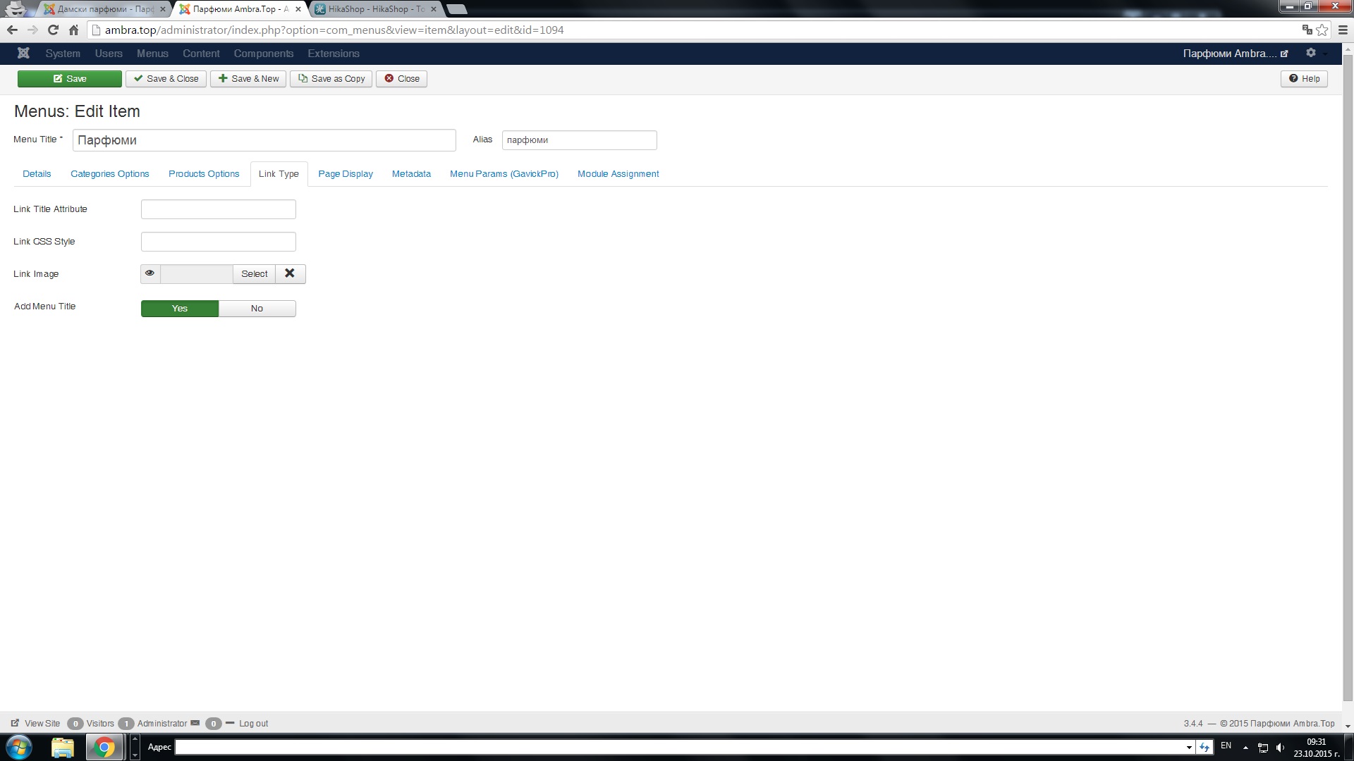

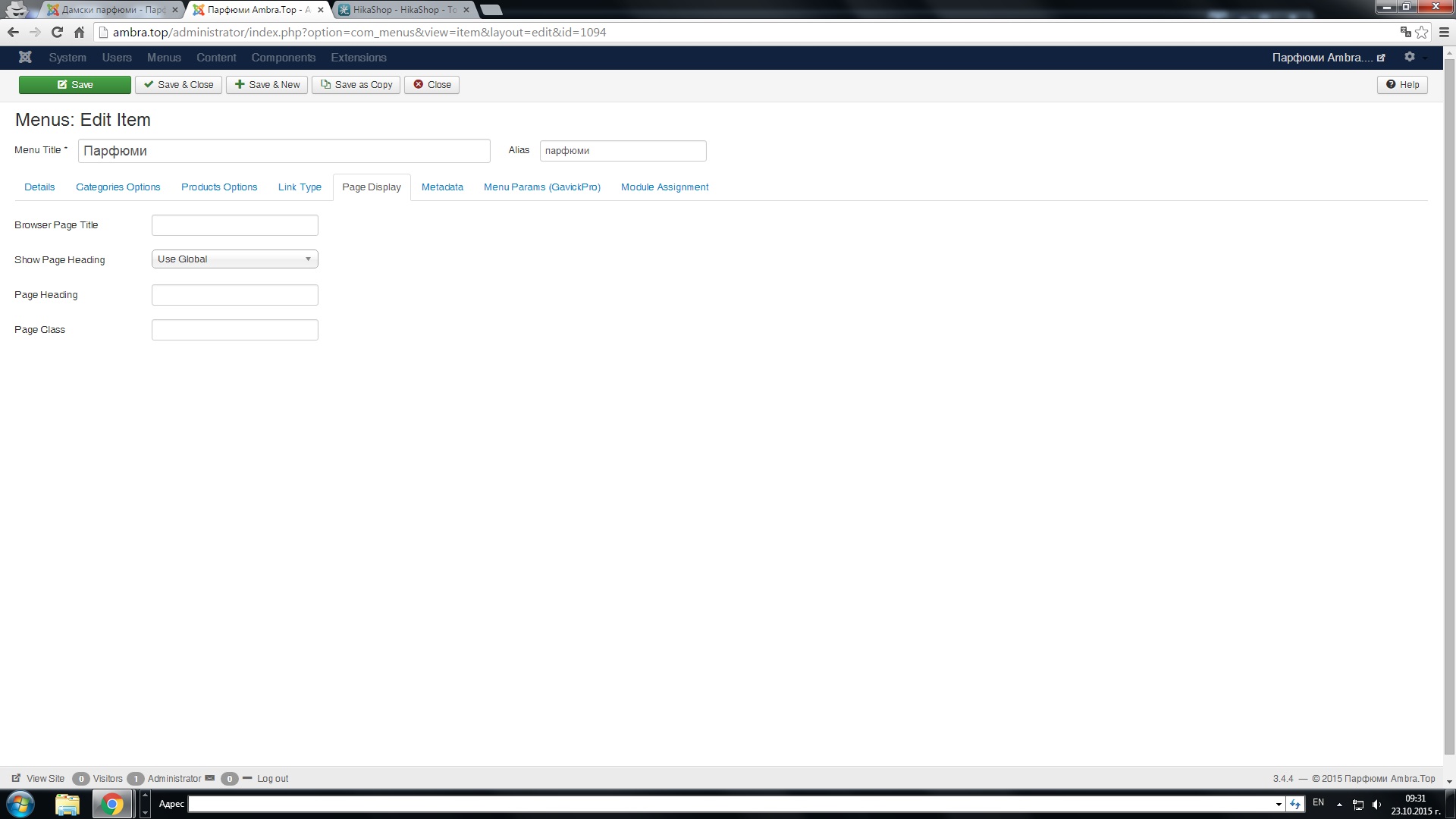

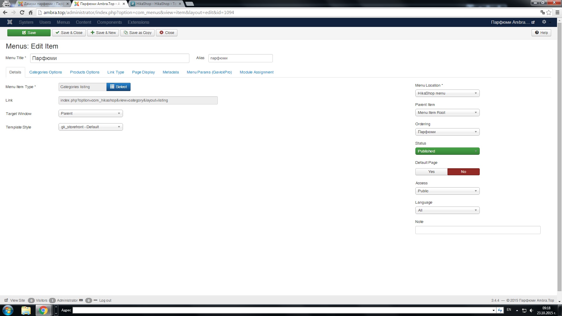

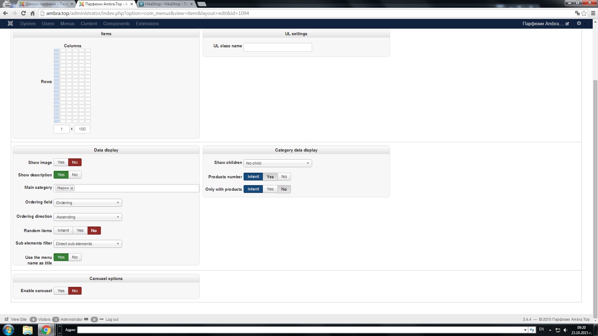

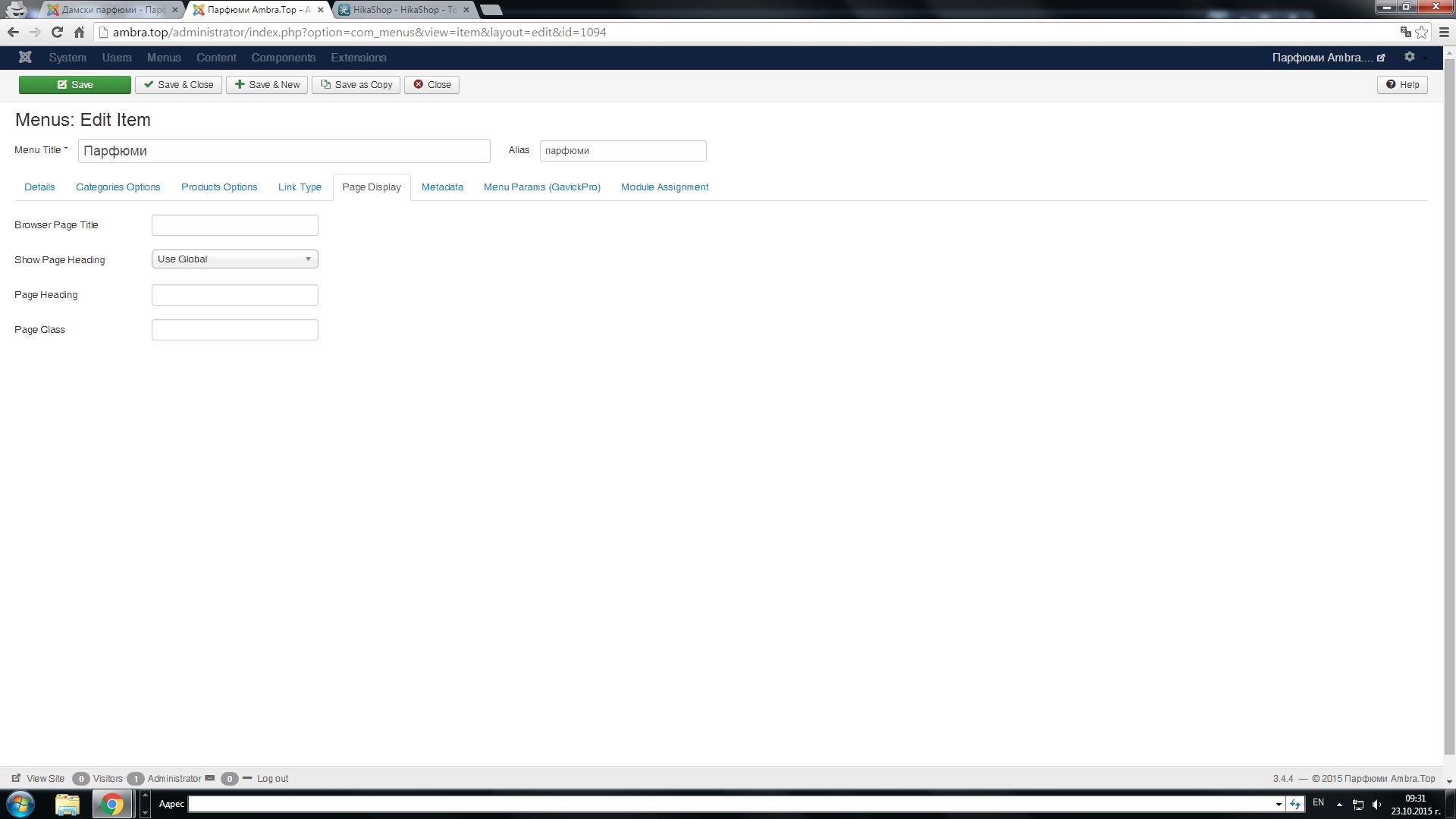

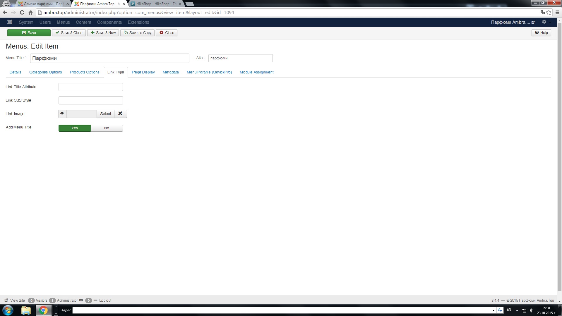

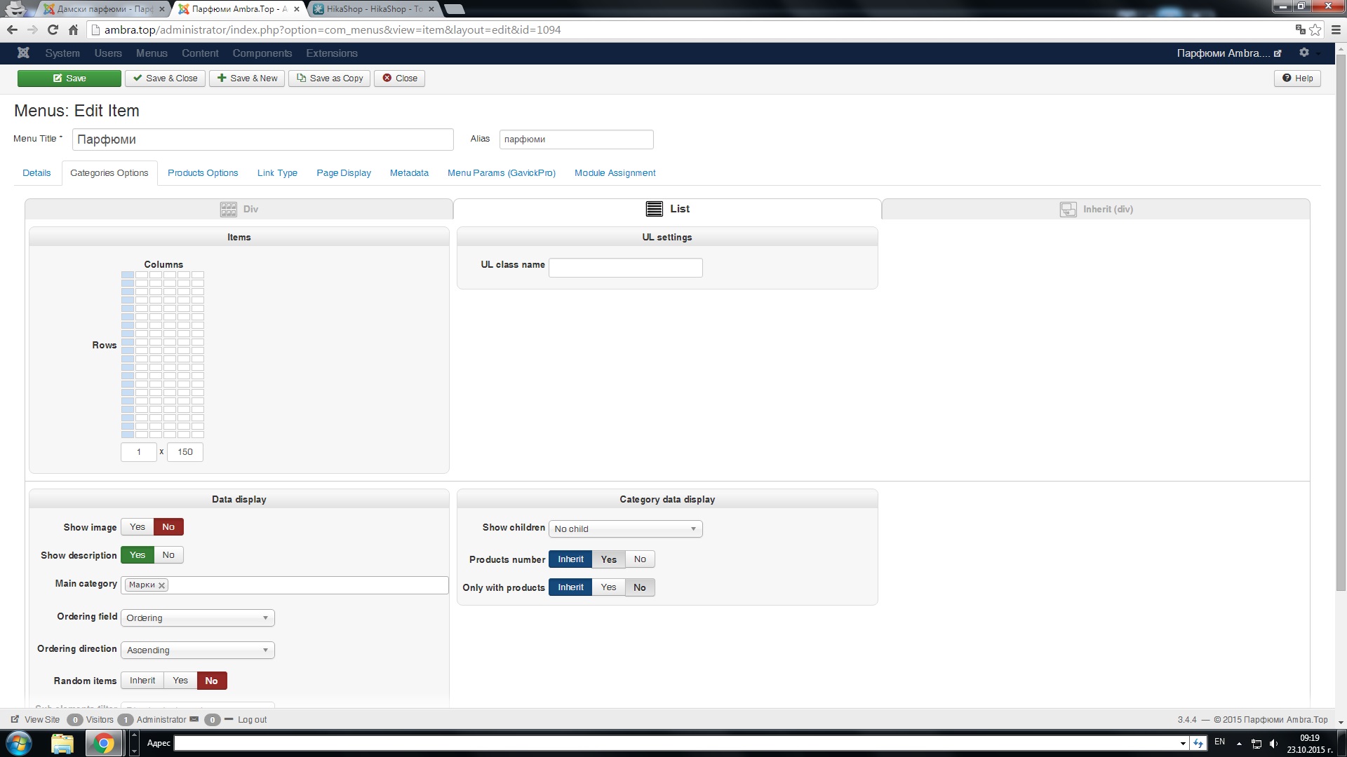

  • Posts: 43
10 years 10 months ago #218161

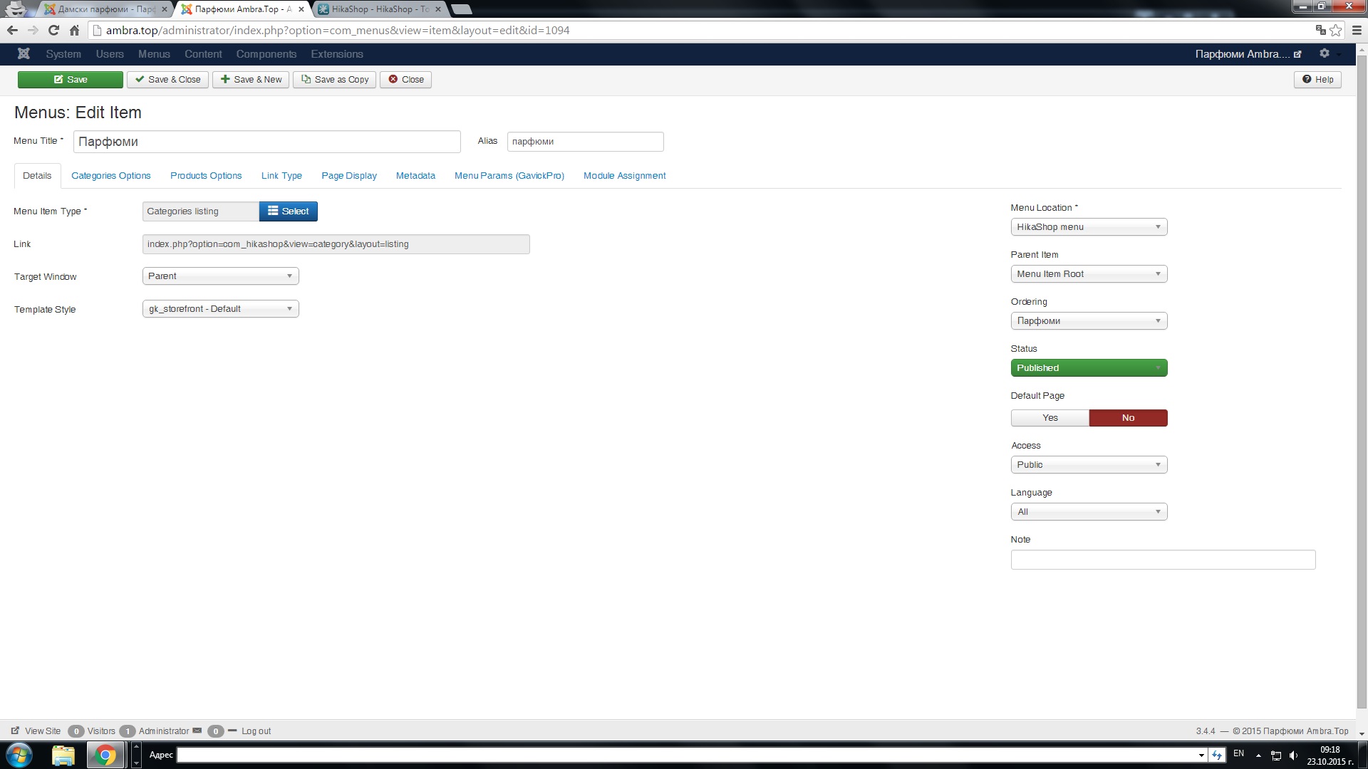

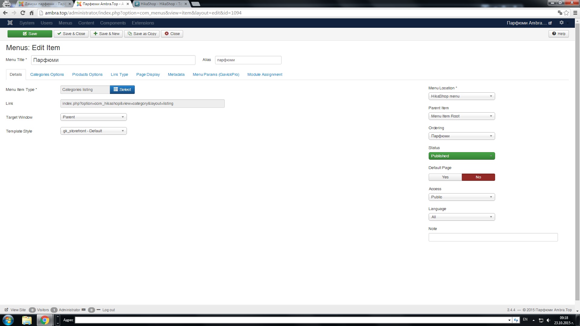

Hi ,

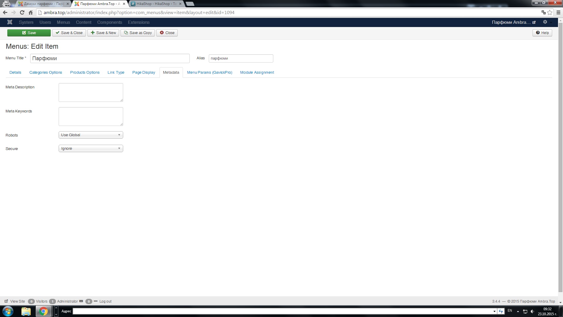

screenshots of the menu "парфюми" :

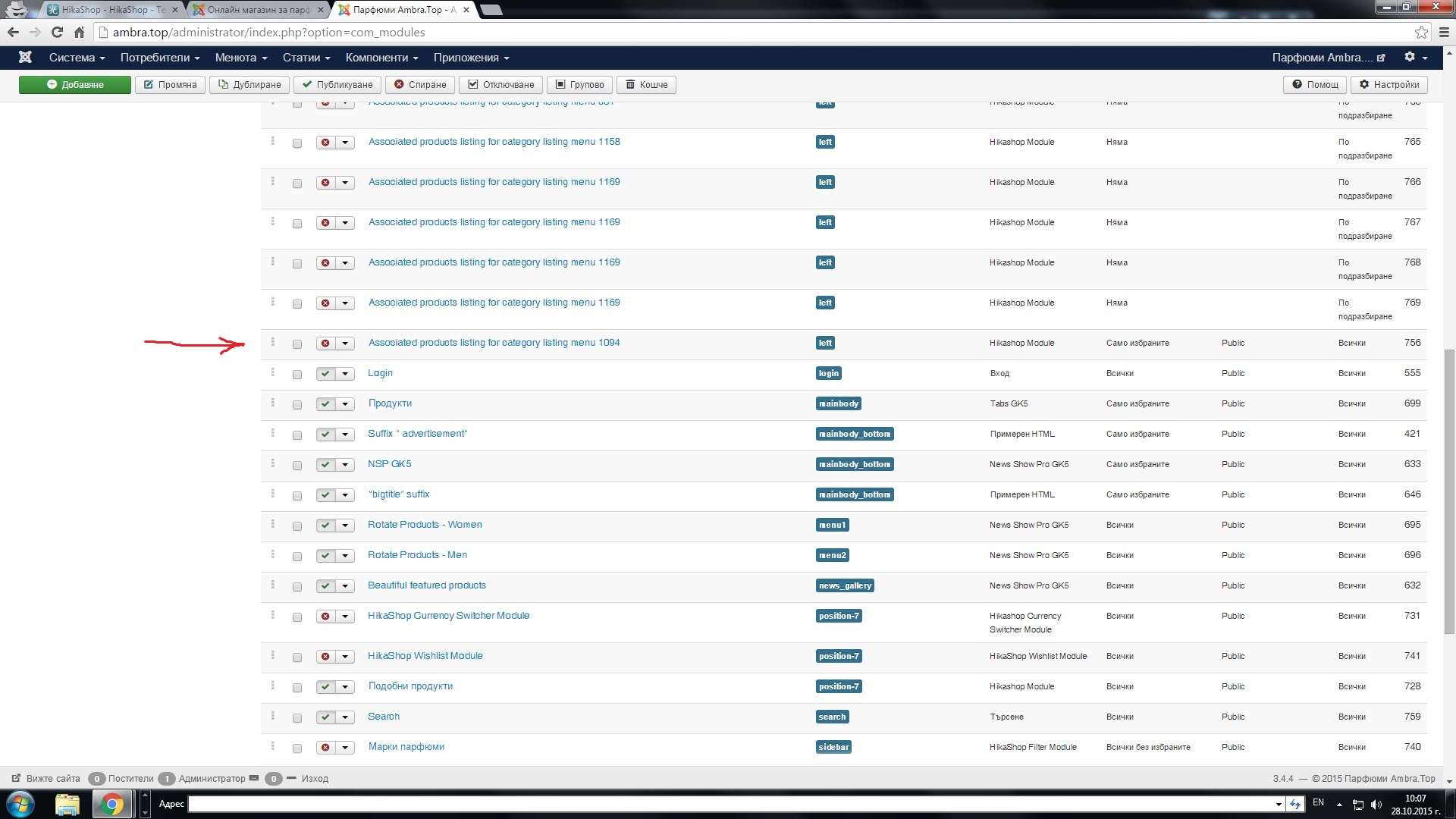

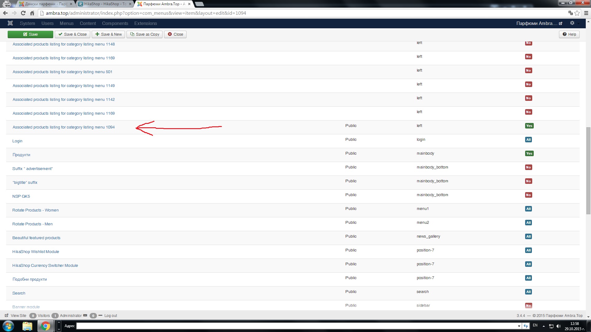

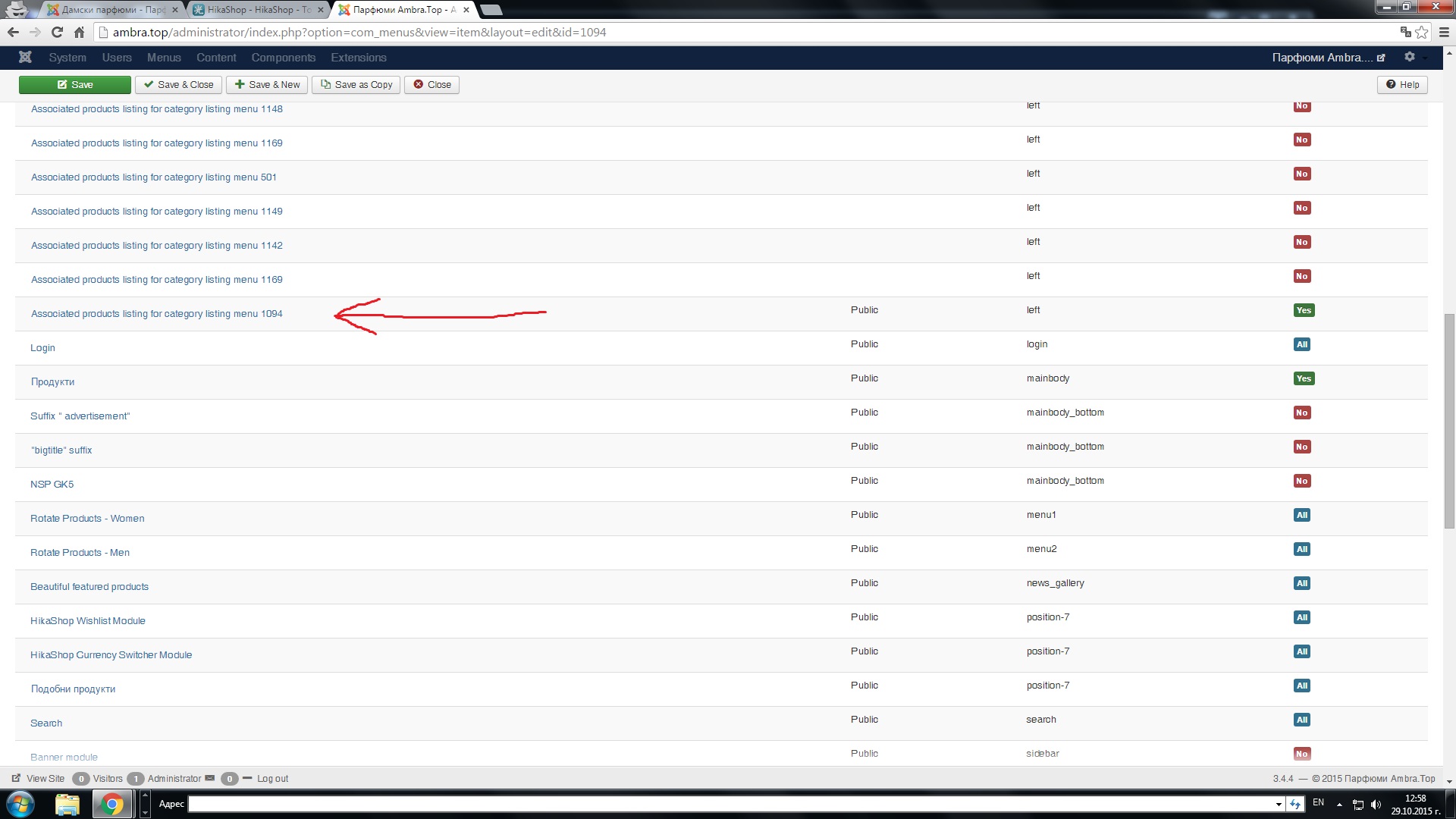

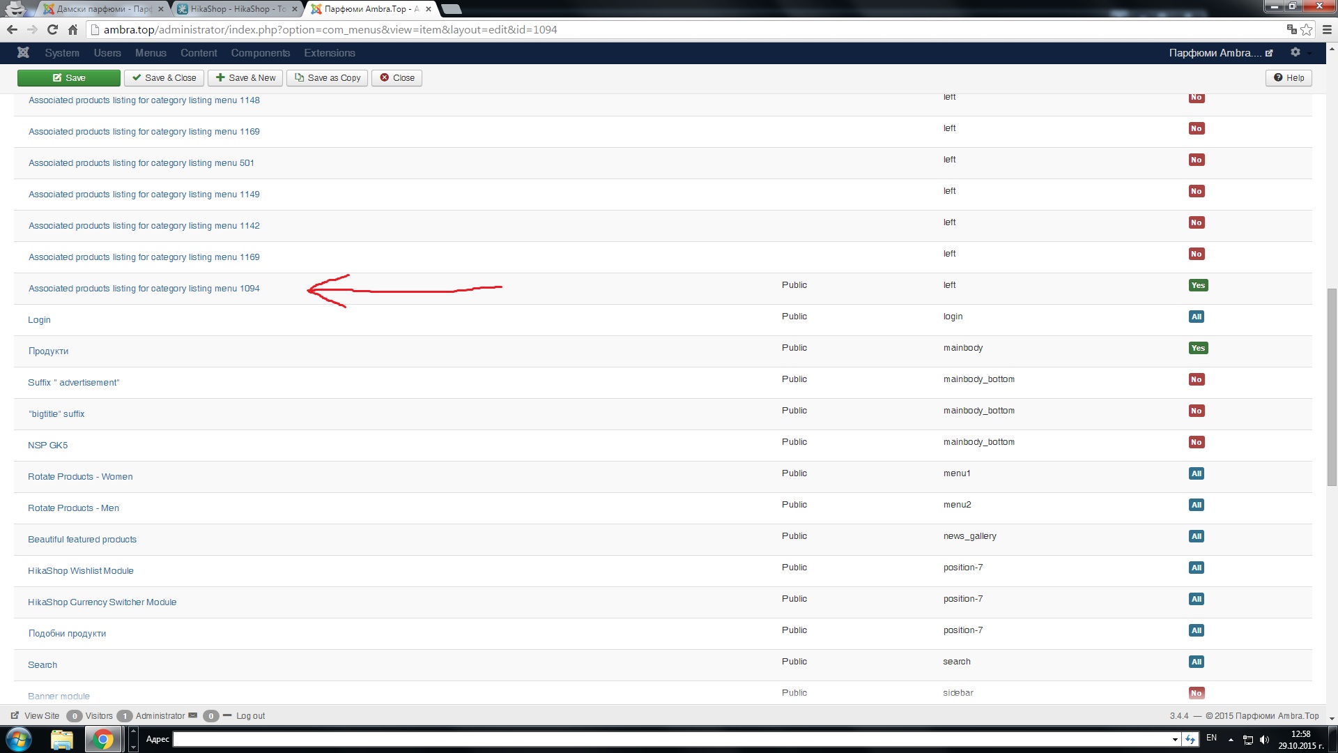

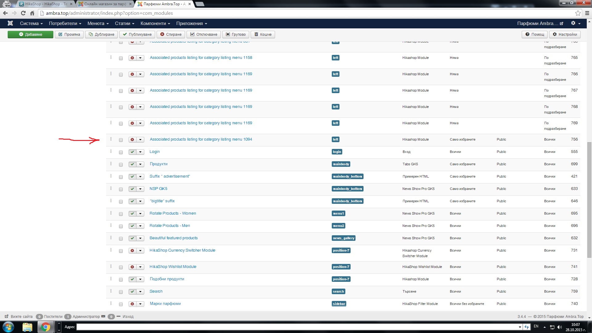

10 years 10 months ago #218168
As you can see there: take.ms/XPgEA the page is using the module with the id "756" and not the menu with the id "1094".
So you have to check the settings of that module, or see to use a menu instead of that module for this page.
The following user(s) said Thank You: eduarddimitrov

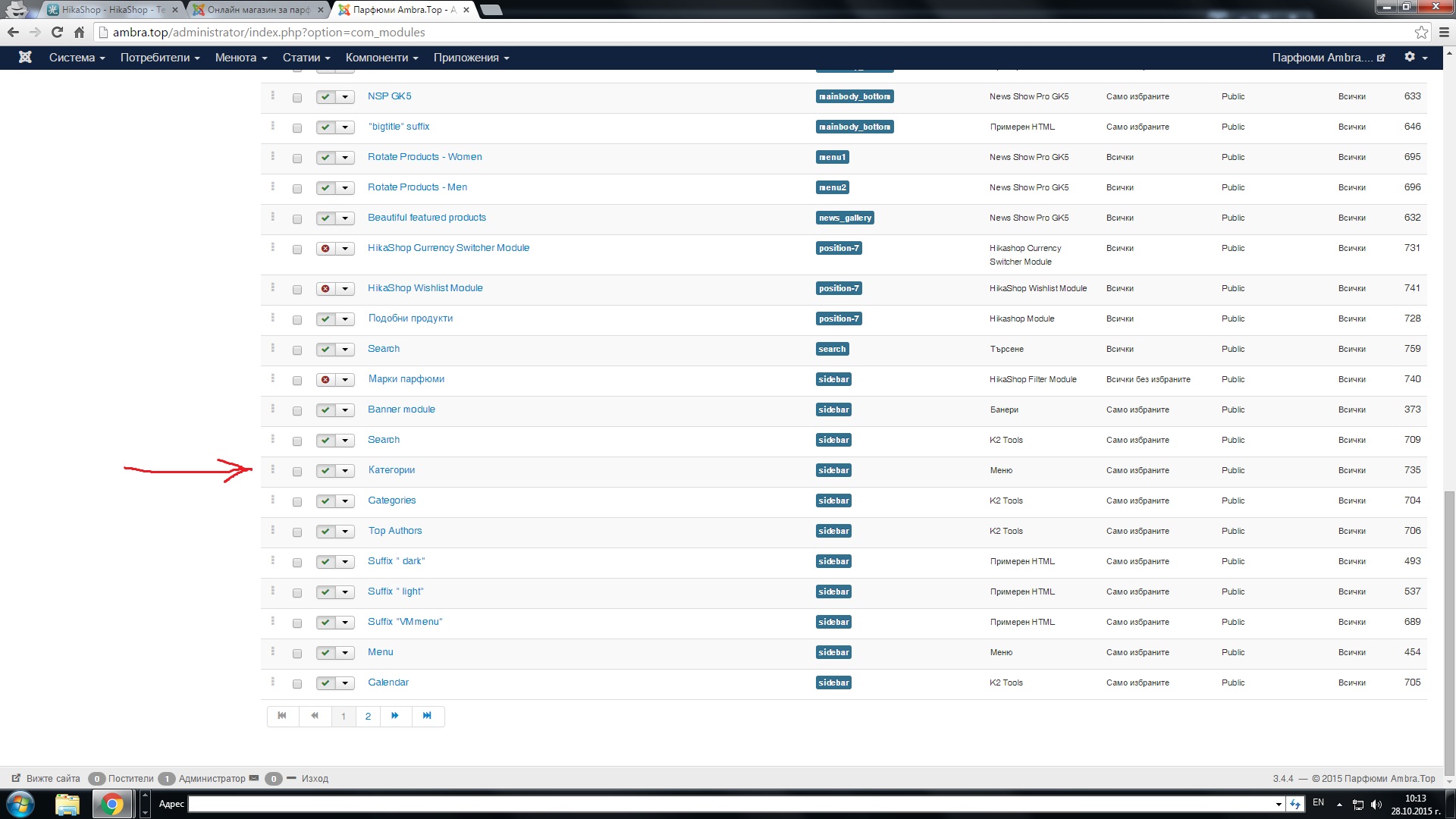

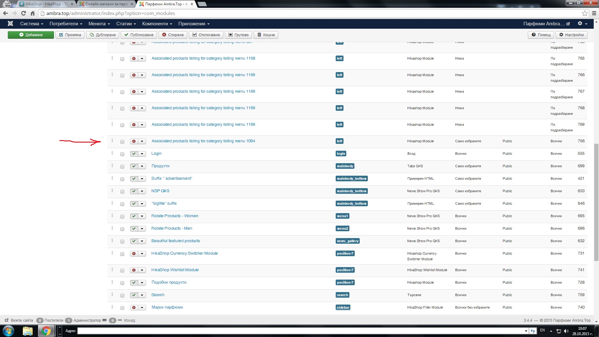

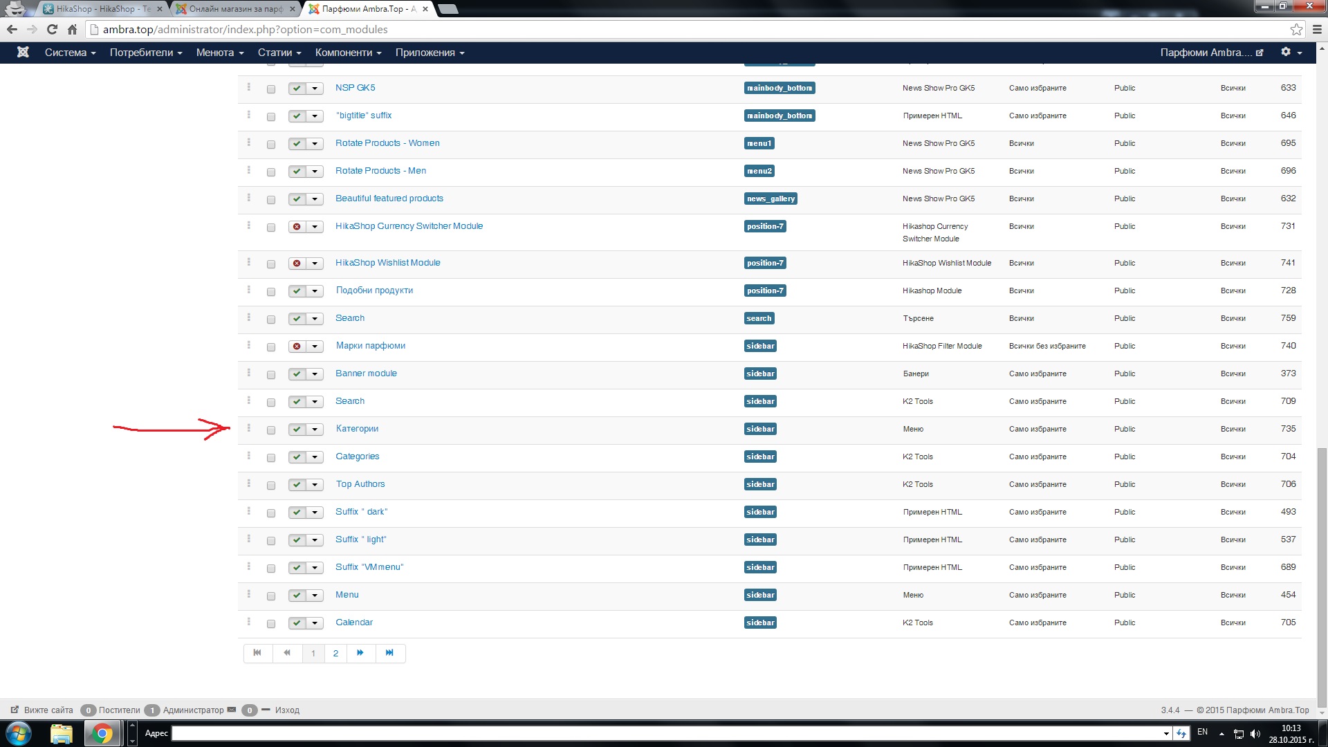

  • Posts: 43
10 years 10 months ago #218672
HI ,
module ID 756 is stopped
Used module ID 735
I will ask for a detailed description of what must be done.
thanks in advance

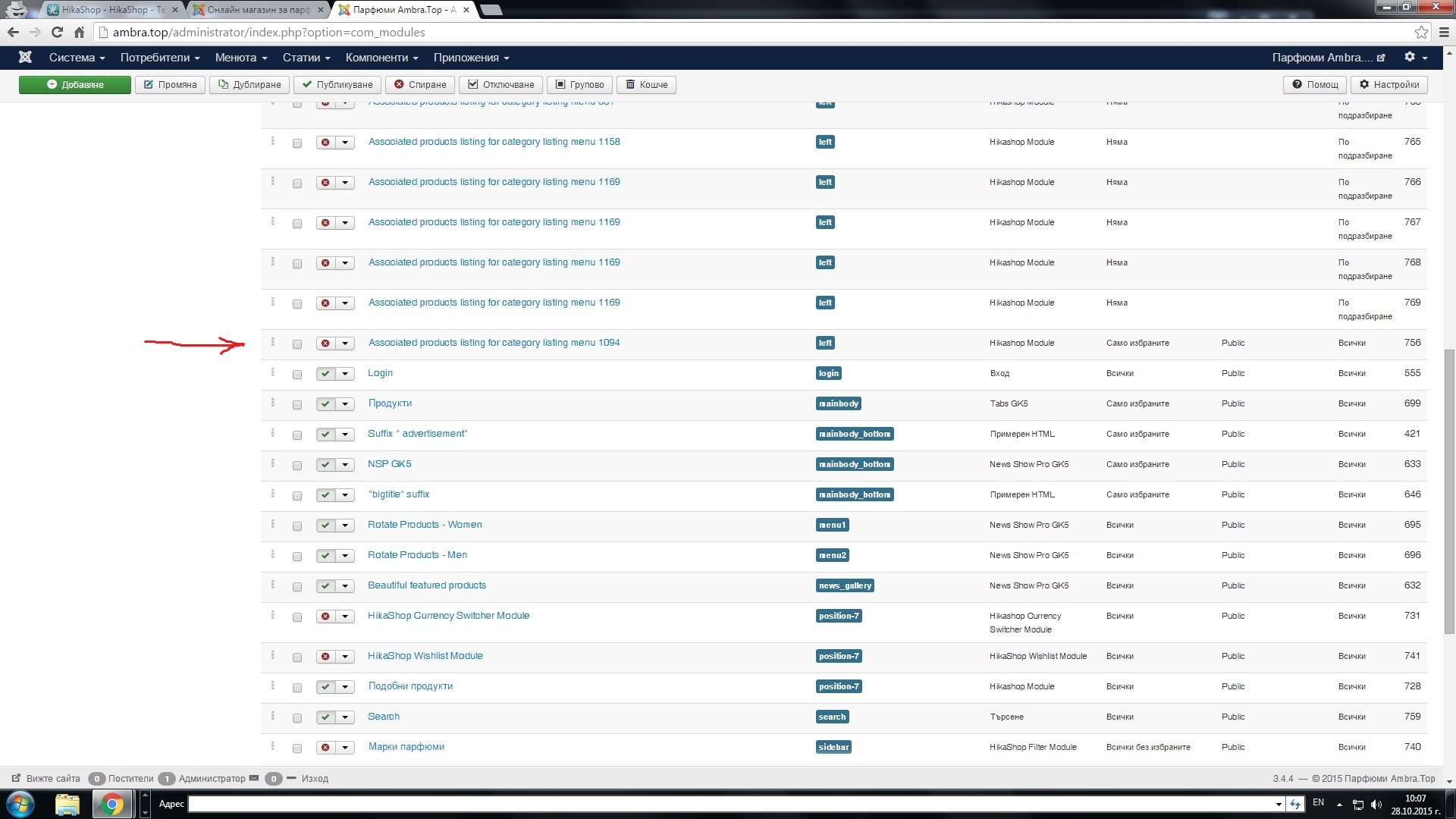

10 years 10 months ago #218694
I confirm that the used module is the one with the id "756" so you have to edit its settings.
This menu is unpublished because it is the way the system was working previously, when having a category listing menu, we were adding a product listing to that menu in order to have the products displayed.
Now with the new interface, there is no more creation of associated modules, but to use the menus settings, you have to edit it in Joomla and save it (even if no options have changed). That way it will use the new menu settings.

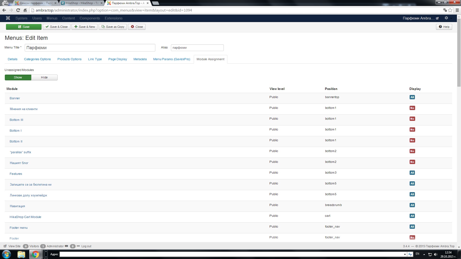

Should I be associated in this way :
and should it stopped this module :
What should be done step by step
Thanks in advance for answers.

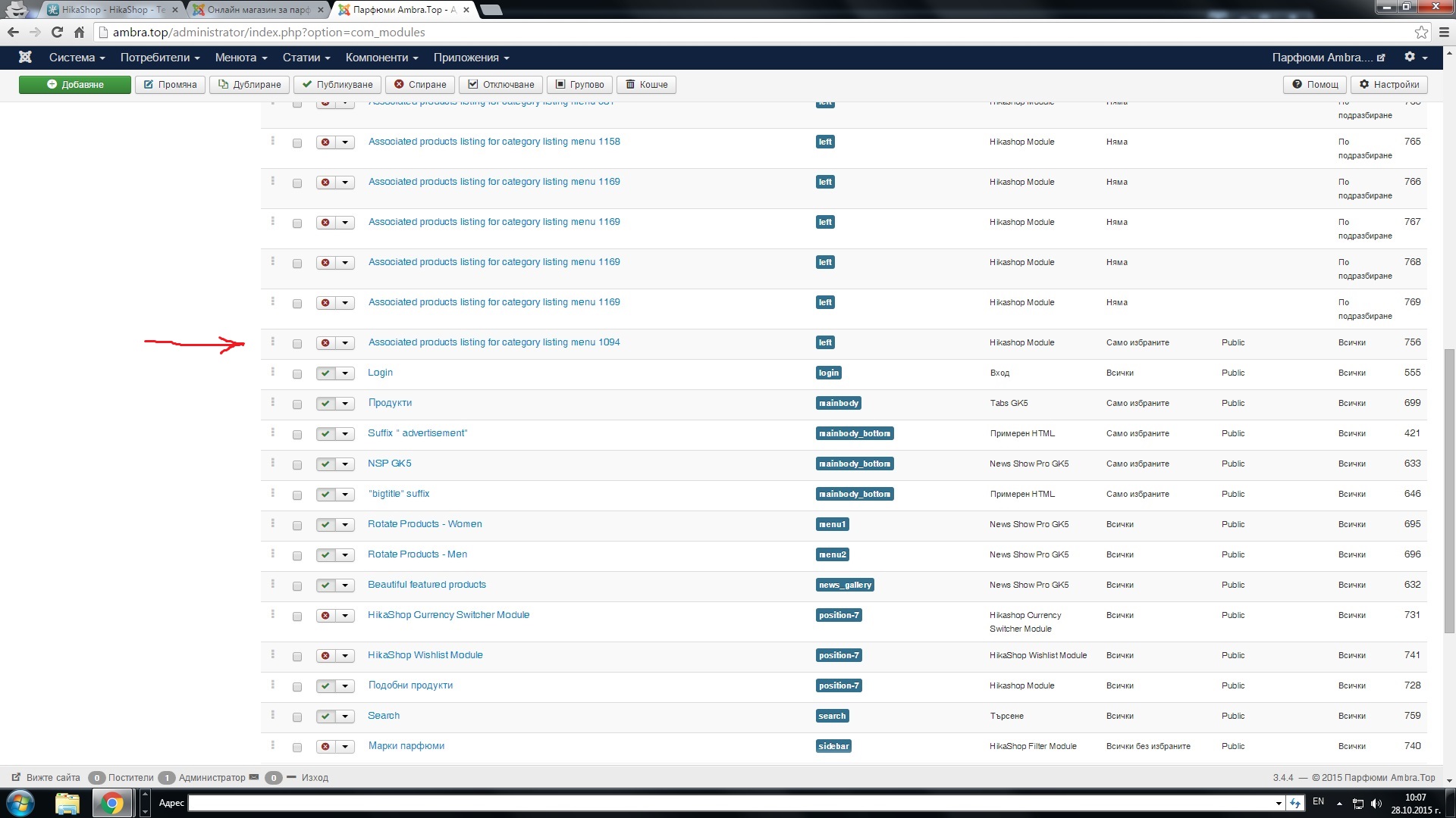

10 years 9 months ago #220716
I guess that you have created the "Парфюми" menu item in the "Main menu" menu recently, as you already had a menu with the alias "Парфюми" you were not able to use this new menu as default menu.
So on the frontend it was still using the old menu settings so the associated module "756" settings for the product listing.
I tried to edit the settings for that module, the products are displayed correctly.
Then I went to the new menu page (frontend), and everything was displayed correctly too.
Finally what I have do was to rename the old menu alias "Парфюми" to "_Парфюми" and set the new menu alias to "Парфюми". That way it is using the menu "Парфюми" in "Main menu" settings for the product listing. (ID: 1158)
