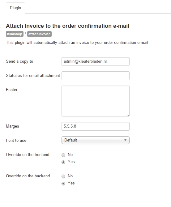

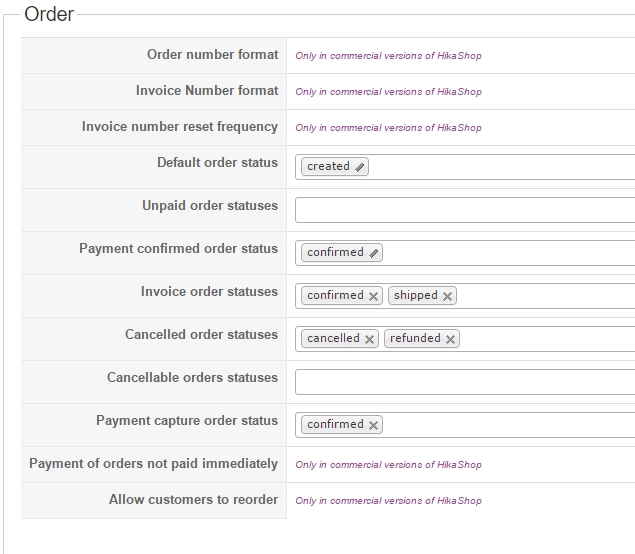

As asked I have attatched some screenshots.

Your settings look fine, so I can only think of the orders not being confirmed, or the plugin not activated or its access being restricted, or something like that.

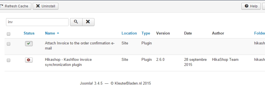

BTW: I noticed something weird in the Extension-list. All extension have dates and authers named, but notthe PDF plugin (see screenshot).
