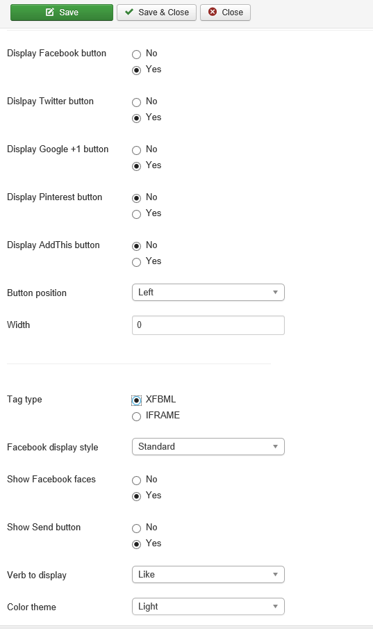

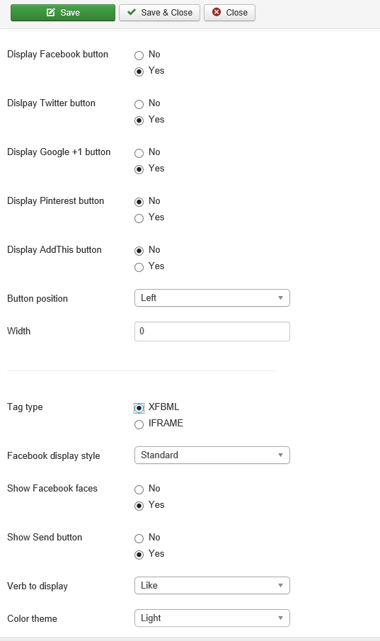

So I have been trying to configure social plugin for few hours. Can't get it right...
What I want is to have 2 buttons. Like and share. Or 1 button "like" which would share on facebook wall....
Right now if I select "tag type > IFRAME" only like button is displayed. Would be ok but if press like > share, it wont share on facebook wall. I mean friends will see that I liked but it won't be displayed on facebook wall...This not what I want....

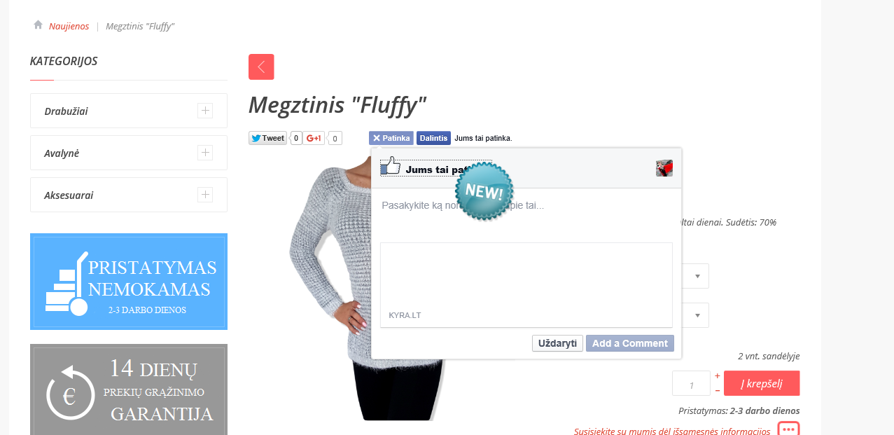

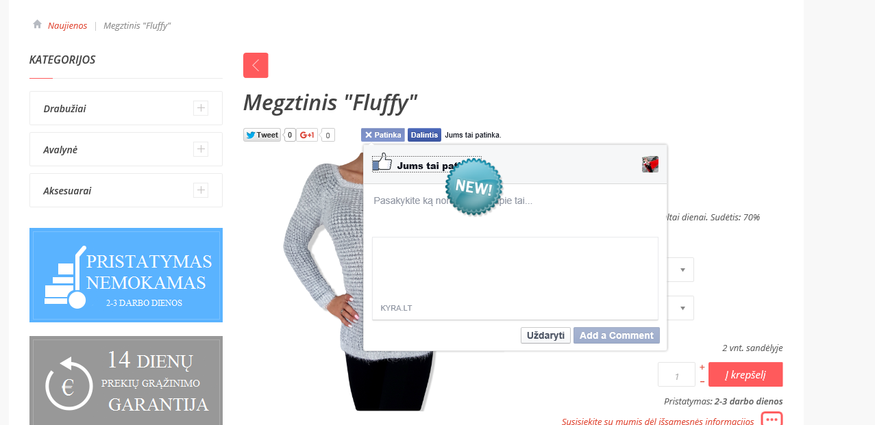

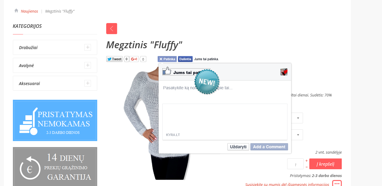

If I select "tag type > XFBML" I have 2 buttons like and share. Share works as it should, it gets displayed on facebook wall. However if you have badge on top right side. Pressing like > tab gets displayed with badge up on it. Please check attached picture. Seems not right?
So my question is how to have one button "like" which would share on facebook wall or how to hide that tab If XFBML is used? Or how to fix that badge thing?

10 years 10 months ago #218663
From my point of view, just fixing the overlay of the badge with a line of CSS will be easier than trying to modify the code of the plugin to do things it's not supposed to do.
Could you give a link to the page with that overlay issue so that we could have a look at the CSS ?
  • Posts: 1119
  • Thank you received: 114
10 years 10 months ago #218702
You can find it here: kyra.lt/megztiniai/megztinis-fluffy-pilka
Maybe there is a simple code/way to have tab not displayed on LIKE button? I mean simple like and that's all.
Last edit: 10 years 10 months ago by kyratn.
  • Posts: 86104
  • Thank you received: 14203
10 years 10 months ago #218726
This CSS should solve that problem:
.hikashop_badge_topright_div{ z-index: auto !important; }
  • Posts: 1119
10 years 10 months ago #218775
Thanks, it worked!

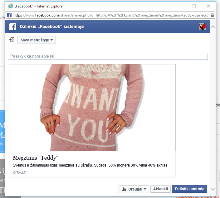

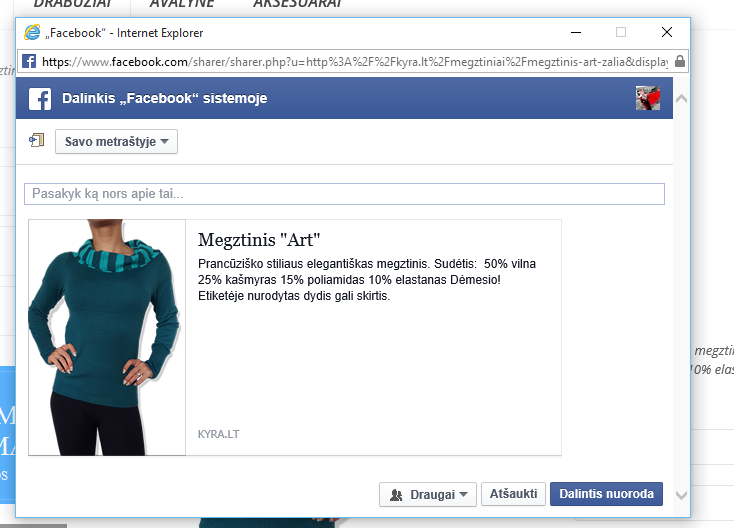

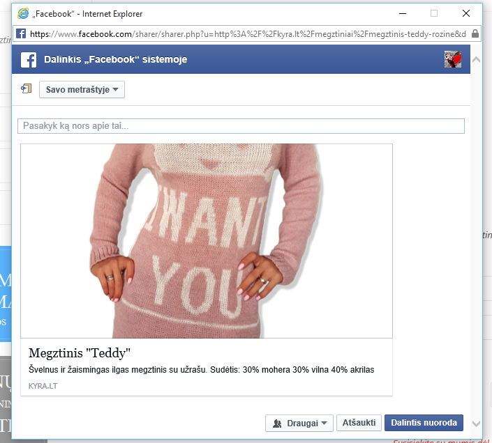

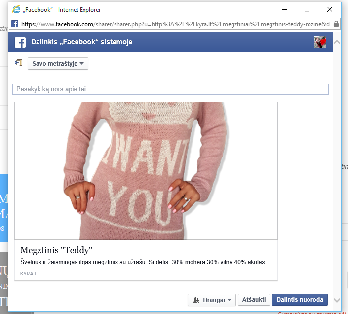

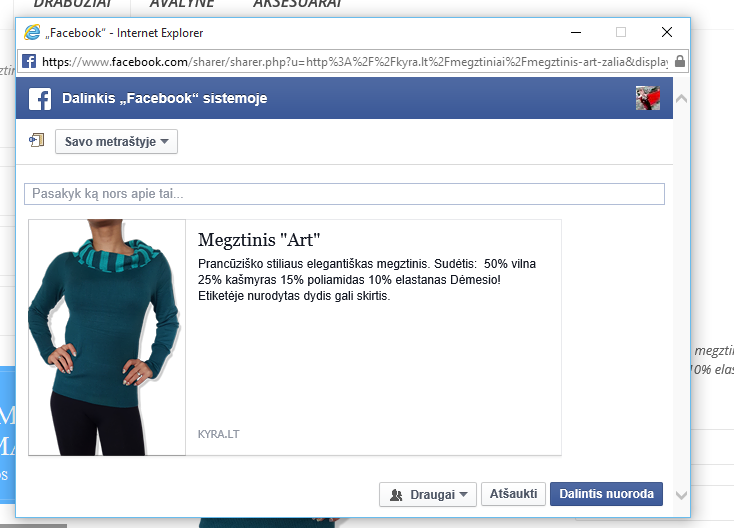

Could anyone tell me what is the reason that on some of the items are I receive different facebook share layout?
Please check attached pictures. I would like to have like in the first picture always...
  • Posts: 86104
10 years 10 months ago #219061
I suppose that facebook automatically adapts the layout based on the width/height ratio of the image of the product so that it looks as nice as possible.
