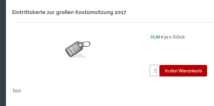

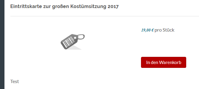

1. that confuses me
when i select on the product settingpage "inherited" and on generell settings the "Display of the amount field on the product page" to "Ajax-input" - i have only the button "add to cart" but no field for + / - (see attached picture 1.png)
when i select on generell settings the "Display of the amount field on the product page" to "normal" i only have a field with a "1". i can change the number manually by edit the field number. (see attached picture 2.png)

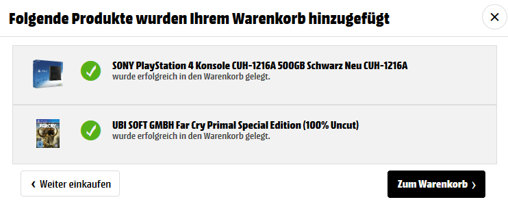

1.1 next question is. when i press on "add to card" how can i get a popup like picture 3.png

10 years 6 months ago #231740
Hello Mike,
1. To do what you want you should set the :
- "Display the quantity field on the product page" option to Ajax input
- "Quantity layout on product page" option to Default
1.1 You'll just have to set the "After a product is added to the cart" option to "Stay and display a popup notice" via "Hikashop->System->Configuration->Main".
